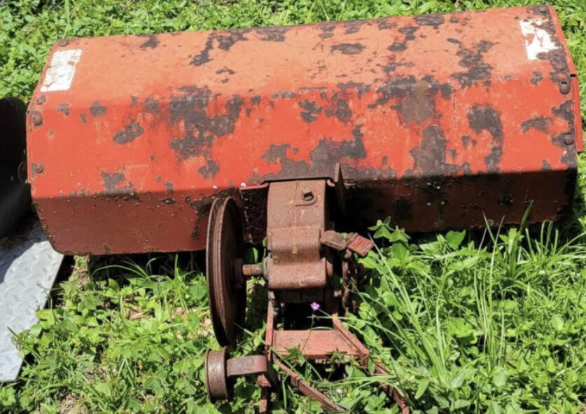

FLtractor 50 #1 Posted July 19 Browsing marketplace, seller has a Wheelhorse for sale and this in one of photos. Anyone happen to know what it is from this one backside photo? Share this post Link to post Share on other sites

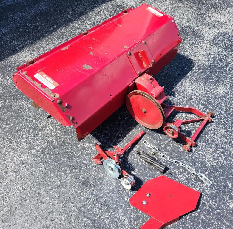

Brockport Bill 1,933 #5 Posted July 19 if you buy the tractor and get the teiller be sure to ask if the person has the necessary other pieces that go with it? Spring, chain and front pto idler pulley unit, and it's safety guard? 2 Share this post Link to post Share on other sites

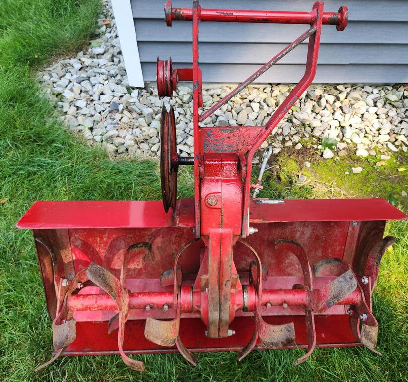

gwest_ca-(File Mod) 11,454 #7 Posted July 19 This is the tiller sold for the 856. Problem with using the larger and later tiller is the 856 ground speed is too fast. You run at low rpm for a good ground speed and the belt driven tiller is not turning fast enough. They did have a speed reducer kit but that would be a challenge to find and add to the 856. Share this post Link to post Share on other sites
FLtractor 50 #8 Posted July 19 15 minutes ago, gwest_ca said: This is the tiller sold for the 856. Problem with using the larger and later tiller is the 856 ground speed is too fast. You run at low rpm for a good ground speed and the belt driven tiller is not turning fast enough. They did have a speed reducer kit but that would be a challenge to find and add to the 856. Oh ok most interesting. Thank you Share this post Link to post Share on other sites
Brockport Bill 1,933 #9 Posted July 19 be mindful if the tiller they have is NOT compatible with the tractor --- and you can purchase for modest price ( assuming its in operational condition ) it does have resale value -- your choice? 1 Share this post Link to post Share on other sites
Lane Ranger 11,395 #10 Posted July 19 One of the best implements Wheel Horse made and sold! Share this post Link to post Share on other sites
