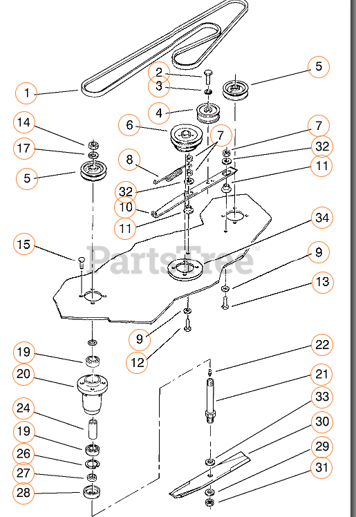

ANTPER 208 #1 Posted July 19 Hello I removed a pulley and center spindle. Upon putting back together with top nut fully tightened my pulley rests up against spindle mount bolts of spindle and wont turn. Did I lose a washer or o ring that may be needed between the pulley and spindle body? The parts diagram I have really doesn't give me a clear view. I'm leaning towards an o ring I may have lost upon tapping shaft through pulley. TIA Anthony Share this post Link to post Share on other sites
davem1111 2,198 #2 Posted July 19 First, it sounds like you may have lost a washer or spacer, but what I'm looking at right now doesn't seem to show one. Second, there are at least 2 different designs of these, one with a keyed slot and the other without, and they could be different as far as pulley design, spacers, etc. Also, any possibility that you have the pulley upside-down on re-assembly? Not sure if this is helpful at all - this looks like the non-slotted style: I can't look right now but I have a full set of these (the slotted kind) in my garage that are not installed in a deck yet and I could look later this morning and take a picture. I also have a deck that has the non-slotted style installed, which I need to remove and replace but the pulleys are giving me a lot of resistance to take off... 1 Share this post Link to post Share on other sites
ANTPER 208 #3 Posted July 19 2 hours ago, davem1111 said: First, it sounds like you may have lost a washer or spacer, but what I'm looking at right now doesn't seem to show one. Second, there are at least 2 different designs of these, one with a keyed slot and the other without, and they could be different as far as pulley design, spacers, etc. Also, any possibility that you have the pulley upside-down on re-assembly? Not sure if this is helpful at all - this looks like the non-slotted style: I can't look right now but I have a full set of these (the slotted kind) in my garage that are not installed in a deck yet and I could look later this morning and take a picture. I also have a deck that has the non-slotted style installed, which I need to remove and replace but the pulleys are giving me a lot of resistance to take off... 2 hours ago, davem1111 said: First, it sounds like you may have lost a washer or spacer, but what I'm looking at right now doesn't seem to show one. Second, there are at least 2 different designs of these, one with a keyed slot and the other without, and they could be different as far as pulley design, spacers, etc. Also, any possibility that you have the pulley upside-down on re-assembly? Not sure if this is helpful at all - this looks like the non-slotted style: I can't look right now but I have a full set of these (the slotted kind) in my garage that are not installed in a deck yet and I could look later this morning and take a picture. I also have a deck that has the non-slotted style installed, which I need to remove and replace but the pulleys are giving me a lot of resistance to take off... Mine is keyless. I was able to tap down on spindle shaft and pulley slide off. Share this post Link to post Share on other sites
ANTPER 208 #4 Posted July 19 Mine is keyless. Shaft slide off by tapping down on shaft. I see #19 listed and above it shows a spacer or washer but diagram doesn't mention what it is. Share this post Link to post Share on other sites
oldlineman 1,567 #5 Posted July 19 # 19 is the bearing one of two per spindle 1 Share this post Link to post Share on other sites
ANTPER 208 #6 Posted July 19 2 hours ago, oldlineman said: # 19 is the bearing one of two per spindle Yes I understood that. But it shows some sort of washer or spacer of some sort above 19 but no description of what it is. I did find a spacer that is same diameter as spindle shaft and same width as pulley bushing riding against it. I installed it and it clears the mount bolts. Still have to install deck on to tractor and give it the test. 1 Share this post Link to post Share on other sites
