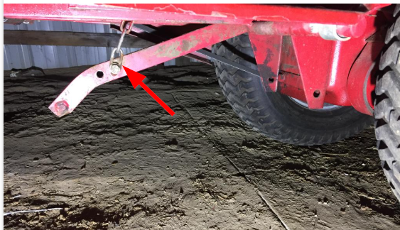

JCD 80 #1 Posted July 18 I've run into a strange problem, started up the 312-8 and went to mow but as I engaged the pto it started bogging down and would die if I kept pushing the pto lever forward. It doesn't die when the pto first engages, the belt turns and so do the blades but if I push it forward more than a couple of inches it kills the motor. No smell from the belt or any burned areas that I can see. I decided to try and drop the deck, haven't done it before, dropped the bar from the attach o matic but then it started to rain so I struggled to get the bar reattached, had to use 2 jacks to hold it in place while I locked it in. When I did that I noticed the belt seemed very loose so I tightened it up but the deck looked funny, the front was higher than the back, when I went to lift the deck it was apparent that something had become detached or broke because my lift arm is loose. I can see a chain moving up and down but it's not connected to anything anymore. Anyone know what has happened and how to fix what I messed up? Thanks, Jim Share this post Link to post Share on other sites

davem1111 2,253 #3 Posted July 18 Assuming you were in the seat and the seat switch was engaged, as Wallfish stated might be the problem, it sounds to me like your lift arm became detached from the chain that goes up to the rocker arm, and possibly dropped down to interfere with the turning of the center pulley. I guess if your PTO clutch is good and your belt isn't slipping, that could be enough drag to bog down the engine. Let's see what the experts here say - I'm not one of them 1 Share this post Link to post Share on other sites
gwest_ca-(File Mod) 11,838 #4 Posted July 18 Make sure you get the correct wiring diagram. Let us know if you need help. The ignition systems used on the 312-8 changed and improper testing can release the magic smoke in the wiring. When attaching a mower to the tractor there is a forked tab that must be installed correctly at the mid-hitch for everything else to fit. The mower deck operator manual will have this illustrated. 3 Share this post Link to post Share on other sites
