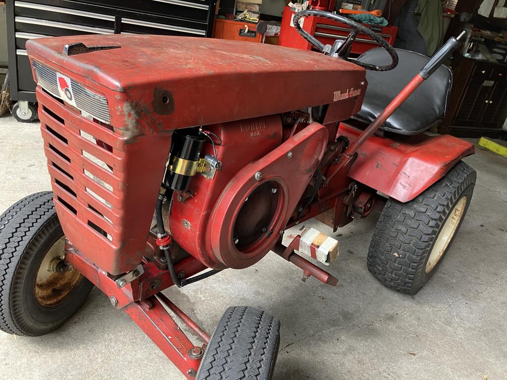

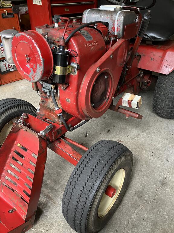

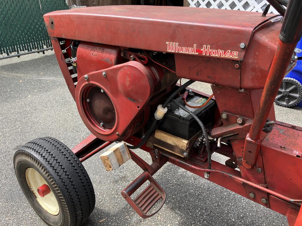

Retired Wrencher 6,537 #1 Posted July 17, 2025 Well, I’m almost done with this one been working on this four a few years now it was very rough when I got it, but slowly I’m going through it. All I have now is the throttle control is not working, but Walfish straighten me out on that. I will reset everything again tomorrow And I even got the belt to work now. I just think I had to be run for a while. It was kinda tight when I put it on there, but I had to put a 2 x 4 on the clutch brake works good now as a belt wears in I should be able to ajust everything where I don’t need the block anymore at least it works. She’s not pretty, but good enough to beat around the yard and take it up the street with a cold one. Hope you enjoy the pictures and the one video. IMG_0596.mov 4 6 1 Share this post Link to post Share on other sites

Retired Wrencher 6,537 #5 Posted July 18, 2025 16 hours ago, Sparky said: Is that with the new motor from Stevebo? Yes it is Mike. Runs pretty good. It was bored 30 over at one time. This one has come a long way from the day I picked it up it up. Share this post Link to post Share on other sites

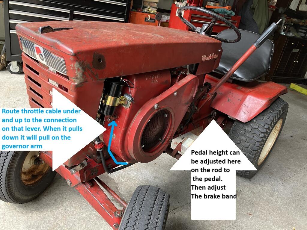

Retired Wrencher 6,537 #6 Posted July 18, 2025 12 hours ago, wallfish said: Nice Gary Thanks John I will try what you said yesterday post. The break is adjusted pretty far out. And the brake pad is worn. I use spacers to take up the slack. This not used every day. Share this post Link to post Share on other sites

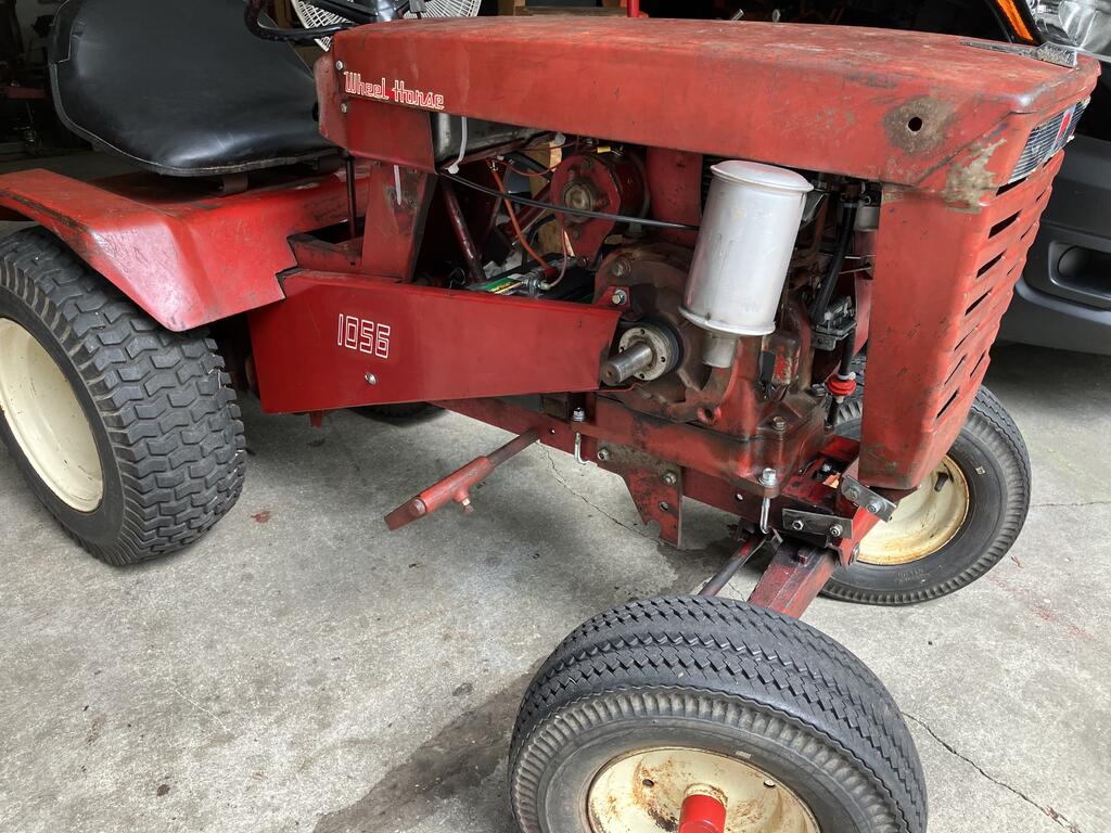

Retired Wrencher 6,537 #7 Posted July 18, 2025 13 hours ago, ebinmaine said: Looks good ! Thanks Eric. It is getting there. Summer tractor. But maybe a winter tractor? Not sure yet. I have to finish up the 1057 first. That one is in good shape. Share this post Link to post Share on other sites
