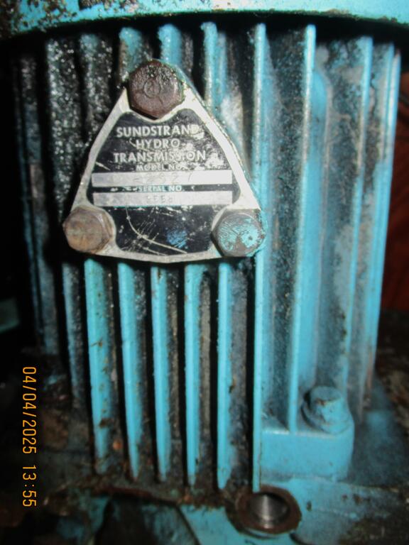

donaldjd 0 #1 Posted July 11, 2025 Sundstrand Model 90- 2027 Serial FA 9558. I need SEAl kit and /or parts number seal numbers Especially for Output shaft Share this post Link to post Share on other sites
pfrederi 20,837 #2 Posted July 11, 2025 (edited) Don't recognize the model number. What WH is the unit on? The Sunstrands used in Wheelamatic...Chargers...D series and early C series all use CR 7474 or 7475 on the input shaft.. I prefer the 7475 as it is double lipped. Edited July 11, 2025 by pfrederi Share this post Link to post Share on other sites
oliver2-44 11,611 #3 Posted July 11, 2025 2 hours ago, pfrederi said: Don't recognize the model number. What WH is the unit on? Considering the turquoise paint is this on a Panzer, Meteor? @donaldjd Let us know the model and year of the tractor. That might help cross reference information. Share this post Link to post Share on other sites
