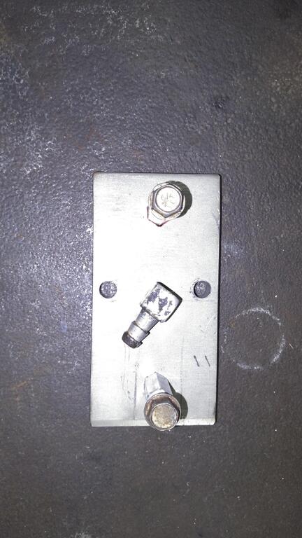

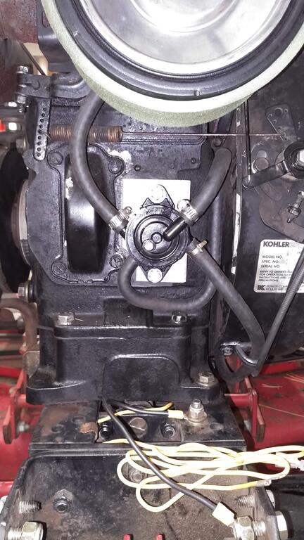

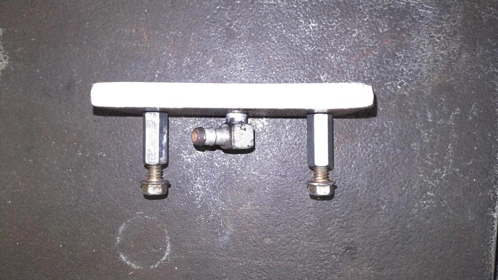

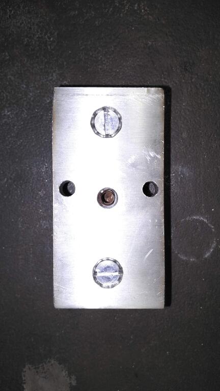

Bill D 2,595 #2 Posted July 8, 2025 (edited) 3 hours ago, bo dawg said: I bought the Carbole electric fuel pump a while back to put on my SK486 but never got around to it. So now the mechanical pump quit working. I went to get it out and installing it to find out its 5/16" nipples. And everything on these tractors are 1/4" gas lines and fittings. Question is can you still you it with some kind of reducers to fit 1/4" lines? Ive never used one before. Also if buying a replacement mechanical pump what is everyong using? Ebay and Amazon has tons of cheap looking plastic ones at different prices. Thanks Bo I started using vacuum pulse pumps on Kohlers whenever ever the mechanical pump fails. I make up these mounting plates. Easy to make if you have a drill press. Use a quality OEM pump. Kawasaki PN 49040-0803 is my go to for this application. Pump is made in Japan by Mikuni who makes most OEM pumps for Briggs, Kawasaki and Kohler. Edited July 8, 2025 by Bill D 2 1 Share this post Link to post Share on other sites

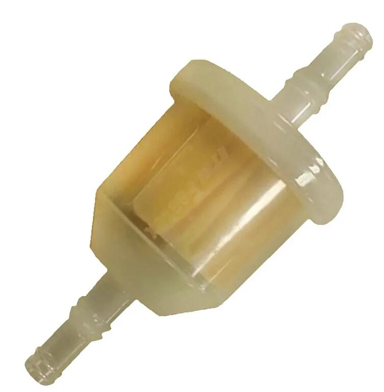

kpinnc 17,149 #3 Posted July 8, 2025 (edited) 4 hours ago, bo dawg said: Question is can you still you it with some kind of reducers to fit 1/4" lines? Ive never used one before. Most inline fuel filters have both 1/4 and 5/16 sized barbs. You just trim the 1/4 off on one side. Might be a good spot to "step down" to 1/4 if needed. Carbole pumps seem to be pretty decent. I've been using one for a couple years with no issues. 33 minutes ago, Bill D said: started using vacuum pulse pumps on Kohlers whenever ever the mechanical pump fails. One day I'm gonna try this. Next Kohler that needs one will get this mod. Very nicely done! Edited July 8, 2025 by kpinnc 1 Share this post Link to post Share on other sites
