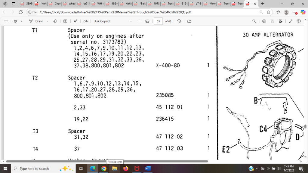

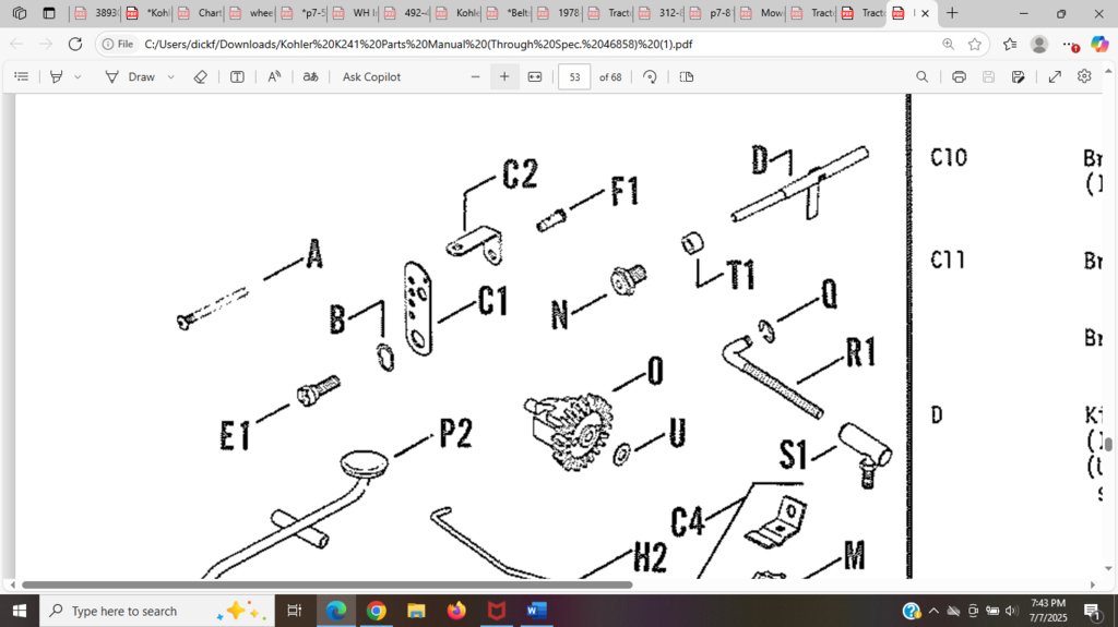

953 nut 64,108 #5 Posted July 7, 2025 53 minutes ago, Scott from ontario said: round tube that holds the governor arm in place Not sure if this will help but it is from the K-241 parts manual. 47 minutes ago, Scott from ontario said: not sure how this part goes I use a wood dowel to hold the two parts of the cam shaft in place while slipping the shims in place then push the pin intoplace which pushes the dowl out. Share this post Link to post Share on other sites
Scott from ontario 3 #6 Posted July 8, 2025 Part number t1 that’s the part I can’t find and on the cam shaft not sure on how the other part goes back on Share this post Link to post Share on other sites
rmaynard 16,866 #7 Posted July 12, 2025 On 7/7/2025 at 8:00 PM, Scott from ontario said: Part number t1 that’s the part I can’t find and on the cam shaft not sure on how the other part goes back on I'm not sure whether it was a mis-type, but T1 does not go on the cam shaft. It goes on the governor shaft. Share this post Link to post Share on other sites
