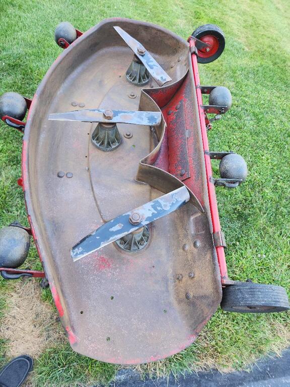

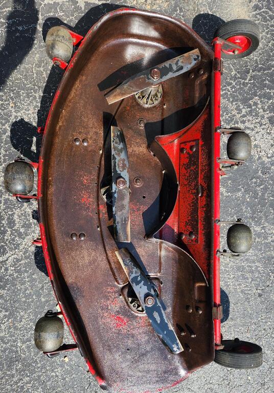

Brockport Bill 2,031 #1 Posted July 6 Did my mid season Mower deck cleaning -- I had done a fall cleaning including pressure wash and oil treatment before winter storage -- so shell has stayed pretty clean this season but just completed mid season cleaning pressure wash, and wire brush - then the Fluid Film, and then baking in sun per the suggestions here on Red Sq including from what i recall were Pete's suggestions to bake in the oil --- So today it was suggested to me by my son that he was told another technique i had not heard ----------- so wondered if Forum members ever heard this???????? Idea is after oil and sun application to run deck on dirty dusty area and "coat" the oil with layer of dusty dirt ---- to create another barrier sealing effect that cakes on ---- adding another barrier to stop corrosion and grass sticking -- Anyone heard this idea?? 1 Share this post Link to post Share on other sites
