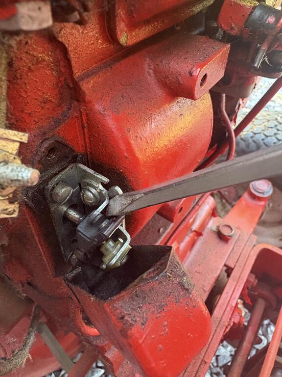

cubflyer 4 #1 Posted July 6 Hello, I’m currently working on a K181 engine and I’m wondering if these points are worn out and need replacing? Thank you in advanced. Share this post Link to post Share on other sites
pfrederi 18,749 #2 Posted July 6 Clean them up if yo see a pit on one side and a mountain on the other replace them If the contacts are fairly even run them 2 3 1 Share this post Link to post Share on other sites
Ed Kennell 42,341 #3 Posted July 6 I like to work them smooth and flat with a thin points file. 1 1 Share this post Link to post Share on other sites
squonk 43,998 #4 Posted July 6 1 hour ago, pfrederi said: Clean them up if yo see a pit on one side and a mountain on the other replace them If the contacts are fairly even run them Yes. Good used OEM Kohler points are probably better than New ( who knows where they come from ) points. 1 Share this post Link to post Share on other sites
ri702bill 9,586 #5 Posted July 6 I take it that you opened the points beyond normal for the picture. Gap should be .018 to .020 inch. Metal transfer from one contact to the other tells you the condenser is not "Matched" for optimum operation. You may wish to get a new one.... 1 Share this post Link to post Share on other sites
Gasaholic 310 #6 Posted July 6 1 hour ago, squonk said: Yes. Good used OEM Kohler points are probably better than New ( who knows where they come from ) points. Can still get new OEM points and condenser on Amazon... but yes make sure they are OEM and not aftermarket.... Trust me, the aftermarket ones generally suck. I save back my old points and clean them up for "in a pinch" re-use until I can get new ones. I have had to replace several aftermarket points just because they failed mechanically (plastic melted, screw that holds points wire stripped, spring weakened so they wouldn't close, etc.) 1 Share this post Link to post Share on other sites
wallfish 18,319 #7 Posted July 6 7 hours ago, cubflyer said: I’m wondering if these points are worn out and need replacing? Clean the contact surfaces with a file or fine grit sandpaper, gap them properly and run it. 3 1 Share this post Link to post Share on other sites
