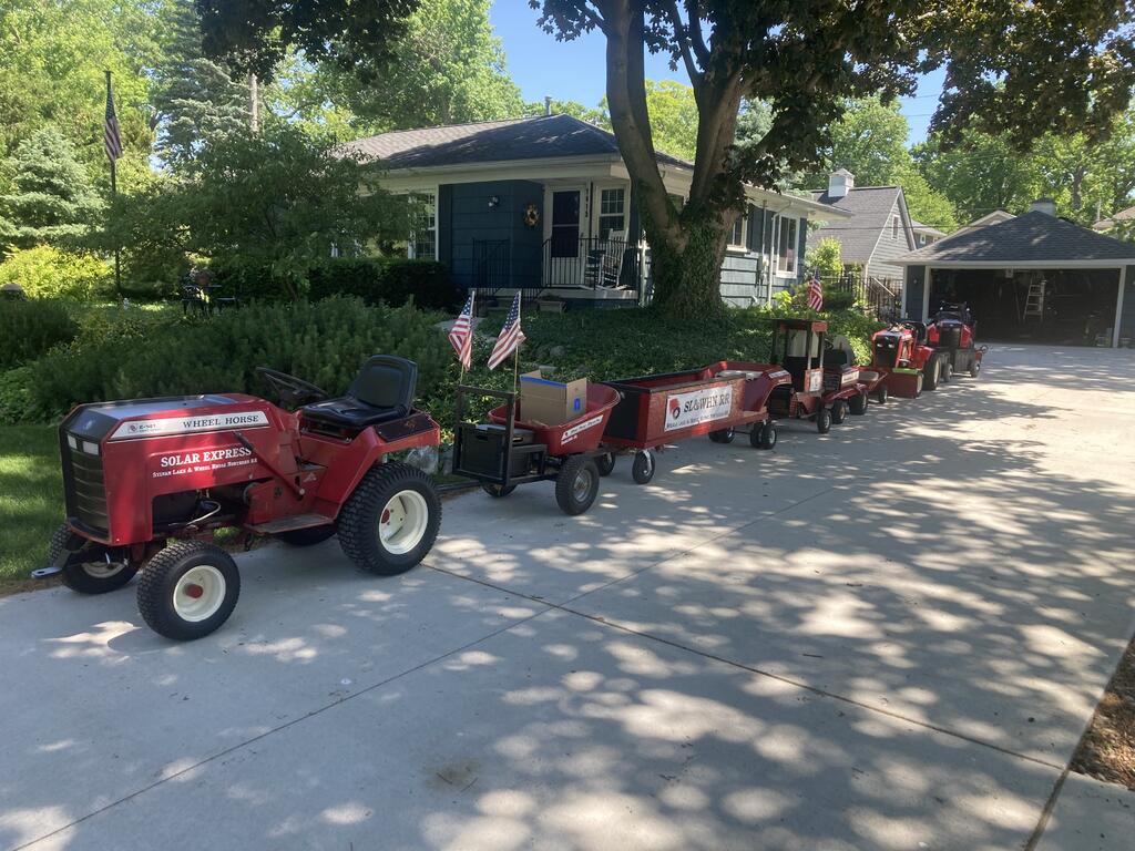

SylvanLakeWH 30,925 #19 Posted July 5, 2025 This comes up frequently. Pulling in low 1 or 1 it will pull a lot... stopping, as mentioned-not so much. Something else is where's the weight? If it's above the rear axle you add to the problem... I pulled my train fully loaded with kids and occasionally adults. Easily over 1000 lbs. Hitches all below or at axle height, Dead flat paved street only... First gear. Never any issues... 4 Share this post Link to post Share on other sites
squonk 45,894 #20 Posted July 5, 2025 6 minutes ago, SylvanLakeWH said: This comes up frequently. Pulling in low 1 or 1 it will pull a lot... stopping, as mentioned-not so much. Something else is where's the weight? If it's above the rear axle you add to the problem... I pulled my train fully loaded with kids and occasionally adults. Easily over 1000 lbs. Hitches all below or at axle height, Dead flat paved street only... First gear. Never any issues... Electric motor braking on that? 2 Share this post Link to post Share on other sites
SylvanLakeWH 30,925 #21 Posted July 5, 2025 41 minutes ago, squonk said: Electric motor braking on that? Interesting you ask that... the tractor, brakes, transmission etc is exactly the same as a C Black Hood. I never "tested" the concept... but I'm thinking no...? Not thinking the drive belt would hold? I pulled it with both my C-105 and the E-141's and noted no braking difference... I no longer have the E-141's or the train... 2 Share this post Link to post Share on other sites
