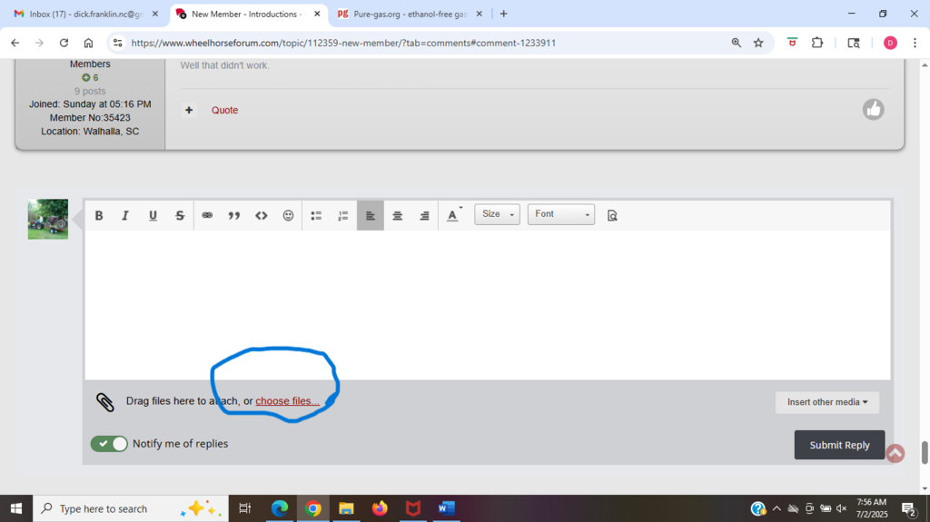

rjg854 12,750 #17 Posted June 30, 2025 2 hours ago, whb100 said: Never posted a picture. I'll see if I can figure it out. In the reply box, click on the choose files in red, below. Then go to your pictures and choose which ones you want to post. Once they load, click on the plus sign on the picture and you're all set. 1 Share this post Link to post Share on other sites
whb100 6 #18 Posted July 2, 2025 (edited) Preview attachment 20250123_152253.jpg [Image] 3.4 MB 2.webloc Pic test.Preview attachment 20250123_152253.jpg [Image] 3.4 MB 2.webloc Edited July 2, 2025 by whb100 Well that didn't work. Share this post Link to post Share on other sites
953 nut 63,780 #19 Posted July 2, 2025 Click on the choose files... on the device your photos are on and it will take you to your photos so you can select your photo. Share this post Link to post Share on other sites
