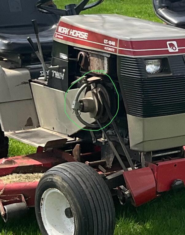

Blackhood Bill 728 #1 Posted June 28, 2025 (edited) Is there any maintenance that needs to be done on a PTO I have circled the area in green. I was tilling the it came unlocked on the left side. Put it back in place put belt back on in proper location then went to till again and the PTO now won’t turn. This is on a 1984 c 145 auto kohler engine. Had no trouble until today. Edited June 28, 2025 by Blackhood Bill Spell correction Share this post Link to post Share on other sites

squonk 45,894 #5 Posted June 28, 2025 (edited) First thought is the clutch disc failed. There is an inner and outer bearing and an inner seal in the pulley K B Horse parts has all new parts and they are top quality. The clutch disc is better than original. Edited June 28, 2025 by squonk 1 Share this post Link to post Share on other sites
