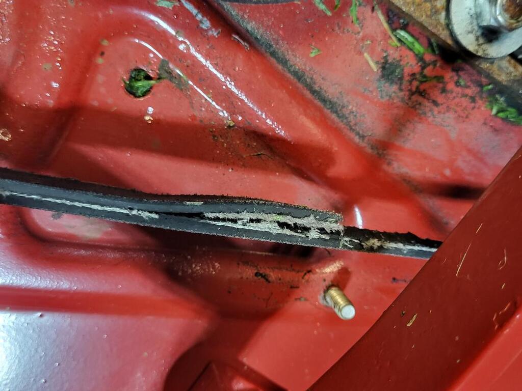

Ed Kennell
:banana-gotpics:   Where is the damage? back side or vee side.
Edited by Ed Kennell
matt monte
im not sure, its shredded, ill pull deck and safety guards off tomorrow and snap a pic. on the blue belt, prior, it was in 50 pieces all over the lawn

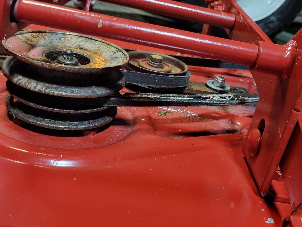

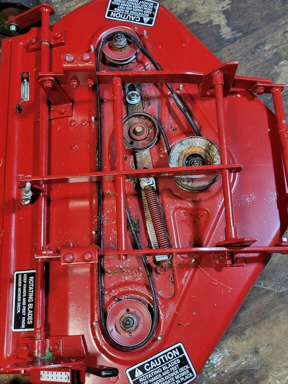

matt monte
weird, im not an idiot, wouldnt put belt on backwards as it appears to be sitting. Also it looks like it jumped out of pulley, in-between the center one.  Maybe that bar with idler pulley is to tight? maybe grass was to long/wet for this 10hp? Both are plausible but doubtful to be. Id like to figure out what im doing wrong
Ed Kennell
Well it's clear the belt is not in the lower center spindle pulley. It is in between the pulleys.
  • Like 2
  • Excellent 1
matt monte

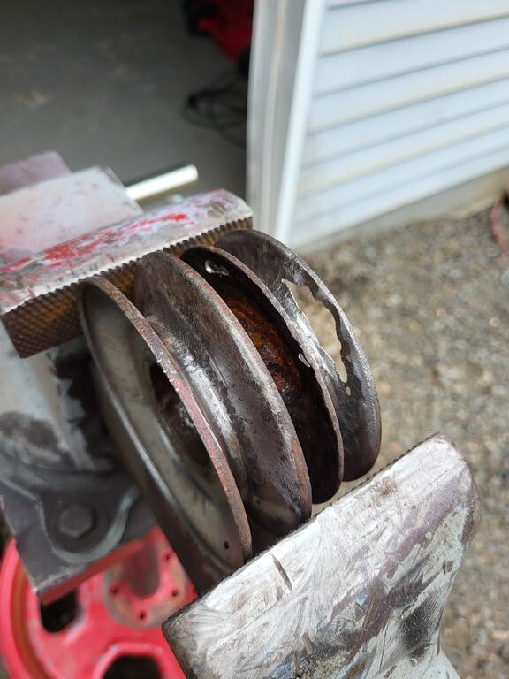

i saw that, but just noticed something else. appears pulley on bottom is rusted thru, in center. maybe belt it getting thrown out?
  • Like 1
Ed Kennell
Yes, I see that pulley is toast.
  • Like 2
wallfish
I can see the hole in the pic and it's eating the belt
  • Like 1
matt monte
Great...... I remember destroying pulleys in the past attempting to remove.  Anyone have an idea of pn# and where to purchase? Assuming i have to hunt down something used?
Ed Kennell
part number 107439 item 6       A to Z tractor for used parts.
You should inspect all the pulleys and replace if they are badly rusted.

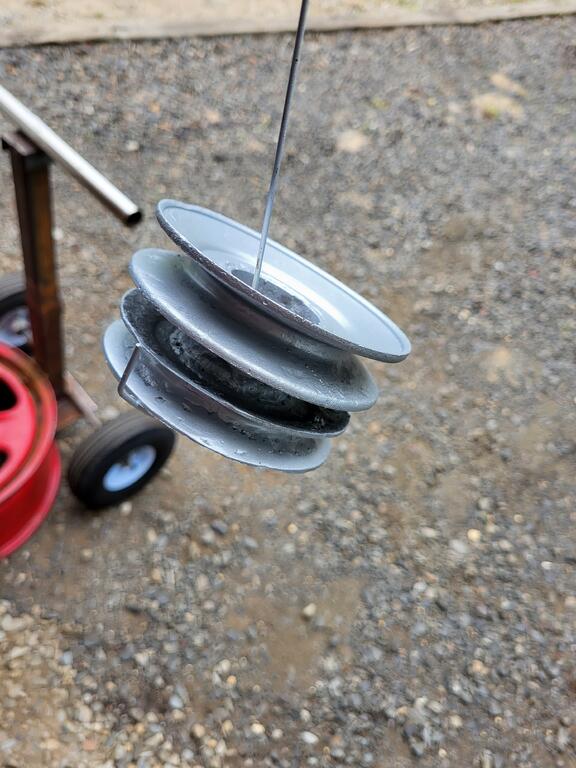

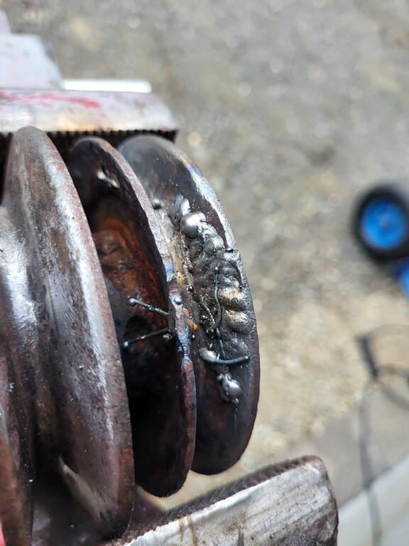

matt monte

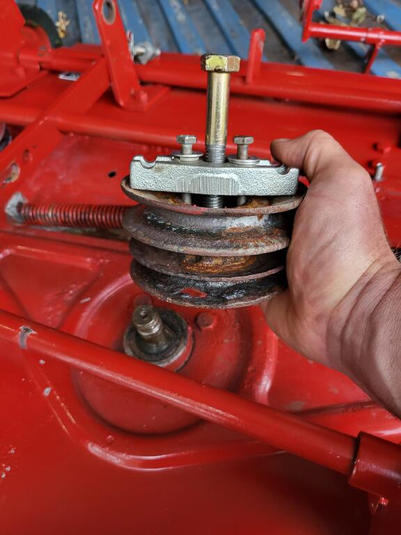

deck was sitting outside for years. Whats odd is no rot on deck itself. I media blasted, checked spindles for free play, greased fittings. I replaced idler pulley with one id had and replaced those plastic bushings it slides on. new blades as well. how that rusted pulley got by me ill never know. Time to break out the torch to heat her up. I have pullers but they seem to mar up pulley on removal.
  • Sad 1
matt monte
gonna work at removal today, ill post my findings as always thank you to everyone here.
  • Like 2

Ed Kennell
Use the two nail bar puller trick. They reach under the pulley to the hub.

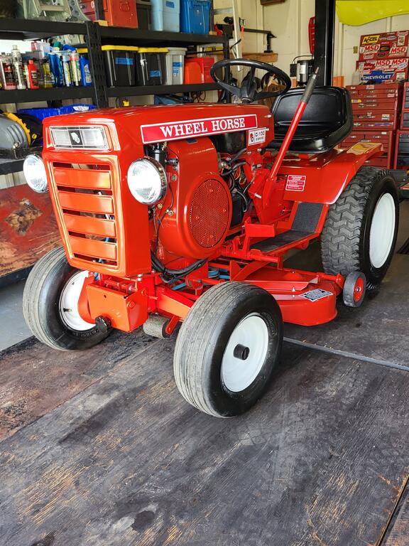

matt monte
my tractor is the combination of 3 parts tractors. At this point i dont recall if this frame the B80, the C-125 or the C-100. I scored them all around the same time. I stripped them down and made the one tractor outta  the useable parts. I suppose to purist its frowned upon but they were all headed for the scrapper if i didn't make a move
  • Excellent 2
