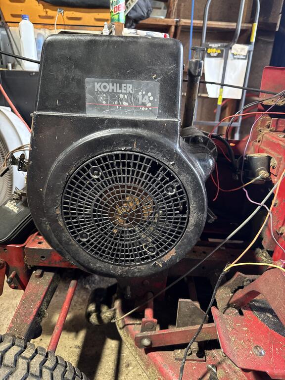

953 nut 63,558 #2 Posted June 26, 2025 Since your GT-2500 was magneto ignition and the Magnum is also the majority of the wiring will be the same. Your starter wire from the B&S will be connected directly to the Kohler starter. Your ignition and safety switches can be used as is, no change needed. The diagram shows a black wire leaving the "Kill Relay" and a green wire going to the Magneto on your B&S, this wire will be connected to the white (or Pink) wire from the Magnum engine will connect to it. Depending on the charging system of the Kohler some slight changes will be made. Post a picture of the front of the Kohler's fan shroud and we can tell you what needs to be done. 2 2 Share this post Link to post Share on other sites

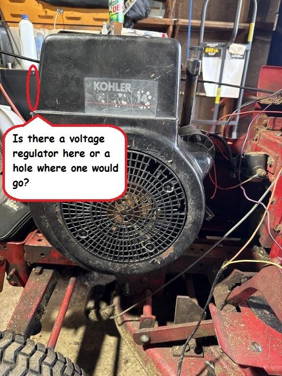

953 nut 63,558 #4 Posted June 26, 2025 That purple wire should go to a three wire connector on the voltage regulator. If you do have the three wire connector then you can run the purple wire from the engine to the Yellow lighting wire and the RED charging system wires of your tractor. Share this post Link to post Share on other sites

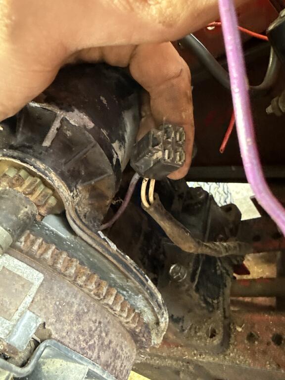

Hobbyhorse99 1 #5 Posted June 27, 2025 There is a hole there but no regulator. And a flat 3 spade connector Share this post Link to post Share on other sites

953 nut 63,558 #8 Posted June 27, 2025 12 hours ago, Hobbyhorse99 said: There is a hole there but no regulator. And a flat 3 spade connector The center wire of the three wire connector should read zero ohms to the purple wire of the engine five pin connector and will hook up to your lighting and charging wires. Run the purple wire from the engine to the Yellow lighting wire and the RED charging system wires of your tractor. Share this post Link to post Share on other sites
