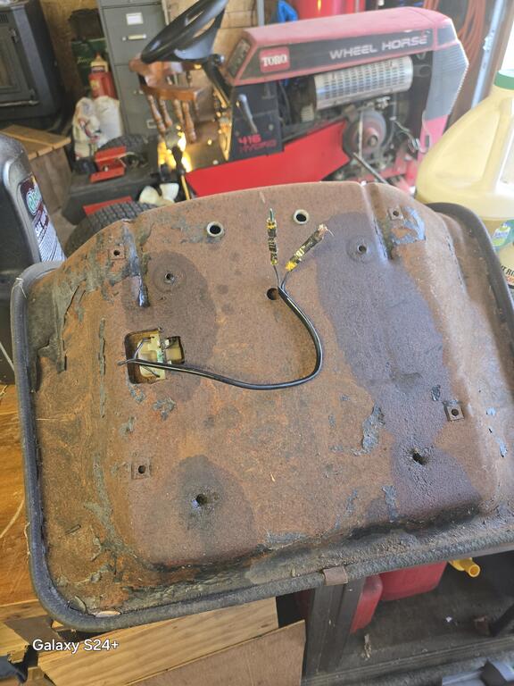

TheMooseIsLoose 14 #1 Posted June 26, 2025 I am restoring a 1997 WH 416H and in need of a new seat. Can’t find an original as shown with the safety switch inside the seat. How do I bypass this switch or would I have to add a button type switch in the seat pan. I don’t know the insides of this switch on how it works and would rather bypass it. Any help would be appreciated. Share this post Link to post Share on other sites
Sodaking27 1,129 #2 Posted June 26, 2025 I used the KM 125 Uni Pro from “tractorseats.com”. Has the 7.5x8 bolt pattern needed. They also have the button switch available. Worked great on my 416H. 3 Share this post Link to post Share on other sites
gwest_ca-(File Mod) 12,011 #3 Posted June 26, 2025 Click on the picture in the link for more 1 Share this post Link to post Share on other sites
Achto 31,100 #4 Posted June 26, 2025 I do believe that the switch is normally open and closes when you sit on the seat. If you connect the 2 wires that go to the switch together, this would by pass the switch. 1 Share this post Link to post Share on other sites
953 nut 64,255 #5 Posted June 26, 2025 We don't encourage anyone to bypass safety switches. They are there to protect you in the event of an accident. Most new garden tractor and mower seats will have provisions for this type of switch. Look before you buy. 2 Share this post Link to post Share on other sites

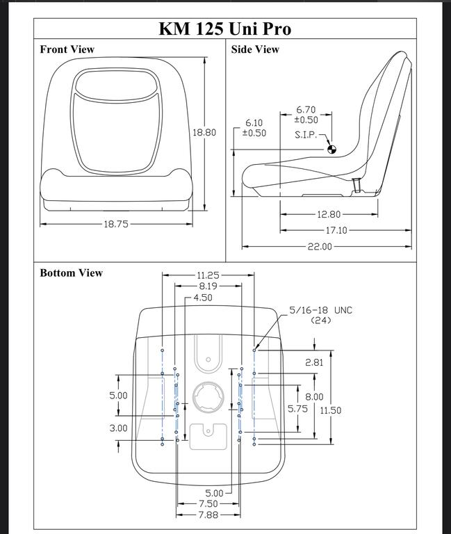

TheMooseIsLoose 14 #11 Posted June 28, 2025 On 6/25/2025 at 8:48 PM, Sodaking27 said: I used the KM 125 Uni Pro from “tractorseats.com”. Has the 7.5x8 bolt pattern needed. They also have the button switch available. Worked great on my 416H. I'm going to order a seat but on their website for the diagram of seat bolt pattern it doesn't show the 7.5 width but the 8.0 is ok. Share this post Link to post Share on other sites
Sodaking27 1,129 #12 Posted June 28, 2025 Here is the bolt pattern info for the seat. Share this post Link to post Share on other sites
TheMooseIsLoose 14 #13 Posted June 29, 2025 Thank You. this one has more detail then the one I had. Share this post Link to post Share on other sites

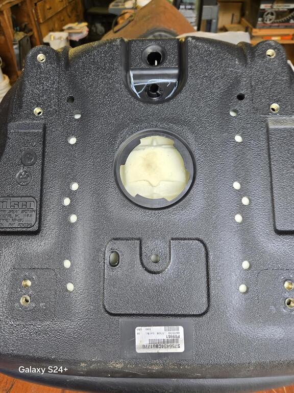

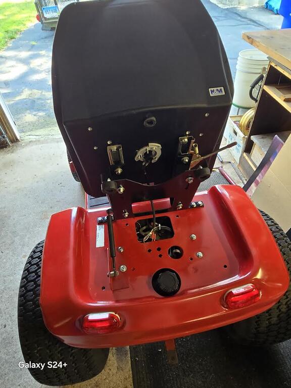

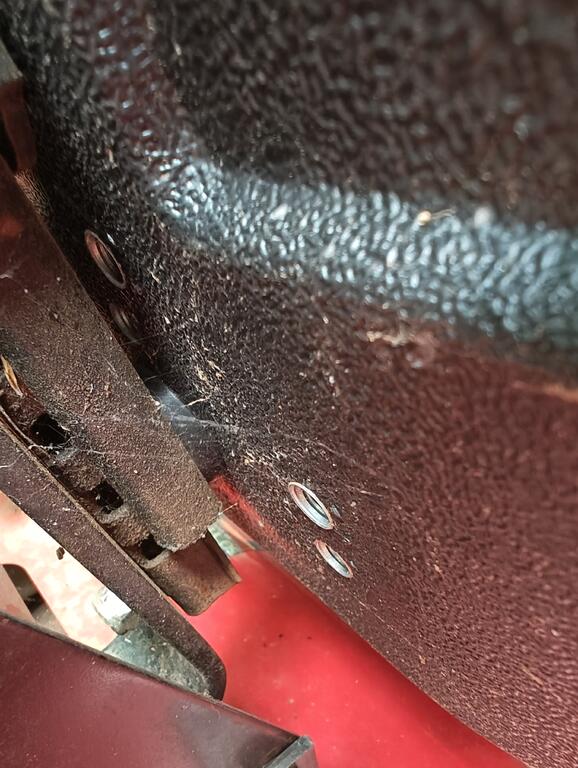

TheMooseIsLoose 14 #14 Posted July 8, 2025 (edited) On 6/28/2025 at 4:22 PM, Sodaking27 said: Here is the bolt pattern info for the seat. Received seat, all holes are present but there are only 4 threaded holes the rest have no threads. Now I will have to fabricate a plate to use threaded outside holes. Plastic bottom with 4 twinserts. Edited July 8, 2025 by TheMooseIsLoose pic shown Share this post Link to post Share on other sites

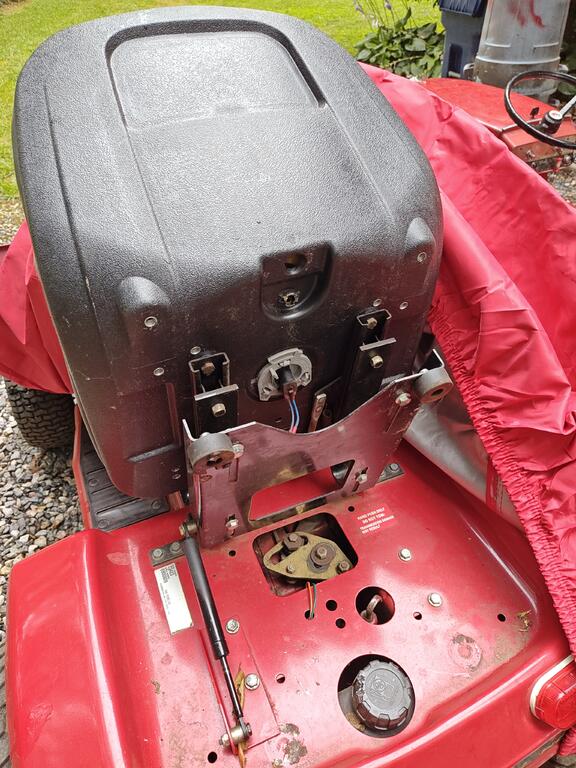

rmaynard 16,884 #15 Posted July 8, 2025 My KM-125 bolt pattern (threaded) matched the holes on the hinged platform of my 416 perfectly. I'm not sure what would be different on yours. Share this post Link to post Share on other sites

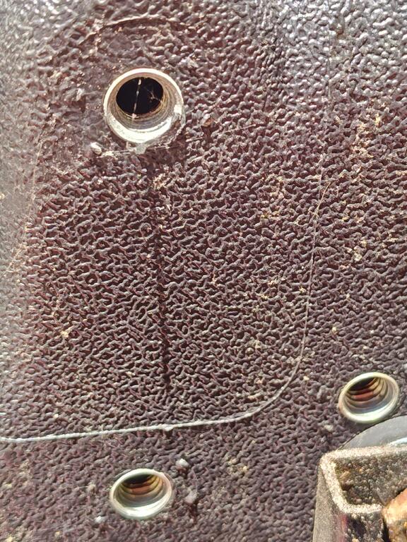

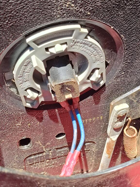

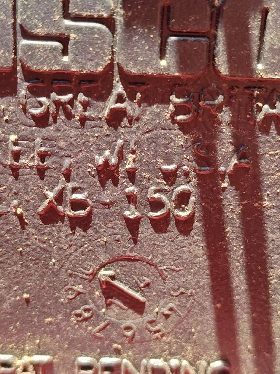

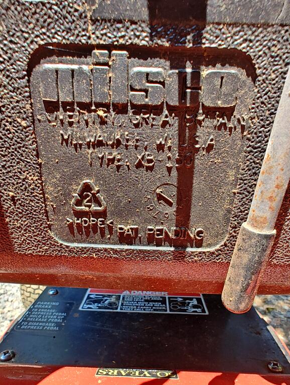

rmaynard 16,884 #16 Posted July 8, 2025 Also, having never really looked closely at the bottom of the seat until now, it has a manufacturers mark. Milsco Seat. XB 150. All holes are threaded. All holes threaded And built-in safety switch Share this post Link to post Share on other sites

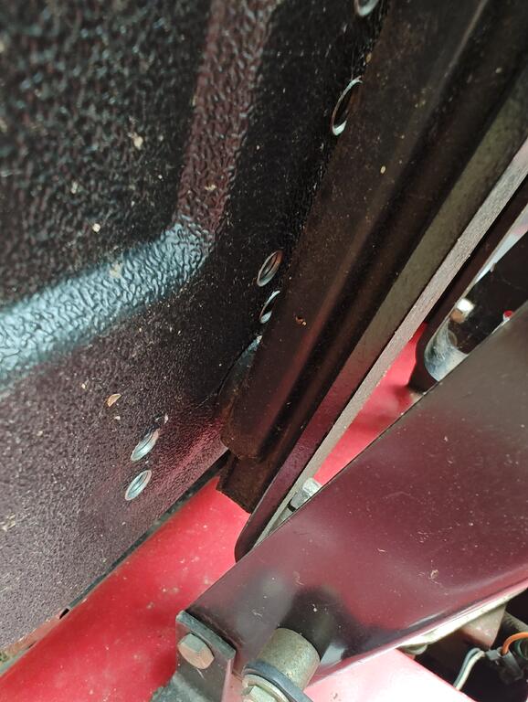

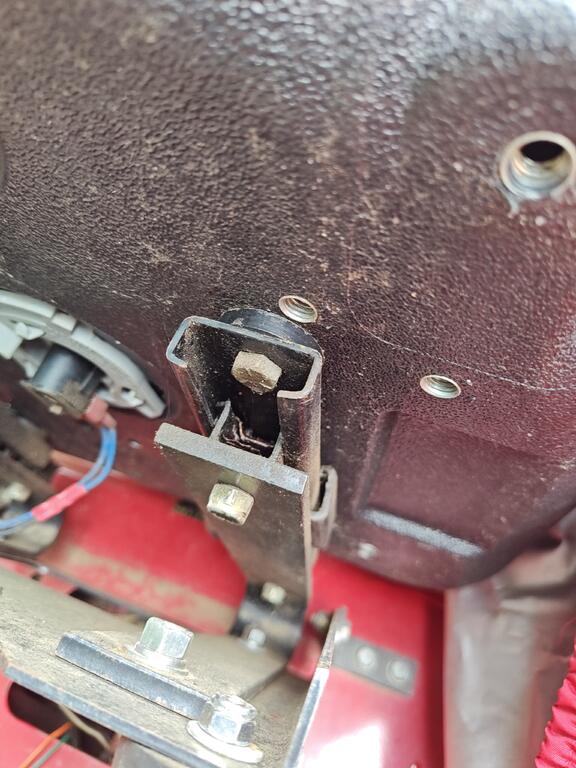

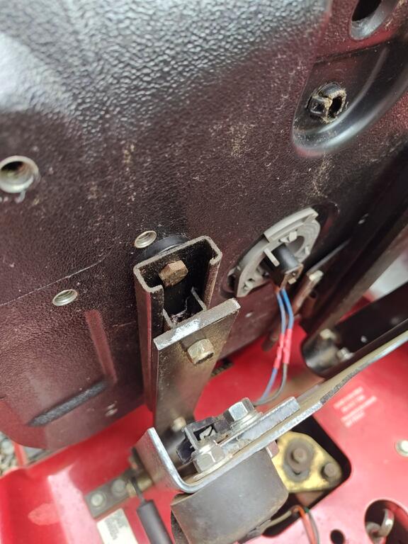

TheMooseIsLoose 14 #17 Posted July 8, 2025 6 hours ago, rmaynard said: My KM-125 bolt pattern (threaded) matched the holes on the hinged platform of my 416 perfectly. I'm not sure what would be different on yours. Do you have a picture Share this post Link to post Share on other sites
rmaynard 16,884 #18 Posted July 8, 2025 13 minutes ago, TheMooseIsLoose said: Do you have a picture Sure. Here are a bunch. Share this post Link to post Share on other sites
Sodaking27 1,129 #19 Posted July 9, 2025 (edited) Just checked mine. All holes are threaded also. Possibly a defective seat from the factory you received. I would contact the seller. Edited July 9, 2025 by Sodaking27 Share this post Link to post Share on other sites

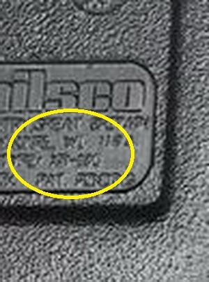

rmaynard 16,884 #20 Posted July 9, 2025 18 hours ago, TheMooseIsLoose said: Received seat, all holes are present but there are only 4 threaded holes the rest have no threads. Now I will have to fabricate a plate to use threaded outside holes. Plastic bottom with 4 twinserts. Take a look at your model number on the left. That does not look like KM-150 or XB-150 Share this post Link to post Share on other sites
Handy Don 15,993 #21 Posted July 9, 2025 There should be a metal plate behind those holes in the plastic, as there is for the correctly threaded holes. Definitely NOT as advertised! Share this post Link to post Share on other sites
TheMooseIsLoose 14 #22 Posted July 9, 2025 15 hours ago, rmaynard said: Sure. Here are a bunch. So, I called the manufacturer and told him my problem. He said yes there is a problem with that seat that they are trying to resolve. He looked for a seat with a 7.5 x 8.0 pattern and he suggested the KM-225 (8773) and I also ordered the safety switch. So, I with try that when I get it. The kicker is he didn't want the other seat back (not worth the hassle) and am getting my payment back. Thanks for all your help 2 Share this post Link to post Share on other sites

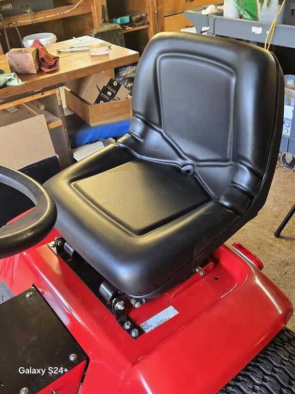

TheMooseIsLoose 14 #23 Posted July 21, 2025 Well I got my new Uni-Pro KM-223 (8801) seat, put it together and installed. Looks, works, and fits great. Thanks for all the help. 1 3 Share this post Link to post Share on other sites
