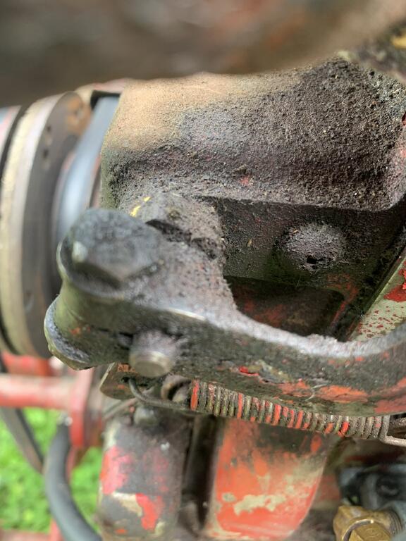

Scott from ontario 3 #1 Posted June 23, 2025 Good afternoon everyone I was wondering if anyone can help me out on changing the governor gear and parts for the motor mine does not work at all and it was my grandfathers tractor I’m trying to fix thank you in advance Share this post Link to post Share on other sites
953 nut 64,108 #2 Posted June 23, 2025 The governor gear replacement will require a total disassembly of the engine. The attached Service Manual will guide you through the process. Share this post Link to post Share on other sites
Scott from ontario 3 #3 Posted June 23, 2025 There is no way of fixing the governor from just taking the oil off of taking the cover off just below it I didn’t want to break down the whole motor if I don’t have to Share this post Link to post Share on other sites

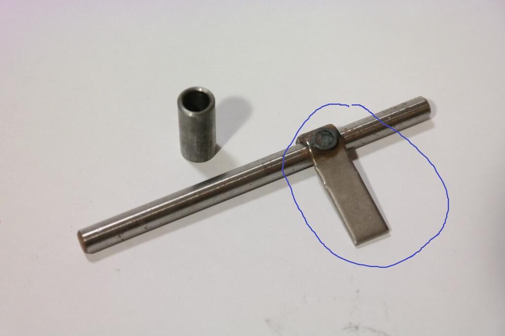

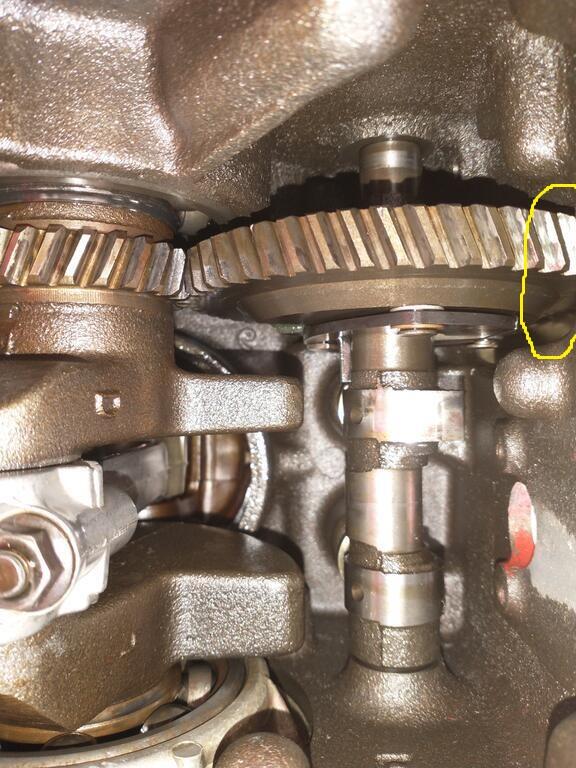

squonk 45,501 #4 Posted June 23, 2025 (edited) Nope. Got's to tear down the whole enchilada. Most likely the tab on the governor shaft broke off. It's buried under this area by the cam. Cam has to come out which means the flywheel side bearing plate has to come out to see the timing marks. Edited June 23, 2025 by squonk Share this post Link to post Share on other sites
Pullstart 68,878 #5 Posted June 23, 2025 Are you sure it can’t simply be adjusted externally? 1 Share this post Link to post Share on other sites
Pullstart 68,878 #6 Posted June 23, 2025 This is a small block Kohler, but they adjust the same. 2 Share this post Link to post Share on other sites

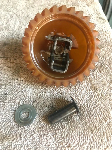

Scott from ontario 3 #7 Posted June 23, 2025 (edited) Anyone know what I can use or size of the sleeve inside the governor the one that is behind the bolt on the motor the sleeve part in the picture that I was sent on here please Edited June 23, 2025 by Scott from ontario Forgot something Share this post Link to post Share on other sites
Scott from ontario 3 #8 Posted June 24, 2025 Is there a way to tell if the governor wheel is gone inside the motor I took the bottom off and the cam wheel cover on the front the gears look good from what I can see but not sure how to tell if it would work with the motor running Share this post Link to post Share on other sites
953 nut 64,108 #9 Posted June 24, 2025 With the engine inverted you may be able to view the governor gear turning turning while the crankshaft is turned. The governor gear is driven off the cam gear. Things are a bit tight in that area so all you are likely to see is the plastic gear turning. Share this post Link to post Share on other sites
Scott from ontario 3 #10 Posted June 29, 2025 Hello does anyone know what I can use for the governor shaft gear spacer and size? Share this post Link to post Share on other sites
