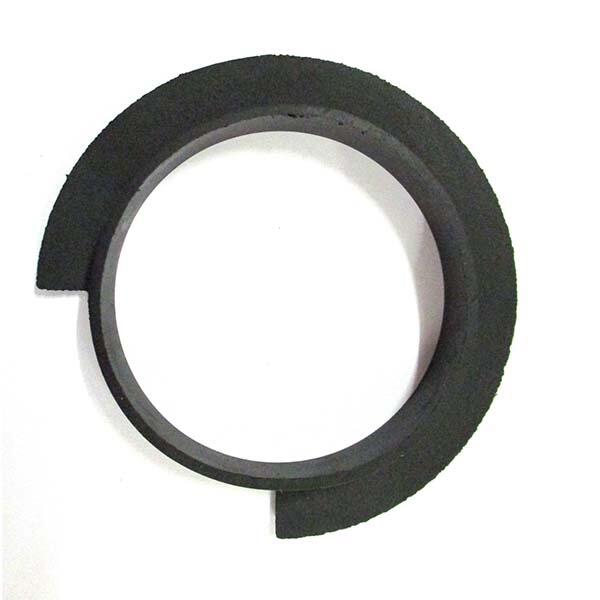

lynnmor 8,644 #5 Posted June 23, 2025 (edited) 7 hours ago, Lee1977 said: ''''''''' I have been using NAPA Gold 1348 on both my Onan and Vanguards. They are around 3 1/4" tall. I wonder how the gasket fits around the flutes on that short filter. Do they fit the same now that they are made in China? Edited June 23, 2025 by lynnmor 1 Share this post Link to post Share on other sites
Lee1977 7,564 #6 Posted June 23, 2025 2 hours ago, lynnmor said: I wonder how the gasket fits around the flutes on that short filter. Do they fit the same now that they are made in China? I found out that NAPA Gold filters are no longer made by Wix . I buy from Fleet Filter and mine are 3 or 4 years old as I bought a box of 12. Don't know who is making NAPA filters now. Fleet Filter went to Wix 51348. I had the cover off my Onan last fall to clean the fends and blew the gasket off twice after that, Had to clamp it between front and side cover to keep it on. It wasn't blowing off before I cleaned it. 1 Share this post Link to post Share on other sites
