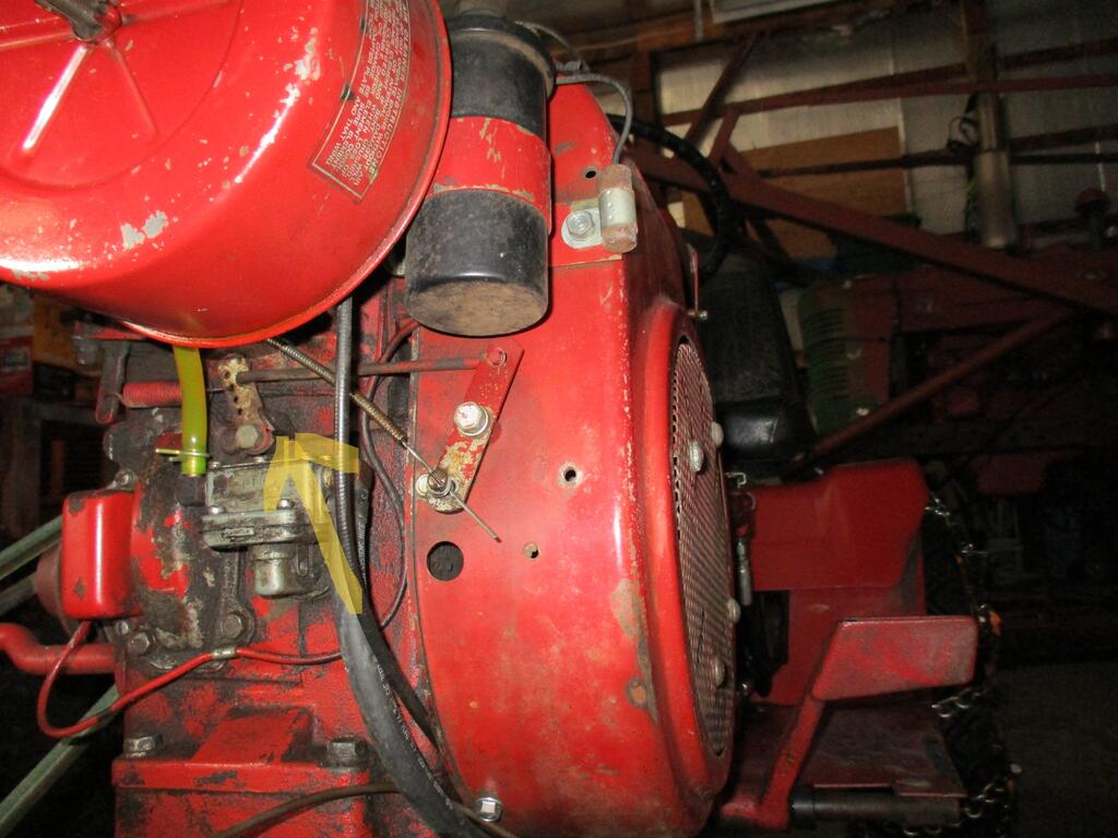

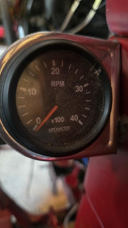

BrianX128 109 #4 Posted June 26 (edited) On 6/21/2025 at 7:57 PM, peter lena said: @BrianX128 first question would be are you cutting grass at the highest level ? very important for a deck to be able to empty itself out , another thing would be what speed / gear are you in ? how easily does your deck spin up ? thinking a functional issue , if you are dealing with high / dense grass , low range / hi gear , makes a world of deference . experiment . pete Just wanted to reply back as I figured out what the issue was. I had one of those small tach's that wrap around the spark plug wire, turns out something is wrong with it. When I put this engine in I used that to set my max rpm at 3600, turns out it's been wrong the entire time. I put a "better" tach that runs off the AC wires on the voltage regulator and it was only running at 3100 pre-load. Slid the throttle cable over in the little locking channel while it was at wide open until I got that fixed and now it's a lot better. I guess the different mufflers and different engines can make it hard to tell RPM's by ear, especially if a "bad" tool is telling you that you are good. Also my blades were shot, put new stens blades on and it seems way closer to the others. Edited June 26 by BrianX128 Forgot Pic 2 Share this post Link to post Share on other sites

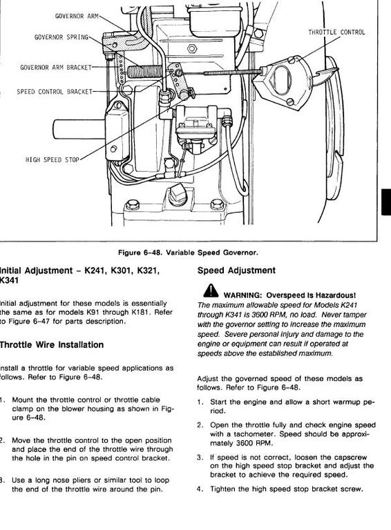

pfrederi 18,644 #5 Posted June 26 To set your high speed stop Small movement in the stop makes a significant speed change. Share this post Link to post Share on other sites
