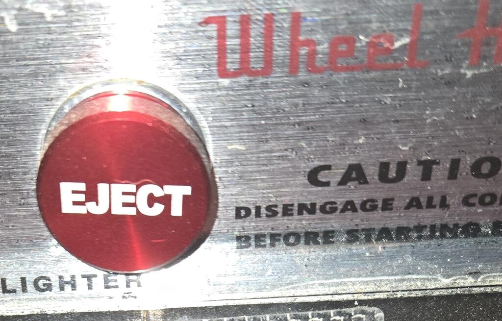

kpinnc 17,491 #4 Posted June 22, 2025 I grew up with both my parents being smokers. As with many who smoked back in those days (70s and 80s), they had no idea or concern about how much it affected others. Especially true in a car on a trip lasting more than 30 seconds... To say I despised it is an understatement! So years later, I get my second Wheel Horse (867) that just happened to have a lighter. During the course of it's restoration, I found a plug that gave me a chuckle. Either my aviation background or maybe a Freudian slip or both, but I added this in place of both my tractors lighters... They still make me smile. 1 1 Share this post Link to post Share on other sites

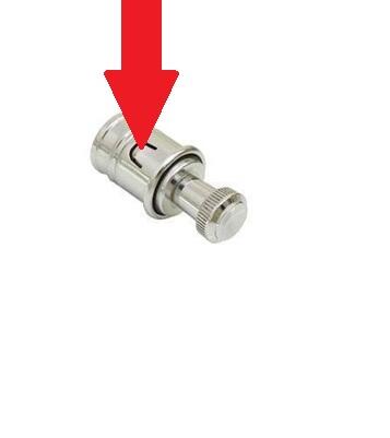

wallfish 19,498 #5 Posted June 22, 2025 On 6/21/2025 at 3:54 PM, 1968Commando said: Hey yall I got a cigarette lighter for my tractor, no I do not smoke I hate cigarettes and there smell and what they do to people, anyways I thought when you used one you just pushed it in and it got hot and then it popped out were as mine I have to push it in and hold it for it to heat up On the sides of it are little tabs. They are the detent which holds it until the heat rises and makes it weak enough to release it. Bending them ever so slightly will hold it. Do it in small increments until the lighter works properly 2 1 Share this post Link to post Share on other sites
