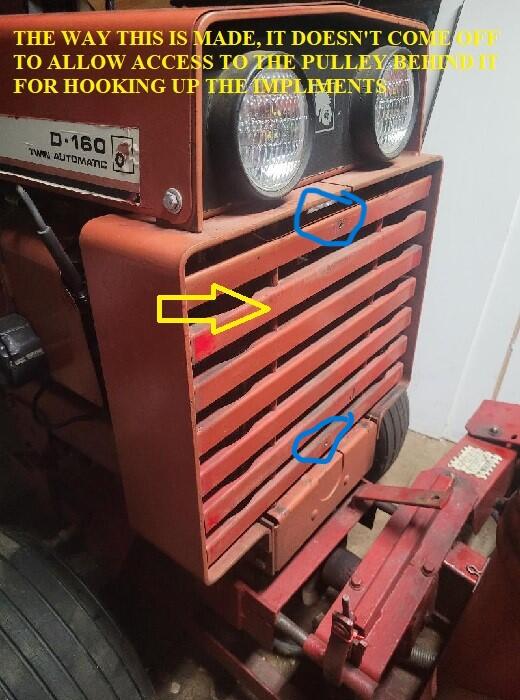

Thank you for your "fuzzy" picture! Lol! My problem seems to be two-fold here. I don't have direct access to the upper pulley. My model ( a D-160), was produced in 1980, and those had the grill assemblies that were solid, granted they were grills, but bolted to the frame and part of the hood assembly as well. There was no front panel access. Additionally, does that front assembly where the tensioning spring for the snowblower gets mounted, it's bolted to the frame as well. I assume that gets unbolted so the mounting apparatus for the lawn mower can sit there?

Cant be much help I have a D200 grill comes off never saw one that didn't.  Maybe a picture of yours???..do not have snowblower.  Is yours an Onan or K341.

I have the Onan 16HP Twin. Here are the pictures you requested as well. Hope they help you, to help me.

You grill will come off yours is missing a couple knobs.  Just put your fingers in the slots and lift up then pull the bottom out.

No, it's not missing any knobs. The guy I bought it from, for whatever reason, decided to cover this area with a thick piece of luaun which I removed and will be filling those holes in my restoration of the tractor.

My 1980 D200 has a grille like that without any knobs.  There's spring steel holding it in place, just push the grille down and it should pop out.  It took me forever to figure that out.
