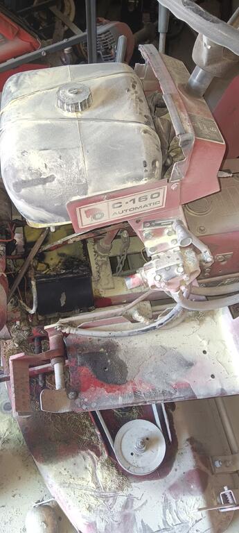

Teddy da Bear62 171 #1 Posted June 18, 2025 (edited) Guys....hoping for a quick solution here. I have a C-160 auto. Tow valve is stuck. Is there a safe, non destructive way to free it up? I've drenched with lubricant. Put vice grips on it. This tractor has a rough week (me too). I went to turn ignition and go out and mow. No sooner than starter engaged? The battery went up in flames! No explosion, just rotisserie style! Like a moron I try to blow it out huffing and puffing. No good. I grab nearby motorcycle storage cover ....stuff it in there ....no good. (Now I'm down one $75 motorcycle cover) At this point I'm imagining my demise as the gas tank if full. Flames cooking the bottom of it. I grab a fire extinguisher and one squirt puts out the fire. I was impressed. The flames melted the gas line under the tank and fuel was just pouring out on battery. I quickly turn shut off on tank (one that actually works). I examine the damage. The wiring seems perfectly intact! Melted the dust shield behind the tank. Gas tank undamaged. Battery has one corner melted. I believe out of this tragedy.....a miracle occured. That tank should have detonated! The fuel line melts and gas poured out on the flames. I should be in the hospital or worse. I believe my protector (the Arch Angel Michael) was watching over me this day! (who is also my namesake and interesting story). There had to be an ignition source (spark)!? I put on many new components. Made sure all wire connections tight and right. I had mowed a half dozen times with it without making any changes. The only significant thing I can note. The battery was no longer charging. The ammeter showed no charge when running. Stator is part of charging system. However it's been my experience that if stator doesn't function? It won't start or run. (C-195). I was/am beginning to suspect either the battery itself (3 years old) or possible rectifier failed? I'm going to remove the tank and battery for better inspection. I wanted to roll it outside for a washing. The dust you see covering tractor and floor is from fire extinguisher. 🧯 Therefore need to open stuck tow valve. Please no suggestions of heat! We've seen enough heat. Edited June 18, 2025 by Teddy da Bear62 3 Share this post Link to post Share on other sites

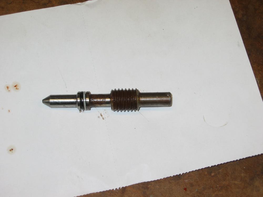

pfrederi 19,940 #6 Posted June 18, 2025 (edited) 35 minutes ago, oliver2-44 said: The complete tow valve can be removed and soaked/disassembled on the workbench or vice. I believe Teddy has a Piston To Piston Sunstrand in the C-160 with a needle valve type tow valve. It has to be unscrewed. (The older hydro gears used a port valve which you could remove as a unit.) \Piston to piston tow valve If you get it too hot you may damage eh o ring...I have some if you need them Edited June 18, 2025 by pfrederi 3 1 Share this post Link to post Share on other sites

Racinbob 12,797 #14 Posted June 19, 2025 18 hours ago, Teddy da Bear62 said: My shutoff was compromised in the fire. Need to get a new one. I believe they are available...... Not sure what specs to look for? Size? Is there a part number? The C-160 had standard black poly tank. Based on what I see in your pictures your tractor is a 76 or 77. Paul is correct that most under hood tanks having a molded nipple on the bottom but it was changed on the later models. I believe that era had the push in valve and bung. At least that's what my 76 came with. 1 Share this post Link to post Share on other sites

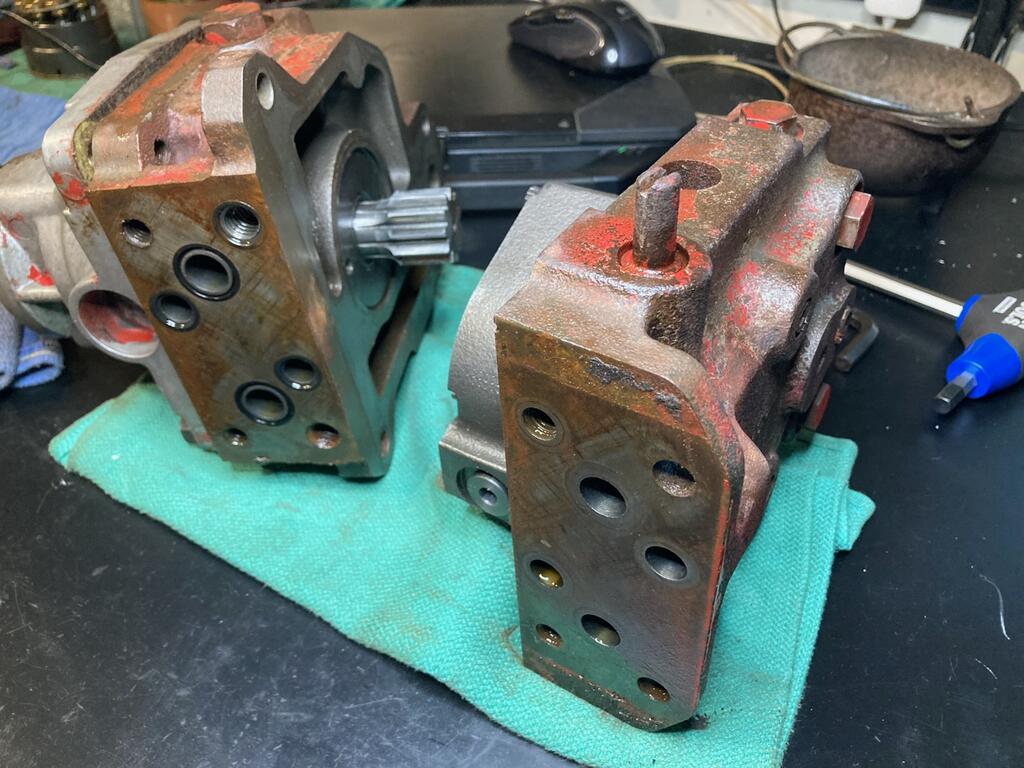

ineedanother 1,900 #18 Posted June 22, 2025 I started to battle a tow valve a couple weeks ago myself. Grabbed it with vise grips after soaking for a week and didn't get a good feeling about it. It's soaking some more before I put a pipe wrench on it...it's been over two weeks at this point. I suspect I'll be looking for one to replace it with after I tear it up. 1 Share this post Link to post Share on other sites

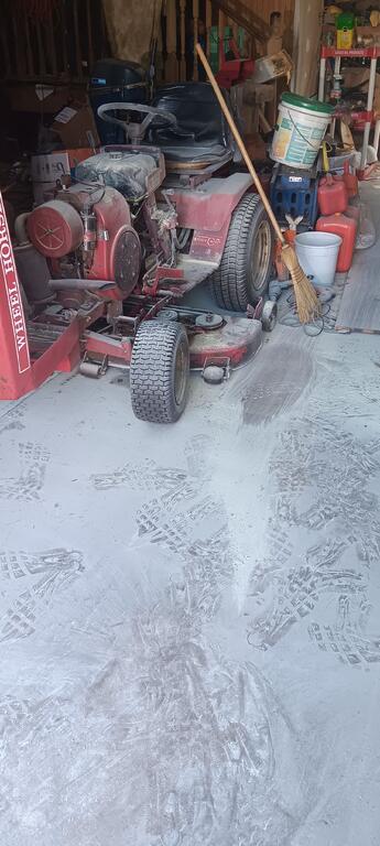

Teddy da Bear62 171 #19 Posted June 22, 2025 I came up with hillbilly solution to roll the C-160 outside and wash it.....lol I put a floor jack under tire I wanted to take off anyway (get at that tow valve). Normally with both tires on the ground? When pushed with valve close? The tires lock up. One wants to roll in opposite direction of the other. (kind of like positraction on my 72 Grabber). However, with tire off. Floor jack securely in place. It rolls without resistance! It's now washed after the fire extinguisher put fire out. I robbed a starter off other tractor. God willing it won't take a crap as well!!! All should be together tomorrow. 1 Share this post Link to post Share on other sites

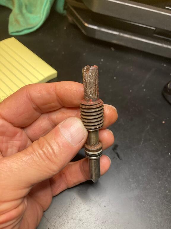

ineedanother 1,900 #23 Posted July 12, 2025 On 6/21/2025 at 10:20 PM, ineedanother said: I started to battle a tow valve a couple weeks ago myself. Grabbed it with vise grips after soaking for a week and didn't get a good feeling about it. It's soaking some more before I put a pipe wrench on it...it's been over two weeks at this point. I suspect I'll be looking for one to replace it with after I tear it up. Well @Teddy da Bear62 glad you got things rolling again. With the holiday and then everything getting flooded here in NC, I've been having to work pretty much around the clock so this has pretty much been sitting and waiting on me. I soaked it with penentrant for over a month now and tonight I put a pipe extension on the pipe wrench and just decided that it was time to move it along. It ain't pretty but it's out and now I can get moving on the reassembly. I don't think that thing had been turned in years. 2 Share this post Link to post Share on other sites
