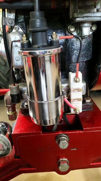

ri702bill 11,544 #1 Posted June 16, 2025 (edited) While mowing last week with my 854, it lost power & died. No spark. No arcing at points.... NO continuity on the primary winding of the coil (I figure the internal resistor went on permanent vacation.) The "Parts Department" coughed up three possible replacements - two with the standard internal resistor from engines I have heard run before and one oddball. Looks to be a Standard Motor Products 1303 that states that an external resistor is required. That was on a C81 parts tractor with the connecting rod thru the block - never heard that one run, never will. Has anyone used this style, wired like an old Slant 6 or 1960's Chevy with two positive wires - a "start" wire from the solenoid to deliver full 12 volts and a second "run" wire with a ballast resistor that would be the same as the original internal resistor type??? It is supposed to make the coil output a hotter spark while starting. I do have a solenoid on this one too. Any thoughts?? Edited June 16, 2025 by ri702bill 1 Share this post Link to post Share on other sites

ri702bill 11,544 #7 Posted June 16, 2025 13 hours ago, ri702bill said: Looks to be a Standard Motor Products 1303 that states that an external resistor is required I played "Musical Coils" this morning - swapped out all three, one at a time. All three work. Ballast location - maybe that was why Chrysler mounted them up high on the firewall?? How about locating it inside the steering tower - would double as a hand warmer! Share this post Link to post Share on other sites

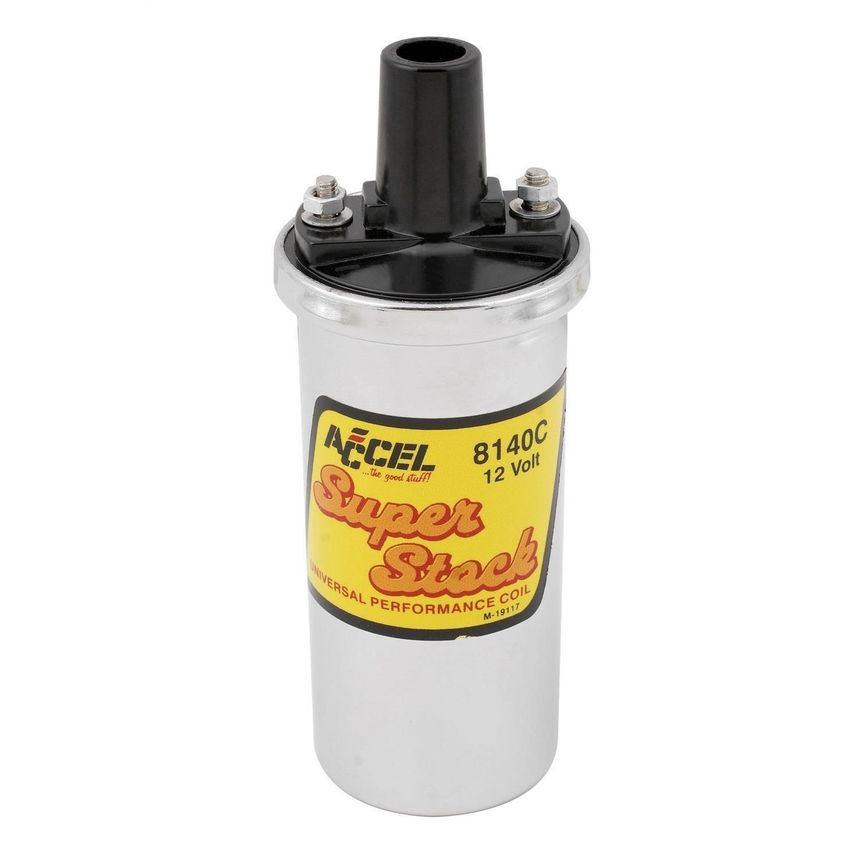

WHX?? 55,695 #9 Posted June 16, 2025 I have no problem with the resistor required type on the flame. Hard to find a chromie that doesn't need it. 1 Share this post Link to post Share on other sites
squonk 45,803 #10 Posted June 16, 2025 1 hour ago, WHX?? said: I have no problem with the resistor required type on the flame. Hard to find a chromie that doesn't need it. Accel 8140C internally resisted. 2 Share this post Link to post Share on other sites

ri702bill 11,544 #13 Posted June 17, 2025 That is the exact one that went "Paws UP" on me, hence this discussion. I did find a location I like for mounting the ballast should I choose to go that route. Horizontal mounted to the battery box between the battery & engine. Makes for short runs of wire..... Hidden out of sight. Share this post Link to post Share on other sites
ri702bill 11,544 #14 Posted June 17, 2025 7 hours ago, Stepney said: subject to vibration, and they're fragile. Yup, vibration (and sudden thermal changes) are not electrical components friends. Running the external resistor style without the resistor sends a full 12 volts, or upwards to 13.8 while running, to the points. That causes arcing, burning & pitting of the contacts at a rapid rate. If I go the external route, maybe I'll get two and install the firsy with a wingnut... Share this post Link to post Share on other sites
