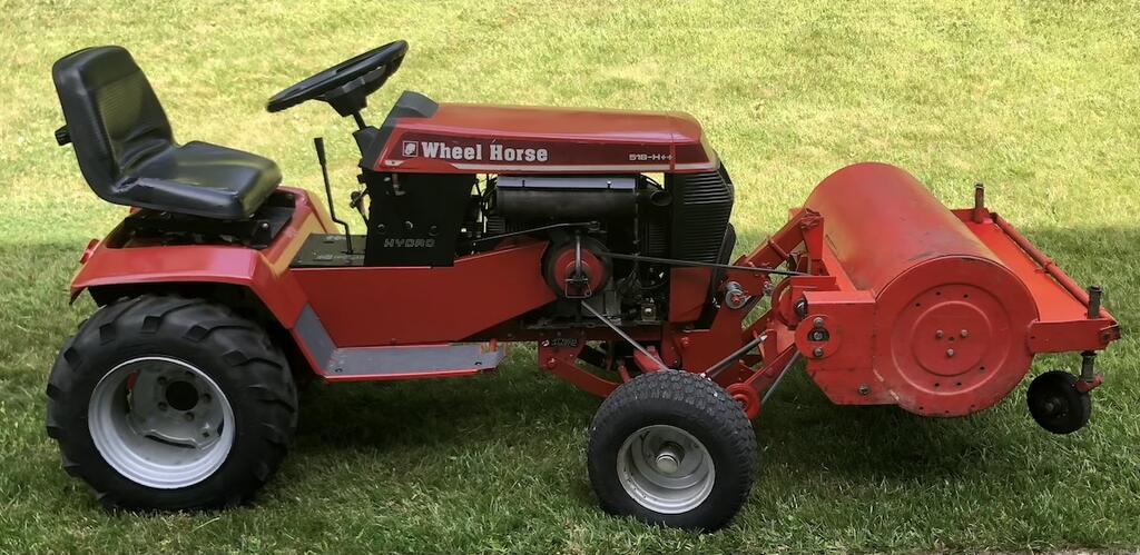

c-series don 11,759 #5 Posted June 17, 2025 I think @Handy Don has the only one that I’ve seen in person. His hydraulic setup to raise it is rather impressive. 2 Share this post Link to post Share on other sites

Lane Ranger 11,910 #8 Posted June 17, 2025 Dan: handy Don has a very neat flail mower setup he brought to the Big Show a couple years ago! Maybe he can post some pics. We mowed five acres every Saturday with an International Cub and rear flail mower ! They work great! Share this post Link to post Share on other sites
Handy Don 16,111 #9 Posted June 18, 2025 (edited) Just about to jump in the car to head to the show but here’s one picture I could find quickly. The lift brings the flail closer to the tractor so the drive belt needed a wide-capacity tensioner! This Haban flail was originally made for a 10hp Bolens. Haban also made them for JD. The tractor is a 520 chassis with a 518 engine & topsides and I extended the Eaton 1100 hydraulics to add the front lift while keeping the stock hydraulics intact. I’ll try to find some of the videos of it in action. it’s at my son and daughter’s camp and its jobs are to clear the green area quaintly referred to as “the lawn” and also to remove weeds and scrubby brush from the logging trails on the property. It is a beast. Edited June 23, 2025 by Handy Don 1 Share this post Link to post Share on other sites
