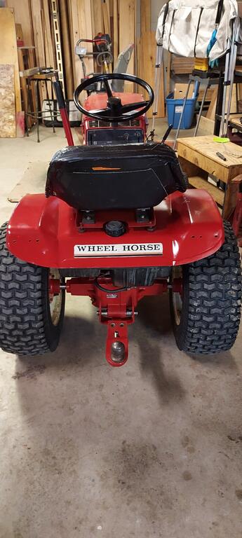

Teddo 56 #56 Posted July 6, 2025 (edited) I put everything back together Friday after putting in the new shift fork. I don't remember any issues alongt the way. Followed the manual then I would stop and have a coffee and watch more of stevasaurus in his videos and get tutoring and some laughs at that. I didn't have trouble getting the detent balls in. I used a 1'8" punch and once it was holding I switched to a small 1/8" screwdriver and that allowed the detent bolt and shift forks to slide past easier. I made sure not to forget to put the HI-LO fork in the slot of the linkage. I had a bit of trouble getting the case halfs together but it turned out to be the two pilot stubs on each case half and not the shafts. Once I discovered that, a simple twist let it drop on. I ended up broaching a new keyway slot on one of the hubs and hubs went on well after some nice polishing of the shafts. Seals went on easy. I did tape up the Woodruff key slots before installing seals. I had run my thumb across one ane got a nice slice in my thumb so I thought it smart to tape them. I only installed one seal instead of doubling them up.. Not enough room for two unless I pushed the outboard needle bearings in a bit, so I opted not to mess with those. I put it on the tractor last night and went over it today, checking all the bolts and going over the list and putting the tranny fluid in. I fired it up this afternoon, took it for a spin around the house and checked all the gears under power. All is good. Before I put the new HI-LO fork in I took it over to a welding instructor at our local college who reinforced it for me as well as repaired the broken one. Now I have a spare. Thanks to all who chimed in to help and to Master Stevasaurus whose videos I nearly memorized and enjoyed watching. He really is human. Edited July 7, 2025 by Teddo spelling 7 Share this post Link to post Share on other sites
