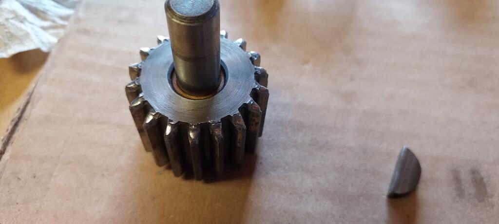

Teddo 56 #26 Posted June 29, 2025 (edited) Ed, thanks for your input. I'm presuming your entry point with the drill was from the end of the shaft. I was picturing a straight square key all this time. Are the keys readily available at auto parts stores? Educate me, please. I thought the set screw was sitting on top of the key. I take it that it does not or it wouldn't be able to turn up. Correct? I guess I don't understand the engineering of using a woodruff key that can turn up! Edited June 29, 2025 by Teddo additions 2 Share this post Link to post Share on other sites
Ed Kennell 47,946 #27 Posted June 29, 2025 2 hours ago, Teddo said: Would tapping on the key with a small flat punch in the set screw hole have any positive effect? I like that idea. Can't hurt at this point. 2 Share this post Link to post Share on other sites
Ed Kennell 47,946 #28 Posted June 29, 2025 1 hour ago, Teddo said: I guess I don't understand the engineering of using a woodruff key that can turn up! Cost 1 Share this post Link to post Share on other sites

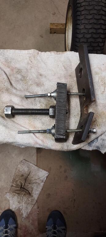

mrc 1,122 #29 Posted June 29, 2025 all the guys have given excellent advice. i find it interesting that both hubs are equally stuck. a lot can happen in 45-50 years! i recall someone posting pics where they used a small hydraulic bottle jack mounted sideways in conjunction with a homemade puller like yours to get hubs off. 1 Share this post Link to post Share on other sites

stevasaurus 23,892 #36 Posted June 29, 2025 Reguardless of which way you go here, you don't want to take a chance and ruin one of two axles and a hub. The hubs will break easily without cutting all the way into the hub. Cut your slot and then hit the slot with a cold chisel...bang, you're done. If you try to drill into the keyway, maybe a 1/8" bit will do it without messing up the axle itself. Woodruff keys are cheap and at any hardware store...they are soft metal also. Share this post Link to post Share on other sites

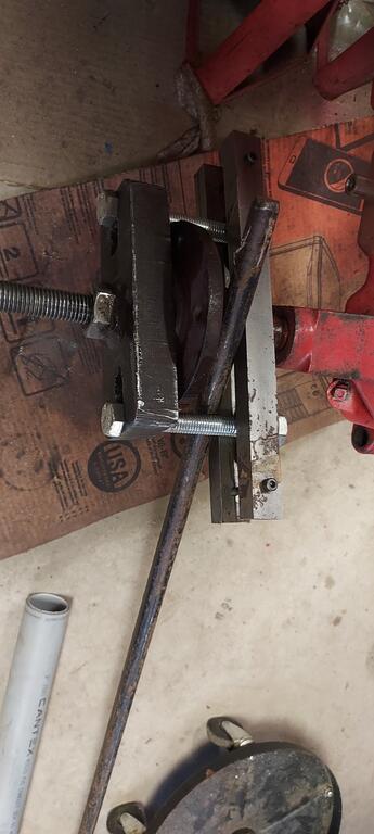

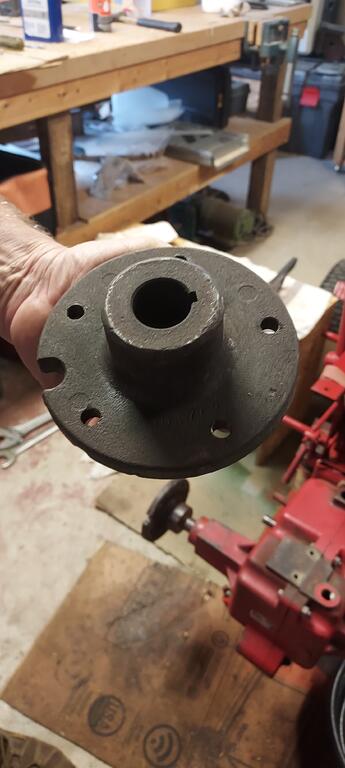

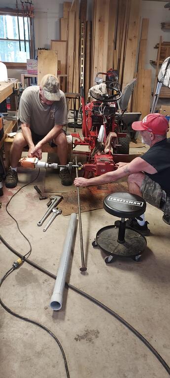

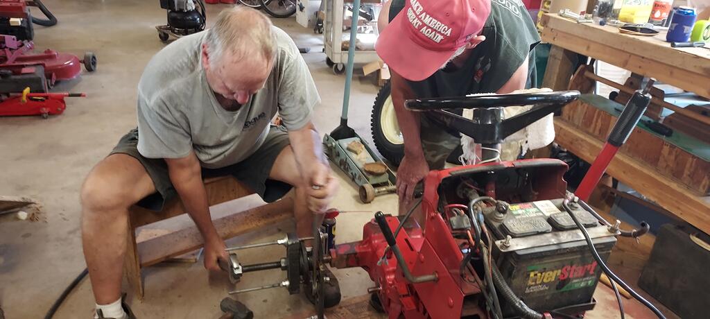

Teddo 56 #37 Posted June 30, 2025 Well, here's where I'm at after today. I went to a friends house who is a machinist and presented the problem. We talked optiopns and then got to it. He is able to broach new keyways and has all the fine machinery we need if we "injure" something. We drilled out the first keyway and began working to pull off the hub. Once we got it moving we kept at it. We spent all afternoon pulling on that thing but finally... the first hub is off. It fought us all the way. We did the same to the second hub: drilled the keyway and began to pull and pull and pull...until we bent the 1/2in steel bar of the puller behind the hub. We turned it around and pulled until it did the same thing again. At 9pm tonight we decided, after bending the 1/2' puller bar twice, that we had to create a different puller. So tomorrow we will go to his shop and make a new puller that has 3/4" bolts instead of 3/8" all-thread and a 1" bar that goes behind the hub. I'll take some pics tomorrow. I was too tired to even think about it tonight. We were both extremely surprised at how hard these dang hubs are coming off. Just years off being in one place for 45 years, I guess. We'll be back at it tomorrow and hopefully we don't break anything except for the hold this hub has on the shaft, 1 1 1 Share this post Link to post Share on other sites

Teddo 56 #39 Posted July 1, 2025 Well, we did create a new part of the puller today. We got rid of the 1/2"x4" stock with a notch cut out of it for the axle. It was too weak for the amount of pressure it takes to pull off these hubs. This is what made the difference of making it hard or making it REAL hard. After we made a simple change: 2 pieces of 1"x1/2 spaced apart the width of the axle and put behind the hub. The 2 pieces were installed so they sat with the 1" side "on the flat" so the pressure was against the 1" width of both of them We connected them with 2 small screws just for spacing. On the front part of the puller we got rid the 3/8" all-thread and machined the puller to accept 3/4" bolts which were just long enough to get 2 heavy flat washers and a nut on the back as it passed between the 2 pieces of 1"x1/2" stock. Worked like a charm. No slop in the holes we made and we made it to pass on the outside of the hub, not through any lug holes. I got a 1 1/2" inch socket to fit the drive screw and let the impact do the work. It was slow at first-like the width of a hair. Then it started jumping in 1/32" increments and about 15-20 minutes later it was off! Fought all the way but it lost the battle! The only thing we lost were the keys. Shafts are good and we still have two hubs. The quality of the tool, not it's cost, makes all the difference. There is NO way the hub could have taken the pressure if it had been a conventional hub puller pulling on the flange. It would have shattered. If this hadn't moved today I would have shopped for a hub and cut it in 3 pieces as stevasaurus suggested. I spent the rest of the day cleaning up the bench and all the tools, getting the case split (easy), and cleaning the larger part of the case. I taped all the bearings up after cleaning their perimeter with carb cleaner. I didn't want any residue or junk to get into them. Bearings all look good and tight. Amazing after all that time. Fluid was clean. No corrosion. Some light rust at the top of the casing in the corner by the dipstick tube. ; A word to the wise: Don't grab the impact socket after a continous hard job like this...it gets very, very hot! 6 Share this post Link to post Share on other sites

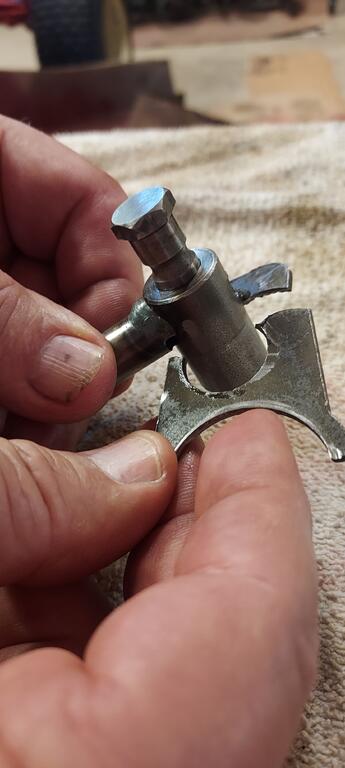

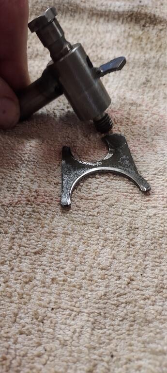

Teddo 56 #45 Posted July 1, 2025 Thanks for the reply stevasaurus. I have it out already and I had to do exactly that. I caught the balls as they came out with the magnet and had to take a drill bit to clean out the channel before being able the get the spring. Easy-peasy. Gee-whiz... who would have thought this was the problem! There it is oliver2-44! 1. Question for you machinists: I have this new shift fork and I was contemplating having it welded on the bottom to keek this from happening again. My machinist friend didn't like the idea because he thinks the heat will take the strength out of the fork, especially if they have heat treated it already. Ideas? 2. There is some very light damage to the top of some gear teeth from someone shifting before fully stopping. It wasn't me!!! I've seen some similar on the forum and the advice has been to carefully file the burrs off and STOP before shifting from now on. Probably MY bad. But I bought it 30 years old. Figured a light 3 point filing should take off any light burrs. Any ideas on that? Now I'm back at it to clean it up and paint her. Any reason to pull out the reduction gear at this point? Everything looks and feels good. Now it's more fun(now that the dang hubs are off). 3 Share this post Link to post Share on other sites

squonk 48,427 #48 Posted July 1, 2025 2 hours ago, Teddo said: Gee-whiz... who would have thought this was the problem! There it is oliver2-44! 1. Question for you machinists: I have this new shift fork and I was contemplating having it welded on the bottom to keek this from happening again. My machinist friend didn't like the idea because he thinks the heat will take the strength out of the fork, especially if they have heat treated it already. Ideas? Weld it. It's all ready broken. "You can't spoil a rotten egg!" 1 1 Share this post Link to post Share on other sites

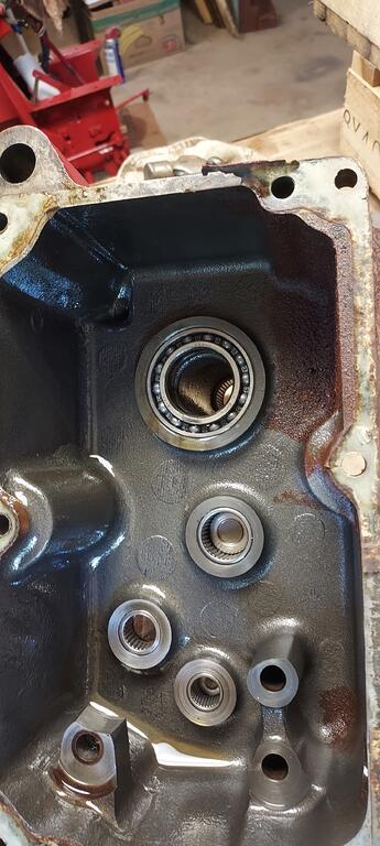

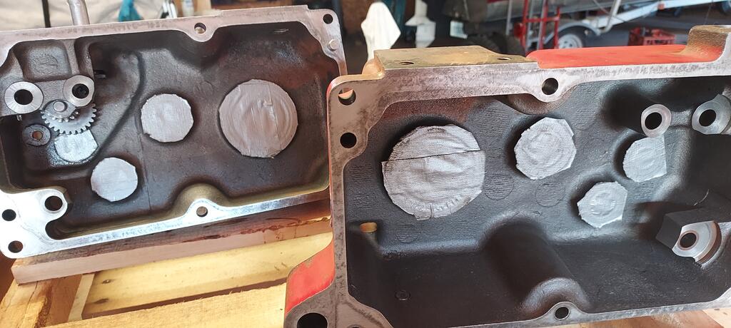

Teddo 56 #49 Posted July 1, 2025 (edited) I am referring to the new shift fork. Oh, for sure I'll have the old one welded for a back-up. That one is a rotten egg! I also discovered that question 2 is moot. There is no damage to gear teeth. I put on my 10x glasses and saw it was made that way. It is the reverse idler gear. I cleaned and taped off the bearings in the case then used a parts brush and cleaner to clean the inside. The outside is ready for paint tomorrow. Everything else is painted and waiting to be put on a running tranny. Edited July 2, 2025 by Teddo add pictures 1 Share this post Link to post Share on other sites
oliver2-44 11,847 #50 Posted July 2, 2025 Question 1: I took a file to a junk Hi/Lo shift fork and I don’t think it has any hardening heat treatment. 4 hours ago, Racinbob said: I much prefer after it's reassembled. Just make sure the shaft is burr free. I don't, but some guys tape over the key slot. I have a little kit assembled with heavy washers for each size shaft. I use a chunk of pvc pipe to seat the seal and the washer assures it's flush with the case. Share this post Link to post Share on other sites
