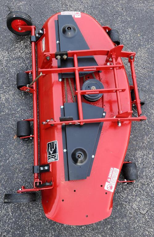

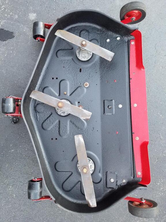

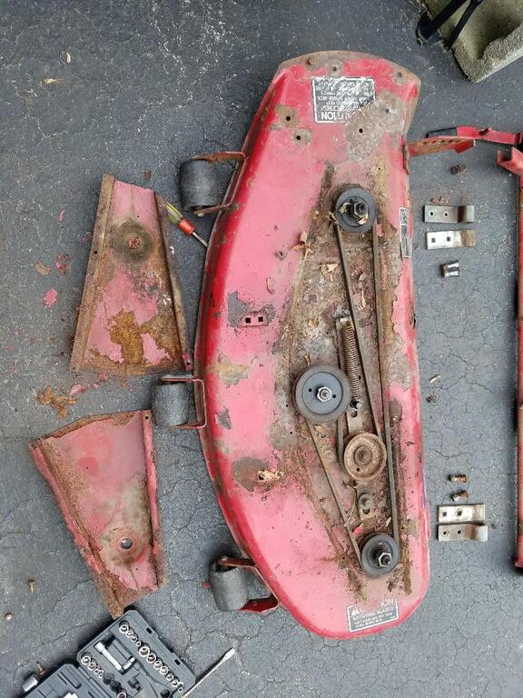

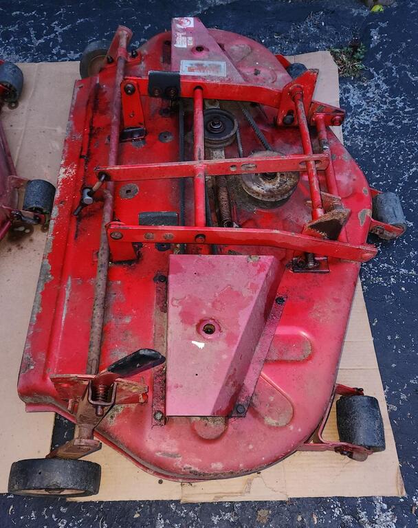

Brockport Bill 2,260 #9 Posted June 10, 2025 if the $ are an issue then here is a suggestion --- if you are patient and you expand your geographic radius beyond your immediate home town area.... and willing to drive a couple hours, then suggest you look for a 50-75 dollar used worn ugly 42 deck -- either sd or rd --- ( I avoid decks with rust through holes ) then do your own rehab to make it a quality functioning long term solution for your 310 - Yes, they can be hard to find but somewhere an estate, or some eager seller, will be found selling one under market $ value -- then it's your labor time.... and maybe some modest cost for its rehab - - but then you have a deck for another 10-20 years - the spindle bearings are 8-10 dollars -- maybe a new pulley torsion bar is needed, or perhaps a $60 dollar pulley or new belt or blades etc.... but many of those expenses are routine maintenance costs for whatever deck you have now -- You can clean off rust with power wire brush attachment or use a 90 degree grinder with a sanding disc ---- Or maybe even spend $100 for sand blasting the deck to bare metal to remove the rust before painting - however, i see those "costs" as not as "net" added expenses but investment in a future tool that lasts for 25-30 mowings per year - here are a couple before and after rehab photos 2 2 Share this post Link to post Share on other sites
Brockport Bill 2,260 #10 Posted June 10, 2025 added note -- i do not just take and randomly spray over rust with can of red paint like some might do -- i remove belt covers - dissemble deck parts and lift carriage assembly - replace spindle bearings or pulleys as necessary - new wheels and/or rollers if needed - often replace with new bolts hardware - sometimes new decals, etc Good luck 1 Share this post Link to post Share on other sites
