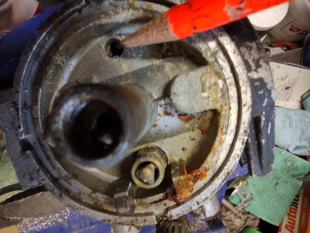

markseven 93 #1 Posted June 10, 2025 My 8 horse Kohler on my garden tractor whenever I hook the fuel pump up to the carburetor like it getting too much fuel it floods and it runs poor it's like the needle is not seating correctly and I put new carburetor kits in it still wants to do it it runs real good when I bypass the fuel pump and just have gravity feed it runs pretty good what's going on. It starts much easier much quicker when the fuel pump is connected. These are original carter carbs I haven't tried a aftermarket one. Share this post Link to post Share on other sites

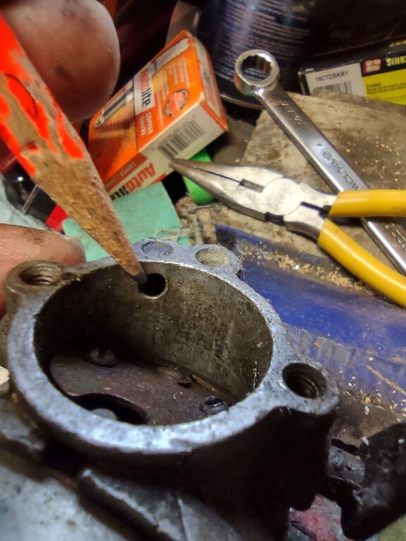

Achto 30,992 #2 Posted June 10, 2025 Check to make sure that this vent hole is clear. If it is not the fuel pump will force gas through the main jet instead of letting vacuum pull it through. It should vent to here. 3 1 Share this post Link to post Share on other sites

markseven 93 #8 Posted June 10, 2025 1 hour ago, WHX?? said: Did you use a orginal Kohler carb kit? In the cheap after market kits the needle and seat do not work. I'm not sure exactly what I use for the carb kit the last time but I have a brand new kohler seat and needle I'm going to try next along with acto I think he's got a very good point too Share this post Link to post Share on other sites
