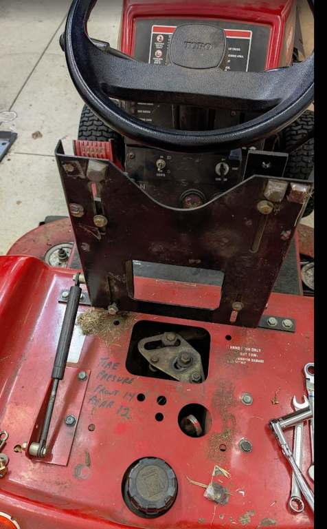

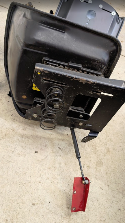

scoob8000 29 #7 Posted June 14 Thanks. I ordered the vevor listed above actually. It caught my eye because the width is adjustable. It came with slides, but they are not as nice as the original ball bearing slides. They are just metal on metal. I haven't fitted it yet, because upon disassembly I found one of my U shaped springs broke. I have a parts tractor I'll rob the seat bracket off of. Both are 1994 models, but my parts tractor is a 416-8. I noticed the seat bracket actualy has coil springs under it and the switch mounted in the bracket. Mounting points seem to be a bit reinforced but should still line up. Guessing this was a newer design possibly? Parts tractor: Original on 416-H Share this post Link to post Share on other sites
nylyon-(Admin) 8,215 #8 Posted June 14 Interesting, both of my 416’s have the U spring, the 8-speed is a 2005. The part on the bracket depresses the switch on the rear pan, with the U brackets, there is an insert in the seat itself for the safety switch. On the Vevor, are the slides removable and still mount up to the Wheel Horse brackets? Share this post Link to post Share on other sites

scoob8000 29 #11 Posted June 15 22 hours ago, nylyon said: Interesting, both of my 416’s have the U spring, the 8-speed is a 2005. The part on the bracket depresses the switch on the rear pan, with the U brackets, there is an insert in the seat itself for the safety switch. On the Vevor, are the slides removable and still mount up to the Wheel Horse brackets? The one with the coils, still has the U springs too. The coils just sit between the fender pan and the seat bracket. Yeah, the slides come off and one of the bolt hole patterns do line up with the U springs. The included hardware is typical Chinese quality though. We'll see how well it holds up. I had a heck of a time getting everything square and sliding easily. I also had to mount the slides upside down from how they were designed. Then had to grind some of the tabs off so I could get the seat on without taking the bracket back off the mower. (it goes on from the front, and obviously the steering wheel is in the way). Share this post Link to post Share on other sites
cleat 7,618 #12 Posted June 15 The coil springs are just for the proper operation of that style of seat switch that yours does not have so you don't need to install those. They offer nothing for seat suspension but just push it up when you get off so the seat switch gets activated. 1 Share this post Link to post Share on other sites
