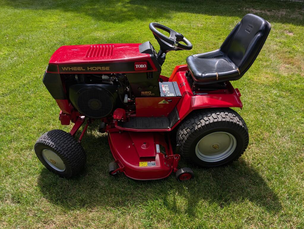

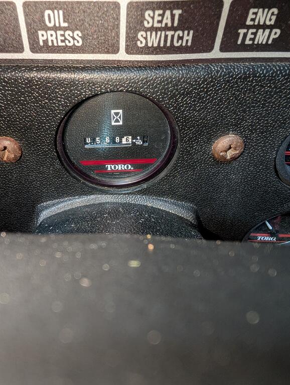

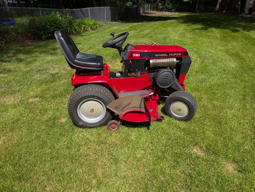

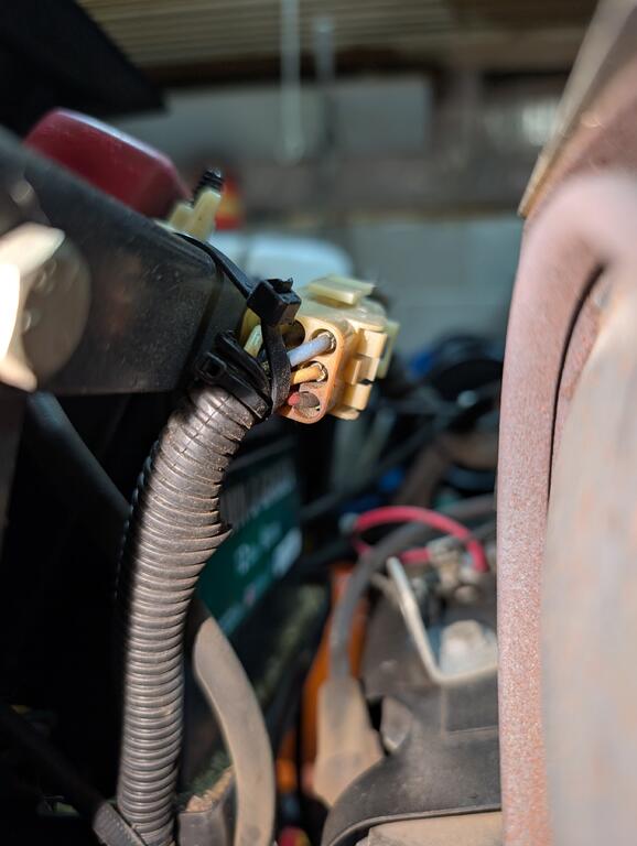

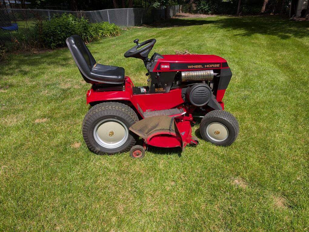

Mn520H 9 #17 Posted June 22, 2025 Here's some photos of the 520H. It cleaned up well. The only problems I noticed is the vacuum gauge doesn't work and the air box sensor had a broken connection that I repaired. I mowed the yard this weekend and it did a great job. The 9 pin is a little discolored, but I haven't noticed any issues yet. 3 Share this post Link to post Share on other sites
lynnmor 8,384 #19 Posted June 22, 2025 9 hours ago, Mn520H said: Notice how the white plastic is turning brown from heat around the red wire? There are two ways to deal with it before the connection completely fails. One is to run a wire of the same gauge around the connector to take the load off the connection. Another is to run an additional wire, with a 30 amp fuse, from the center connection of the voltage regulator to the battery cable connection on the starter. Be sure to unplug and completely clean the contacts in the connector, then apply some No-Ox. Those hours are excellent and should give you many years of service. 2 Share this post Link to post Share on other sites
Mn520H 9 #20 Posted June 22, 2025 Thanks Lynnmor! Is it only the red wire that has too much load? So I only need to bridge that wire out of the 9 pin connection? Share this post Link to post Share on other sites
lynnmor 8,384 #21 Posted June 22, 2025 (edited) 8 hours ago, Mn520H said: Thanks Lynnmor! Is it only the red wire that has too much load? So I only need to bridge that wire out of the 9 pin connection? Correct. Of course any of the wires can be a problem if the connection is very bad. These connectors aren't rated to carry the load of the charging system and all of that is on the red wire. You can clean the red wire connector and leave it in there, then add your jumper around to handle the load. You can get a tool to release the connector from the housing, it is basically a round hollow tube that is pushed down over the connector flattening the latch. Search "connector pin removal tool" on your favorite online stores, any of the moderate priced tools should be OK, the really cheap ones fail due to the cheap metal. When reinstalling the connectors, pry out the latch a bit so it catches as before. I looked at your photo again and see that the connector is cable tied to hold it closer to the muffler than I like, move it away as far as practical. Edited June 22, 2025 by lynnmor additional info 1 Share this post Link to post Share on other sites
Mn520H 9 #22 Posted June 23, 2025 I'll definitely move it away from the muffler. I also picked up the No-Ox you referenced. I like the idea of adding an independent fused 30 amp lead and will need to look into that more. Share this post Link to post Share on other sites
