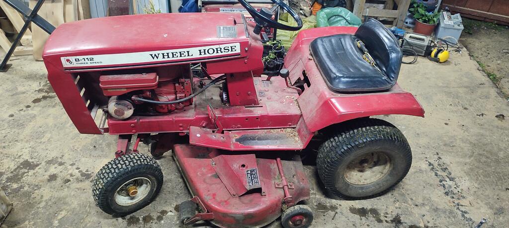

Aleksander 0 #1 Posted June 7 Hi. We have a Wheel Hourse B112 tractor, unfortunately not for the gearbox drive belt. Please help with basic and basic products. Best regards Share this post Link to post Share on other sites

Aleksander 0 #4 Posted June 7 hello again, I bought a belt width 12.5 external length 2235.0 after pressing the clutch the wheel continues to work and it is hard to engage the gear, however in 2nd and 3rd gear the belt slips. please give me some suggestions. best regards Share this post Link to post Share on other sites
Aleksander 0 #5 Posted June 8 I kindly ask for a copy of the drive transmission mechanism, from the engine to the gearbox. Thank you for any information Share this post Link to post Share on other sites
rmaynard 16,699 #6 Posted June 8 Like most other Wheel Horses, the belt cover needs to be installed for the clutch to work properly. Share this post Link to post Share on other sites
Aleksander 0 #7 Posted June 8 Thank you for the tip, do you have any pictures of what it looks like? Share this post Link to post Share on other sites
