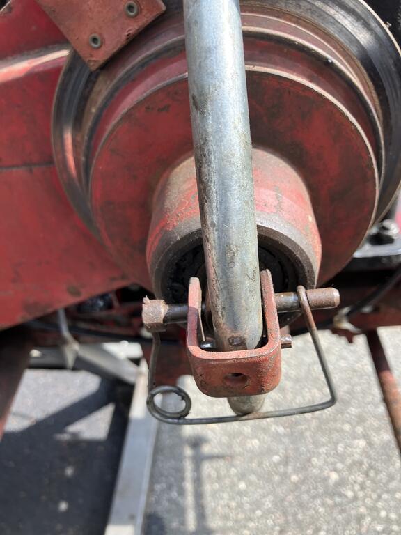

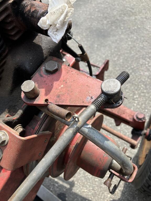

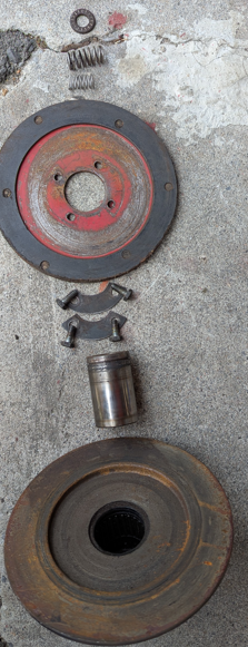

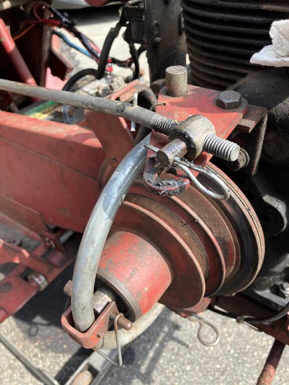

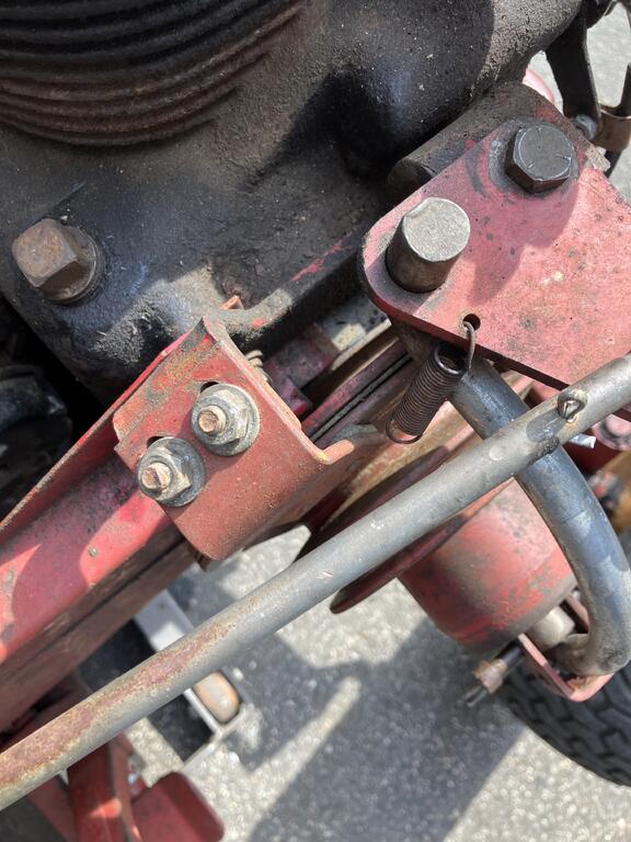

Phan 53 #1 Posted June 4, 2025 Hopefully everyone enjoys spring! I have tried to assemble the PTO of B80 (got two years ago as like the pictures). However, I am unable to figure out where the spring should be (I have two springs), looks like some parts are missing. What is the part number for the flywheel key? Thanks you all for your suggestions! Share this post Link to post Share on other sites
Phan 53 #2 Posted June 4, 2025 I attached a clip. PTO_B80.webm Share this post Link to post Share on other sites
squonk 45,899 #3 Posted June 4, 2025 (edited) They discontinued using the spring. They considered it not needed Edited June 4, 2025 by squonk 3 2 Share this post Link to post Share on other sites
Achto 31,416 #4 Posted June 4, 2025 1 hour ago, Phan said: What is the part number for the flywheel key? The key is just a common 1/4" square key. Most any hardware store should have 1/4" key stock. I buy it in 12" lengths and cut it down to the length that I need. They should have shorter lengths in the Hillman drawers as well. Make sure that your set screw on the pully is in good shape, with a good sharp cup end. If not, I would suggest replacing that too. Also available at most hardware stores. A key is only needed for the pully for the tractor drive belt and should not stick out past the pulley. The clutch disc bolts directly to that pully. The outer bell shaped pulley is free spinning until you engage the PTO forcing it against the clutch disc. 3 1 Share this post Link to post Share on other sites

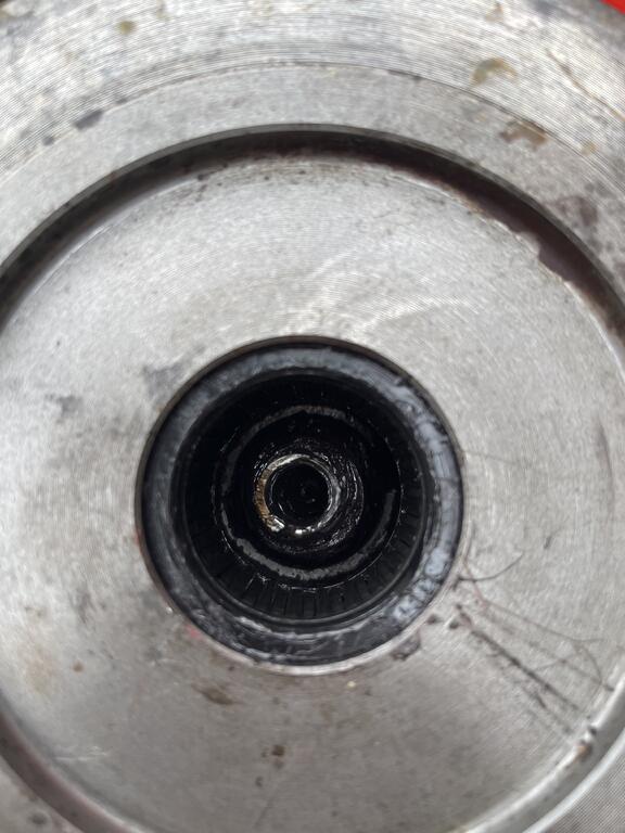

Phan 53 #5 Posted June 5, 2025 I found the key 1/4" at a near me https://www.canadiantire.ca/en/pdp/innoda-square-machine-keys-carbon-steel-1-4-in-3-pk-0565696p.html?rrecName=Frequently Bought Together&rrecReferrer=product&rrecProductId=0565696P&rrecProductSlot=4&rrecSchemeId=product5_rr&rrec=true&_gl=1*q6741u*_up*MQ..*_gs*MQ..&gclid=EAIaIQobChMIwuyhsu3VjQMVOUf_AR3TCxZeEAQYAyABEgKw0fD_BwE&gclsrc=aw.ds&gbraid=0AAAAADojZpgO87JUxQd_wcUBvioDDyc-x I am not sure I get your point - make sure that your set screw on the pully is in good shape, "with a good sharp cup end" - could you please send a picture of it. The set screw and two half-moon dices - I purchased from eBay. Share this post Link to post Share on other sites

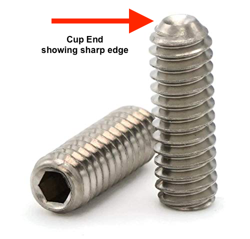

Handy Don 16,111 #6 Posted June 5, 2025 3 hours ago, Phan said: set screw on the pully is in good shape, "with a good sharp cup end" - could you please send a picture of it. 1 Share this post Link to post Share on other sites

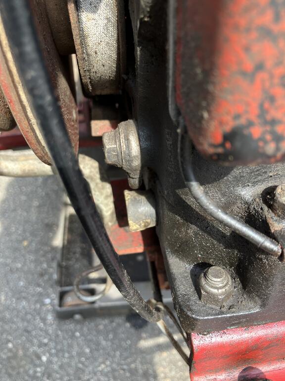

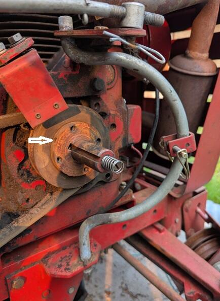

Achto 31,416 #7 Posted June 5, 2025 (edited) There should be a set screw like the one pictured above that holds the drive pully to the crank shaft. It is located right over the key way. White arrow in the pic below shows the location on your tractor. With a key and this set screw tightened down, this pulley will no longer slide in and out on the crank shaft. Edited June 5, 2025 by Achto 3 Share this post Link to post Share on other sites
stvski80085 279 #8 Posted June 6, 2025 (edited) I can get a video of mine tomorrow. I have the exact same setup and I still use the spring. It’s really easy once you see it. You will need the key and set screw if that isn’t on the drive pulley. I also leave the pto brake off. It stops on its own if it’s setup right. steve Edited June 6, 2025 by stvski80085 Share this post Link to post Share on other sites
Phan 53 #9 Posted June 7, 2025 On 6/5/2025 at 12:59 PM, Handy Don said: Thnak you! I help me to understand. I think the set screw is one size? 1 Share this post Link to post Share on other sites
Phan 53 #10 Posted June 7, 2025 On 6/5/2025 at 6:21 PM, Achto said: There should be a set screw like the one pictured above that holds the drive pully to the crank shaft. It is located right over the key way. White arrow in the pic below shows the location on your tractor. With a key and this set screw tightened down, this pulley will no longer slide in and out on the crank shaft. Thank you! It is helpful for me! Share this post Link to post Share on other sites
Phan 53 #11 Posted June 7, 2025 On 6/5/2025 at 9:55 PM, stvski80085 said: I can get a video of mine tomorrow. I have the exact same setup and I still use the spring. It’s really easy once you see it. You will need the key and set screw if that isn’t on the drive pulley. I also leave the pto brake off. It stops on its own if it’s setup right. steve Appreciate your sending the video. I don't think there is a video available in the forum or YouTube. Share this post Link to post Share on other sites
stvski80085 279 #12 Posted June 7, 2025 I will try to get one today. Steve Share this post Link to post Share on other sites
stvski80085 279 #13 Posted June 8, 2025 I will try to get it tomorrow. Was too busy today. steve Share this post Link to post Share on other sites
stvski80085 279 #14 Posted June 8, 2025 (edited) Ok gonna upload soon. This was quick and not planned out. It was getting ready to rain. I can send you my number if you have more questions.video coming shortly. steve IMG_1540.mov IMG_1541.mov Edited June 8, 2025 by stvski80085 2 Share this post Link to post Share on other sites
stvski80085 279 #15 Posted June 8, 2025 First time uploading video. Hope it works out. Remember this is the setup after you get the key way in and locked down. steve Share this post Link to post Share on other sites

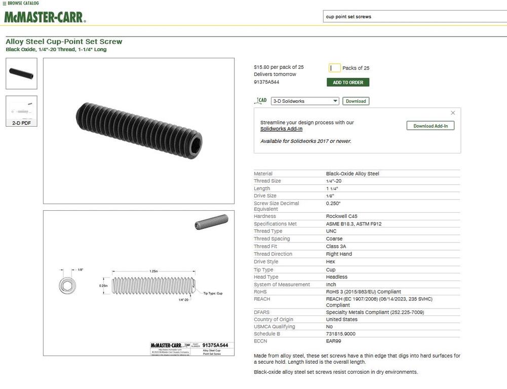

Phan 53 #19 Posted June 10, 2025 Hi Paul - Thank you! for your post the detail of the screw set 1/4"-20 x 1-1/4" - I found as the same https://www.amazon.ca/Socket-Screws-Stainless-Quantity-Fastenere/dp/B019HT9C9Y Share this post Link to post Share on other sites

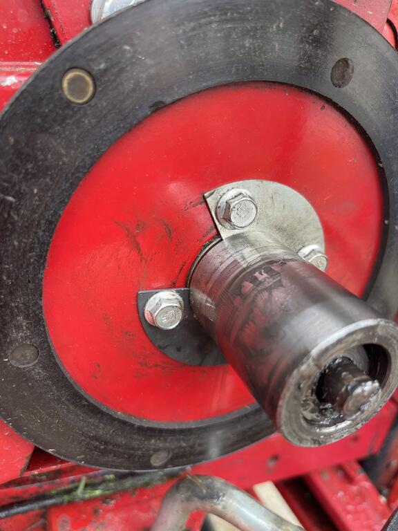

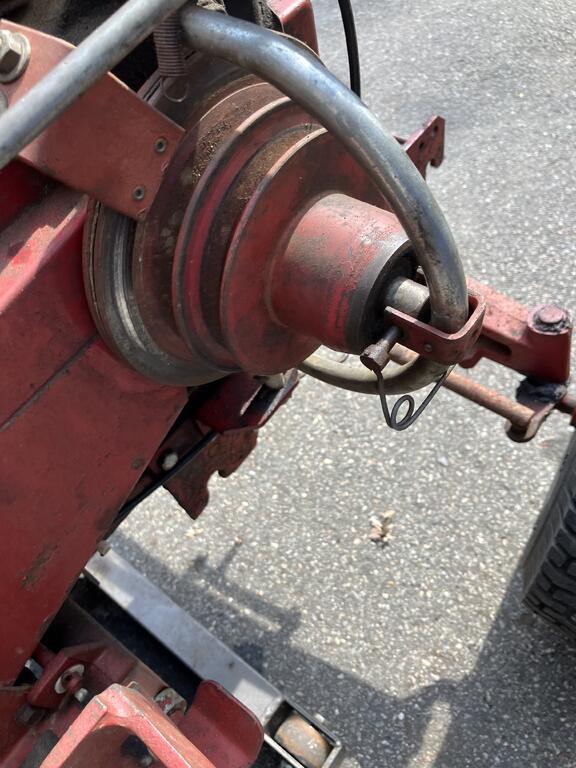

Retired Wrencher 6,539 #20 Posted June 12, 2025 (edited) @Phan how a bought these for the rest of it. Always a little tricky putting this all back together if you not done many. I can be a head scratcher if not familiar with it. This is a 1977 B-80 I have. Been doing a lot of work on it. My winter plow tractor. Enjoy yours when done. Edited June 12, 2025 by Retired Wrencher 1 Share this post Link to post Share on other sites
