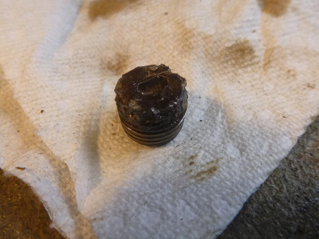

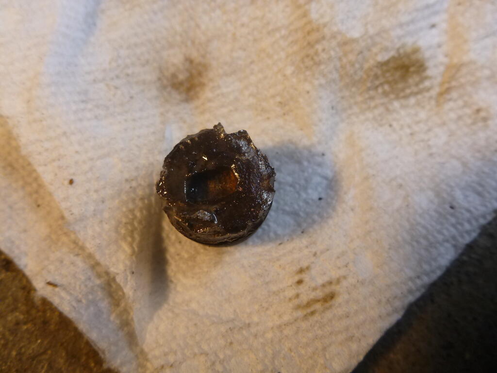

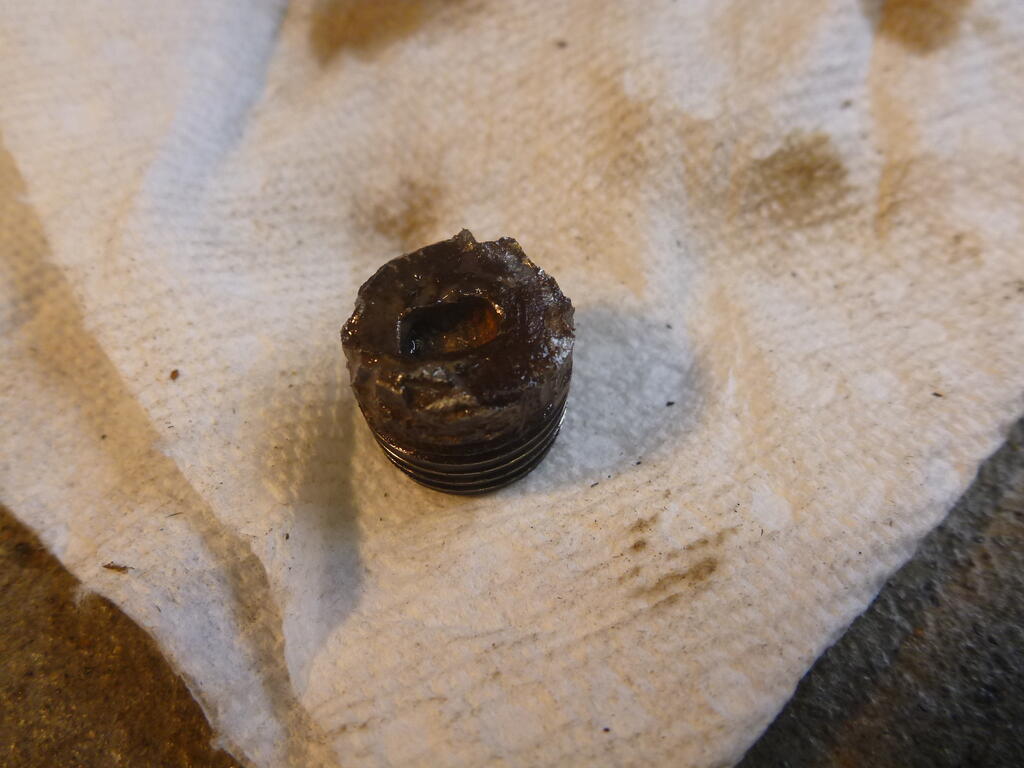

CS-17 14 #26 Posted June 5, 2025 Also, The previous owner boogied up the drain plug. Any idea where to find a new one? Share this post Link to post Share on other sites
Ed Kennell 45,043 #27 Posted June 5, 2025 2 hours ago, CS-17 said: Any idea where to find a new one? Any hardware store. 1 Share this post Link to post Share on other sites
WHX?? 55,257 #28 Posted June 5, 2025 1/4" NPT pipe plug. A square head one will work just fine. I would flush it. Quart 1/2 of diesel. Ride around drain. Repeat as necessary. Refill with 80/90 gesr oil. 1 Share this post Link to post Share on other sites
