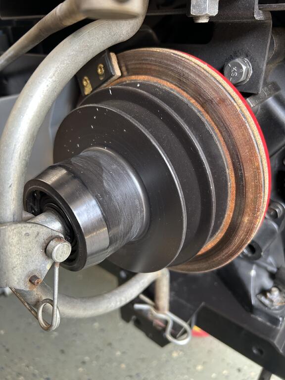

Bill D 2,701 #10 Posted May 31, 2025 (edited) 3 hours ago, gwest_ca said: You have a thrust bearing between the transmission drive pulley and the engine block also. I have a GT1642 and a GT1800. Neither one has a thrust bearing. Here's a picture of the GT1800. Verify if you have a thrust bearing. If not, my money's on the PTO bearing. Edited May 31, 2025 by Bill D 2 Share this post Link to post Share on other sites

cleat 8,879 #12 Posted June 1, 2025 2 hours ago, Bill D said: I have a GT1642 and a GT1800. Neither one has a thrust bearing. Here's a picture of the GT1800. Verify if you have a thrust bearing. If not, my money's on the PTO bearing. Only the Briggs single cyl has the thrust bearing. However, as seen in the above picture, the main pulley does sit close to the engine block. Make sure you have clearance there and that the pulley is tight on the crankshaft and is not getting pushed into the engine block as the PTO is engaged. If you engage the PTO with the engine off you can also verify that the engine can turn over easily by hand (by rotating the PTO pulley). If the engine turns easily by hand then maybe there is a safety switch issue. 2 1 Share this post Link to post Share on other sites
Bill D 2,701 #13 Posted June 1, 2025 (edited) 3 hours ago, cleat said: Only the Briggs single cyl has the thrust bearing. However, as seen in the above picture, the main pulley does sit close to the engine block. Make sure you have clearance there and that the pulley is tight on the crankshaft and is not getting pushed into the engine block as the PTO is engaged. If you engage the PTO with the engine off you can also verify that the engine can turn over easily by hand (by rotating the PTO pulley). If the engine turns easily by hand then maybe there is a safety switch issue. According to Gary's TSB there are some early models that had external thrust bearings. I have a hydro pulley from a C161 that is machined for that external thrust bearing. Apparently the early Briggs twins did not have ball bearing supported crankshafts. Edited June 1, 2025 by Bill D Additional clarity 2 Share this post Link to post Share on other sites

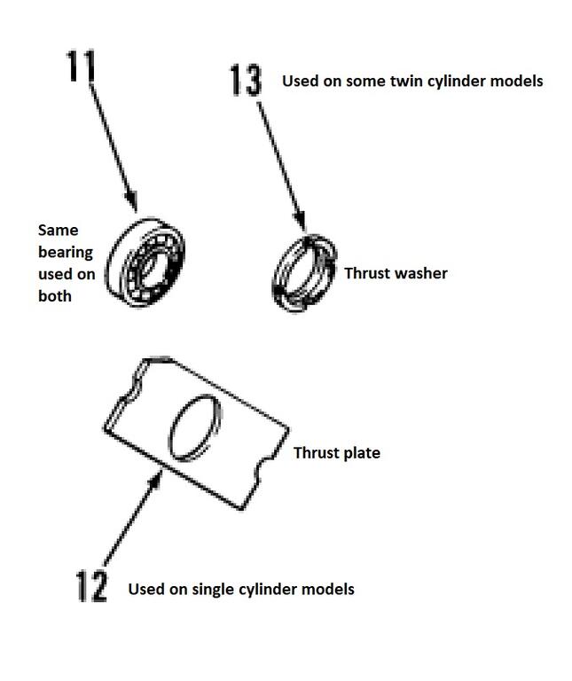

gwest_ca-(File Mod) 12,092 #16 Posted June 1, 2025 Have never seen either but found this in an original parts list 2 1 Share this post Link to post Share on other sites
Bill D 2,701 #17 Posted June 1, 2025 6 hours ago, gwest_ca said: Have never seen either but found this in an original parts list I have actually seen both. A neighbor has a GT100 that I service. I recently picked up a C161 8 speed for its engine. Someone had swapped an 1997 18 HP Briggs into it. All of the original thrust bearing pieces were swapped as well. Only time I've seen that on a twin. 1 Share this post Link to post Share on other sites
