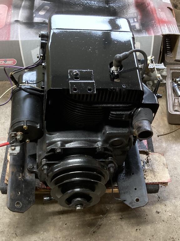

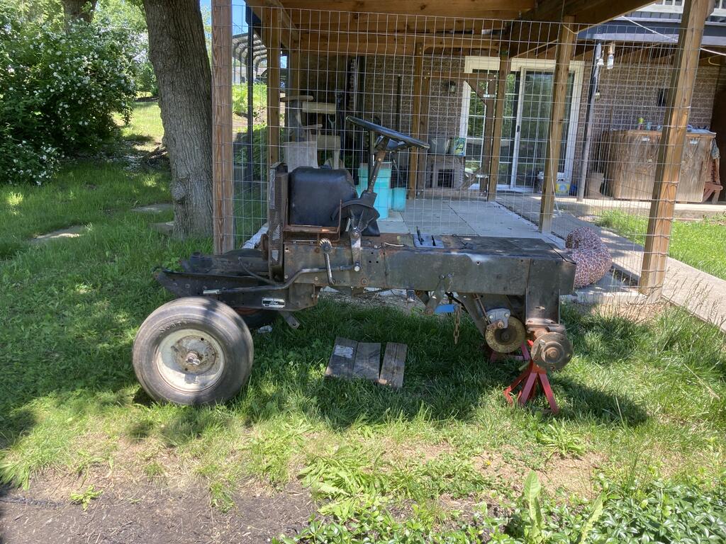

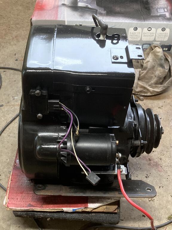

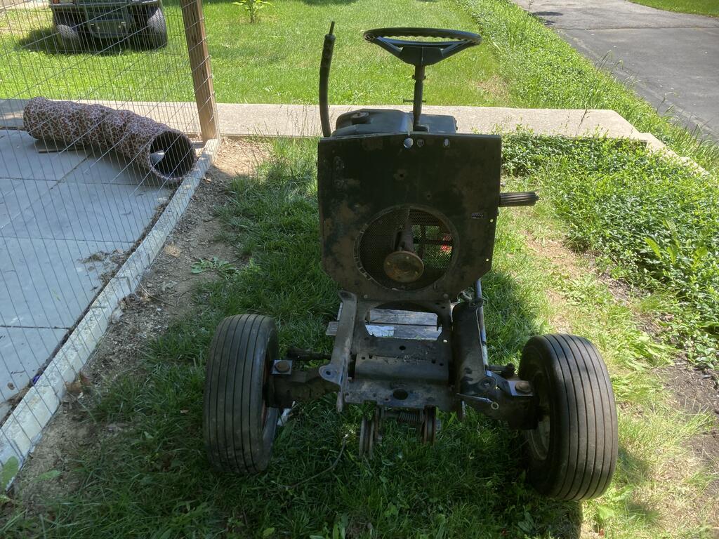

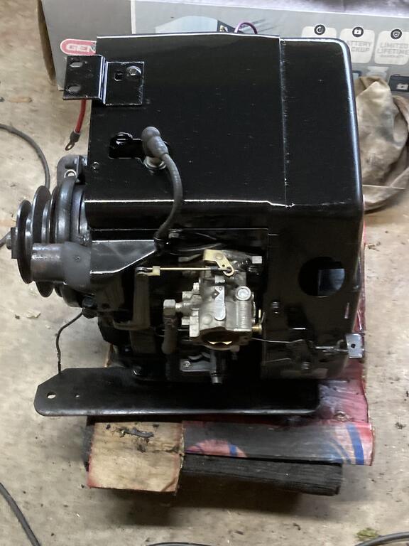

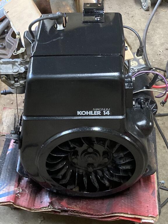

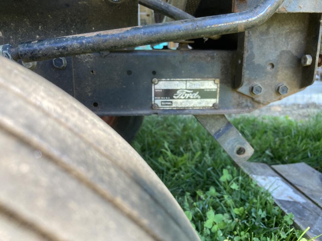

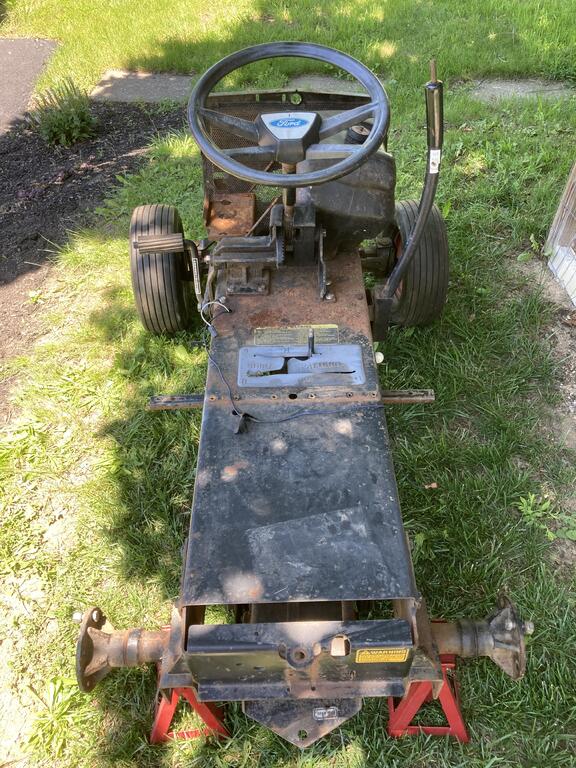

"Manic-Mechanic" 1,485 #1 Posted May 28, 2025 (edited) I originally planned to buy the engine (M14), however it was still attached to the frame! Then the owner informed me there was what remained of the tractor in a pull cart! All for 50! So after separating the frame and getting it loaded up on the old Dodge, (no wheels), I get ‘r home. Now it sits with a pair of old Sears front wheels and Jack stands in the rear. Yes, I am now inclined to fix this one! A basic clean up of the carb, a starter (which was on the shelf new) and letting oil soup outta the block, I fired it up on carb cleaner. To my amazement it lives! About 7 bolts later I will be able to move it around. Engine off and awaiting isolaters! I know everyone has seen M14 but had to post pictures! Yes, the sickness sets in, already looking for the brinley and it isn’t even moving on it’s own! Edited May 28, 2025 by "Manic-Mechanic" 2 4 Share this post Link to post Share on other sites

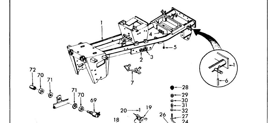

Achto 31,792 #2 Posted May 28, 2025 Luckily the engine that you wanted was in a newer Ford chassis. In some of the older Fords with Kohler K models, the engine oil pan was actually part of the chassis. 2 Share this post Link to post Share on other sites
"Manic-Mechanic" 1,485 #3 Posted May 28, 2025 (edited) 59 minutes ago, Achto said: Luckily the engine that you wanted was in a newer Ford chassis. In some of the older Fords with Kohler K models, the engine oil pan was actually part of the chassis. That would’ve been a first for me! Really scratching my head then! I have a Snapper/Massey 1650 which has a K341, now I want to have a closer look at that as the isolators are due Edited May 28, 2025 by "Manic-Mechanic" 1 Share this post Link to post Share on other sites
Achto 31,792 #4 Posted May 28, 2025 2 hours ago, "Manic-Mechanic" said: That would’ve been a first for me! Ford LGT 120 diagram showing the oil pan as part of the frame. The oil pan also has a hole through it for the front axle pin. 1 Share this post Link to post Share on other sites
"Manic-Mechanic" 1,485 #5 Posted May 29, 2025 (edited) 7 hours ago, Achto said: Ford LGT 120 diagram showing the oil pan as part of the frame. The oil pan also has a hole through it for the front axle pin. Wow! That’s crazy! Talk about proprietary Actually, an easy engine swap tho’ Edited May 29, 2025 by "Manic-Mechanic" 1 Share this post Link to post Share on other sites
