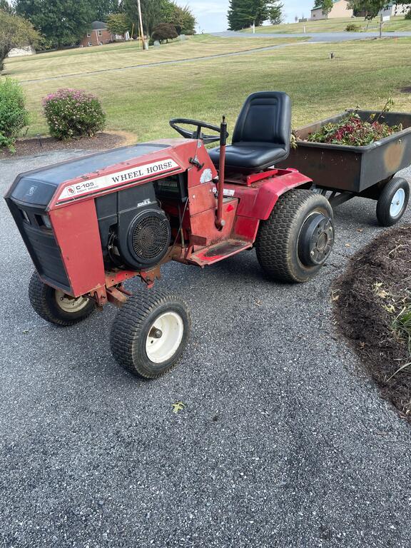

Sodaking27 1,108 #4 Posted May 26, 2025 I transplanted one into my C105 several years ago. Great running engine. 3 Share this post Link to post Share on other sites
