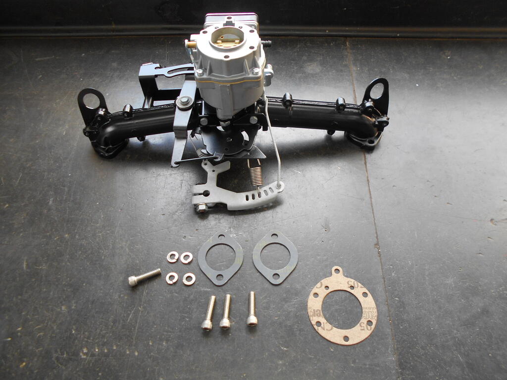

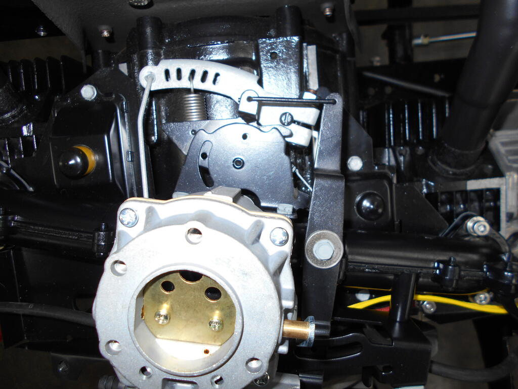

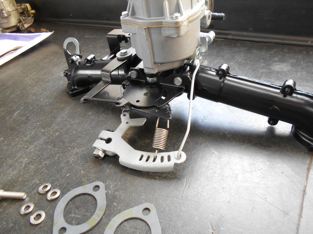

cleat 7,243 #4 Posted May 27 This is my GT1600 carb and governor assembly as I was rebuilding it last winter. 1 Share this post Link to post Share on other sites
wind77west 14 #5 Posted May 28 Thanks, the pictures really help. As the old sayings goes "A pictures is worth a 1k words" 1 Share this post Link to post Share on other sites
