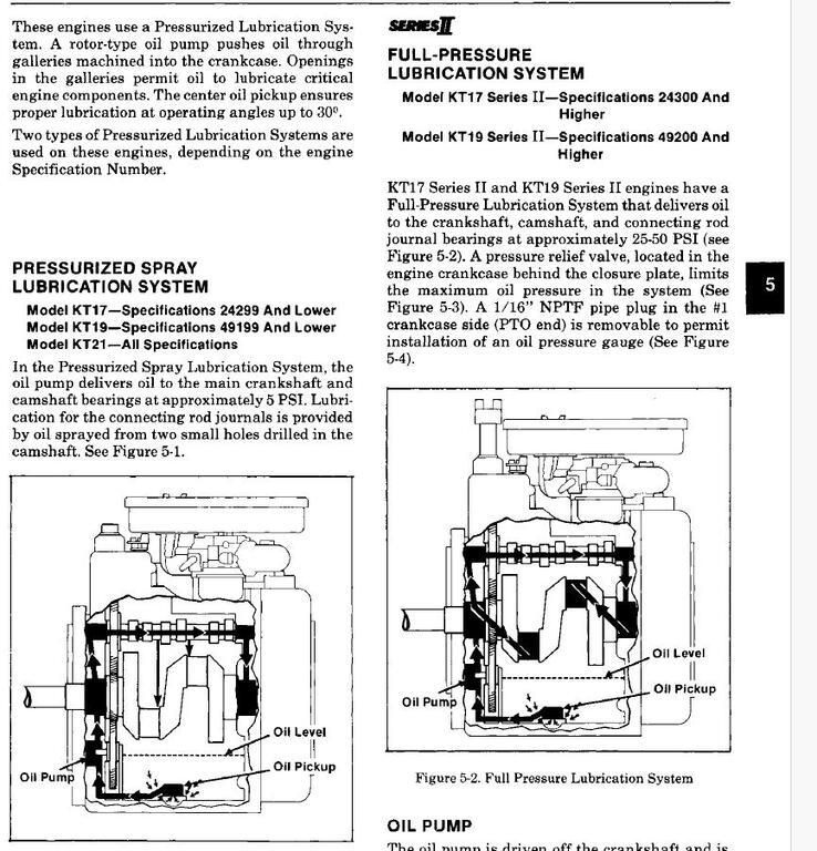

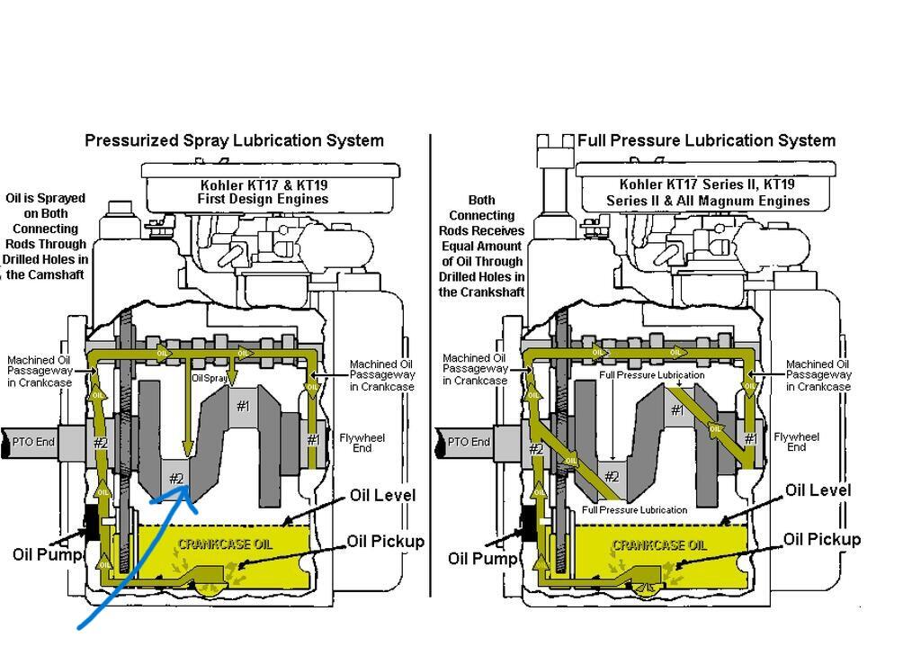

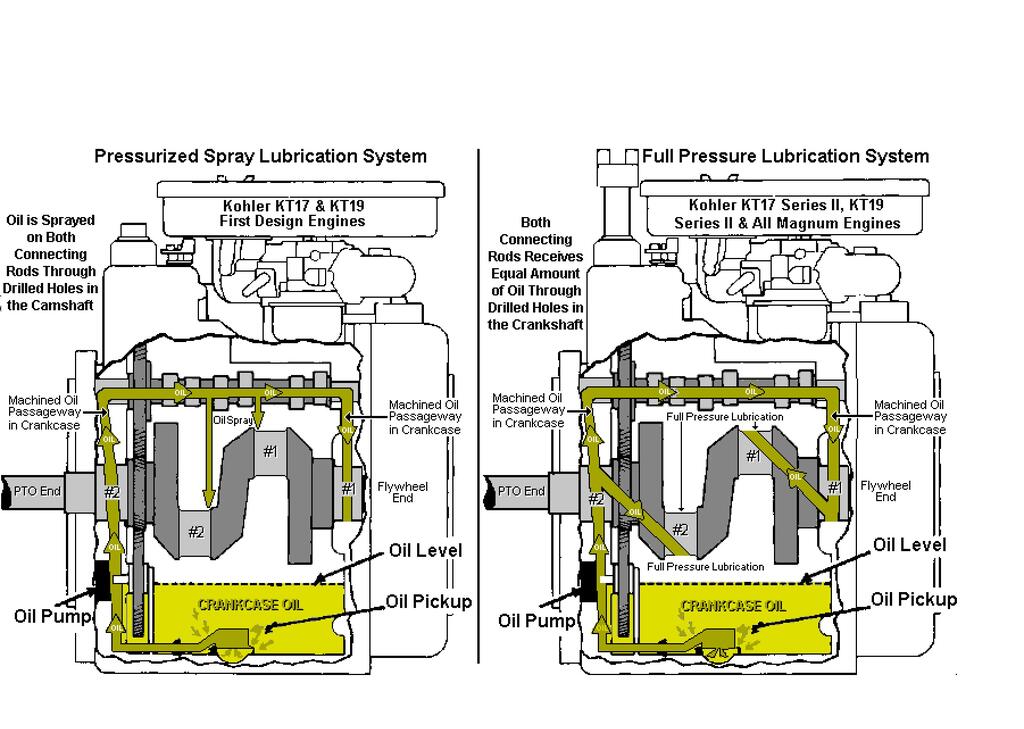

953 nut 62,151 #6 Posted May 26 24 minutes ago, Ed Kennell said: So, the series 1 and 2 both have oil pumps? So what is different? Though the series 1 has a pressurized lubrication system it was a lower pressure and drip lubrication to the rod bearings was inadequate if the engine was tilted where the oil didn't get to the rods. 1 1 2 Share this post Link to post Share on other sites
Ed Kennell 43,096 #7 Posted May 26 Thanks for the pictures Richard. I never knew the series 1 had an oil pump. It is clear the series 2 pressurized bearing oil is better, but I don't see how the oil spray system on the series 1 would be less effective on a slope. This is assuming the oil level is high enough to cover the pump, but this would be the same problem for the series 1 and 2. Share this post Link to post Share on other sites
pfrederi 18,969 #8 Posted May 26 (edited) If you tilt the engine maybe the spray/drip doesn't hit the seam/gap between the rod and the crank?? Depending on the spray/drip pattern it only hits at top and bottom of the stroke Edited May 26 by pfrederi 1 Share this post Link to post Share on other sites
pfrederi 18,969 #9 Posted May 26 Big difference in oil pressure may have an impact. 1 1 Share this post Link to post Share on other sites
