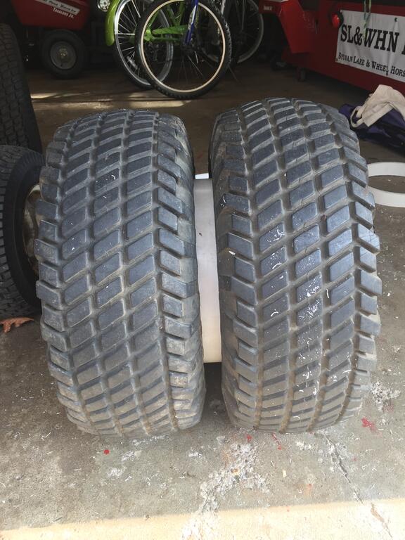

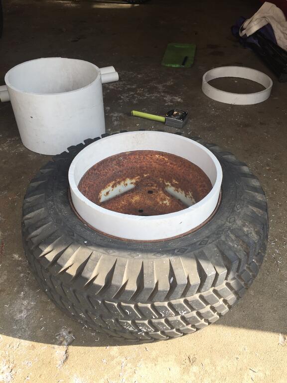

SylvanLakeWH
6 minutes ago, Achto said:
Dual wheels can be added using a kit like the picture below. Plus another set of rims and tires.
Image result for wheel horse dual wheel adapters
You can also just cut 12" pvc pipe and use regular bolts like this:
  • Excellent 1
