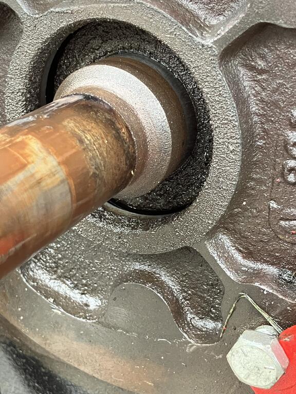

Oily Charger 10 3 #1 Posted May 25, 2025 I was running the engine on my wheel horse charger 10 when suddenly it started to fling a little oil everywhere around the pto side of the engine. I am certain just the seal went bad and its not much of an issue. Even with the large oil leak the engine didn't seem to care and would run normally (I did not run the engine long after the oil leak). I am just wondering if I can use the pto oil seal from the kohler magnum MV16 for my M16. I can't seem to find a seal for my Kohler magnum M16 anywhere. I am aware that the MV16 is the Vertical shaft version of my M16. What can I do to get my wheel horse back to normal? I can provide pictures. Share this post Link to post Share on other sites

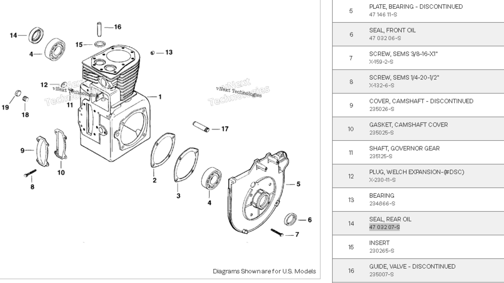

JoeM 9,619 #2 Posted May 25, 2025 4703207s Oil seals look like they are available ebay and other sites. 1 Share this post Link to post Share on other sites
Achto 30,993 #3 Posted May 25, 2025 OEM https://www.amazon.com/Kohler-47-032-07-S-Original-Equipment-Manufacturer/dp/B000P7QMZ0 Aftermarket https://www.amazon.com/Seal-Fits-Kohler-Replaces-47-032-07-S/dp/B0CCJYMYQH/ref=pd_lpo_d_sccl_2/144-6861698-7789920?pd_rd_w=MJQ9w&content-id=amzn1.sym.4c8c52db-06f8-4e42-8e56-912796f2ea6c&pf_rd_p=4c8c52db-06f8-4e42-8e56-912796f2ea6c&pf_rd_r=3Y1WN917JF5MCS1CQV8X&pd_rd_wg=7XEN5&pd_rd_r=2b50852d-1830-47c7-87f8-3f69c1339b46&pd_rd_i=B0CCJYMYQH&psc=1 1 1 Share this post Link to post Share on other sites
pfrederi 19,875 #4 Posted May 25, 2025 Part number for MV16 seal is different than M16 2 Share this post Link to post Share on other sites
oliver2-44 11,212 #5 Posted May 25, 2025 Looks like the guys have you fixed up. May I suggest you remove the PTO, then run it to confirm the location of the oil leak. Tell us a little about yourself and your Horse 3 Share this post Link to post Share on other sites
Oily Charger 10 3 #6 Posted May 25, 2025 Wow! Thanks for the help guys! I can confirm that it the oil seal went bad… It just went backwards for some reason. I could just put it back but ima replace because it’s probably original. 1 Share this post Link to post Share on other sites
