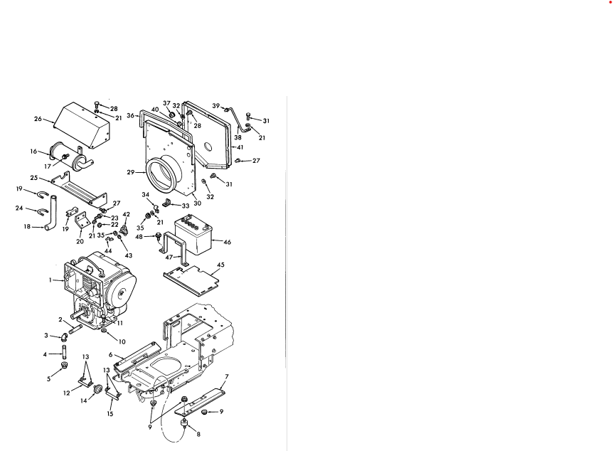

"Manic-Mechanic" 1,485 #1 Posted May 24, 2025 I have a wonderful M14 off a Ford/New Holland LGT14 Thing is it has a weird combination of sump & block which I would like to change Can a regular oil sump be installed on this block, along with the dipper of course! Share this post Link to post Share on other sites
oliver2-44 11,212 #2 Posted May 24, 2025 That Ford LGT145 uses a narrow big block. wheel Horse C Series 1975 and later used the narrow block. There is a thread pinned under the Engines sections that’s discusses blocks and oil pans Share this post Link to post Share on other sites
"Manic-Mechanic" 1,485 #3 Posted May 24, 2025 (edited) I'll take that as a simple, "yes”. i know the parts are interchangeable between K & M series, but the flange on the M14 block through me. I started to search for the pinned post but not making much headway, there’s over 300 posts! Thanks Edited May 24, 2025 by "Manic-Mechanic" Share this post Link to post Share on other sites
squonk 45,502 #4 Posted May 24, 2025 4 hours ago, "Manic-Mechanic" said: I'll take that as a simple, "yes”. i know the parts are interchangeable between K & M series, but the flange on the M14 block through me. I started to search for the pinned post but not making much headway, there’s over 300 posts! Thanks 2 Share this post Link to post Share on other sites
953 nut 64,110 #5 Posted May 24, 2025 Just get the shaker plate mounts from a Wheel Horse (1978 to 1984) that used a K-xxxAS engine and use the pan that is on the M14AQS engine. 2 Share this post Link to post Share on other sites
"Manic-Mechanic" 1,485 #6 Posted May 24, 2025 48 minutes ago, 953 nut said: Just get the shaker plate mounts from a Wheel Horse (1978 to 1984) that used a K-xxxAS engine and use the pan that is on the M14AQS engine. I could do that but trying to re-power a Sears ST, no room 1 Share this post Link to post Share on other sites
"Manic-Mechanic" 1,485 #7 Posted May 24, 2025 5 hours ago, squonk said: Ah, there she be! Thank you ever so much! Share this post Link to post Share on other sites
