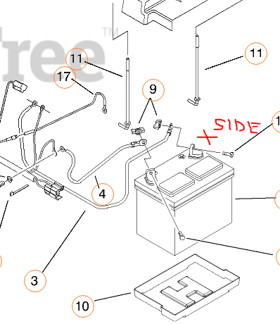

rivahmon 2 #1 Posted May 23 I am trying to help a friend remotely with a new battery for the 520Xi. Is it left or right positive? Share this post Link to post Share on other sites
953 nut 62,969 #2 Posted May 23 7 hours ago, rivahmon said: Is it left or right positive? That depends on the battery. Most group sizes can be purchased with the positive on the left or right .There should be a "+" marked near the positive terminal. Share this post Link to post Share on other sites
Ed Kennell 43,754 #3 Posted May 23 to the I don't have an XI, but someone should be here soon to answer your battery post question. Share this post Link to post Share on other sites
JoeM 9,298 #4 Posted May 23 the parts breakdown show positive on the right side with the terminals away from you. I have had them were people reversed the orientation, best to take a pic when getting a battery. most place always have both. 1 Share this post Link to post Share on other sites
ri702bill 10,556 #5 Posted May 23 And... there is a model number, like U1 or U1R, on the battery you already have. 1 hour ago, JoeM said: positive on the right side with the terminals away from you. 1 Share this post Link to post Share on other sites
953 nut 62,969 #6 Posted May 23 8 hours ago, ri702bill said: And... there is a model number, like U1 or U1R, on the battery you already have. Terminal location on the U1 are opposite that of the U1R. Can't go by left or right, go by the "+" marked on the battery. The "+" goes to the battery cable that is NOT grounded. 1 Share this post Link to post Share on other sites
