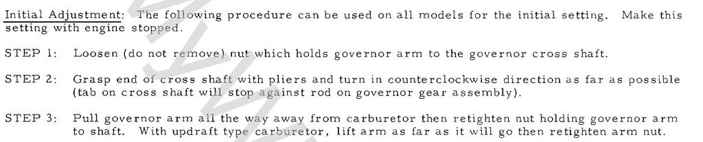

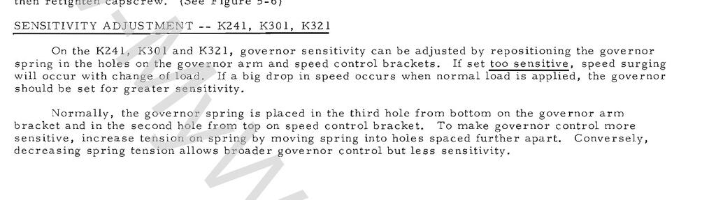

pfrederi 19,278 #2 Posted May 19 Have you tried adjusting high speed mixture too lean can cause surging Governor initial set and sensitivity 2 Share this post Link to post Share on other sites
