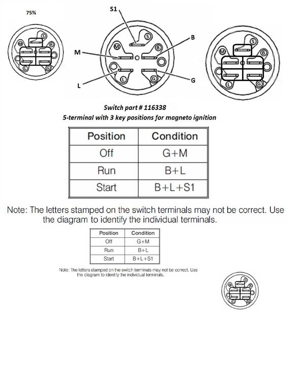

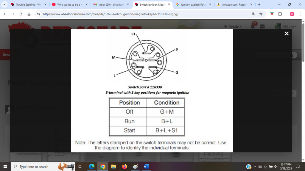

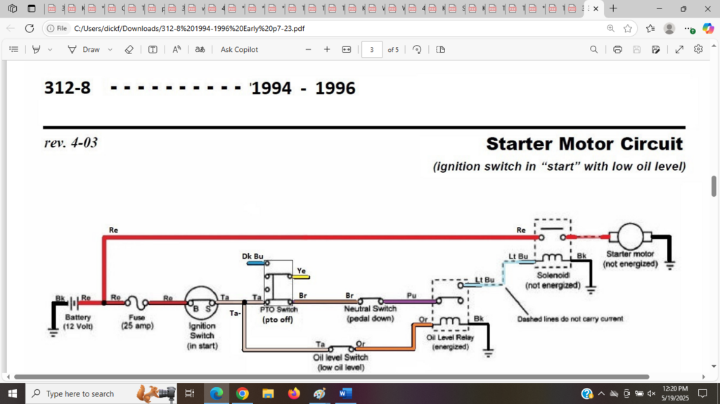

953 nut 62,969 #3 Posted May 19 Please don't buy any more parts until we find out what is actually wrong, looking at the ignition switch you have ordered I see that it IS NOT correct for your 312.Not all Wheel Horses are wired alike. You ordered one for a battery ignition system and your 312 has a magneto ignition. The correct switch is shown below. This wiring diagram shows all of the components in the START circuit. Check the level of your engine oil, if it is low a relay will stop the starter from operating. Beginning at the left you should check the 25 amp fuse and fuse holder. Check to see if you have voltage at the B terminal of your ignition swatch. With your PTO disengaged and your clutch pedal depressed when you turn the key there should be 12 volts at the small blue wire on the Solenoid. Do these checks and let us know what you find. 3 1 Share this post Link to post Share on other sites

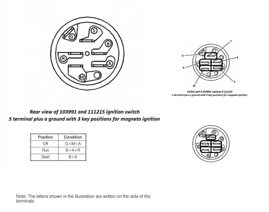

gwest_ca-(File Mod) 11,838 #5 Posted May 19 The 73362 calls for this ignition switch 116338. The Rotary 7280 replaces switch 103991. Not sure it will work without changes 1 Share this post Link to post Share on other sites
953 nut 62,969 #6 Posted May 19 16 minutes ago, gwest_ca said: Not sure it will work without changes It will not work without otherwise unnecessary wiring alterations. 1 Share this post Link to post Share on other sites
