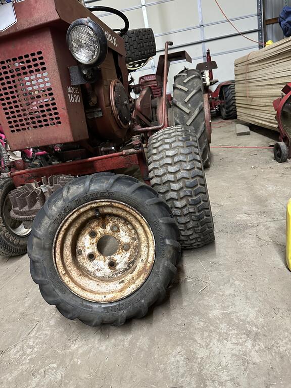

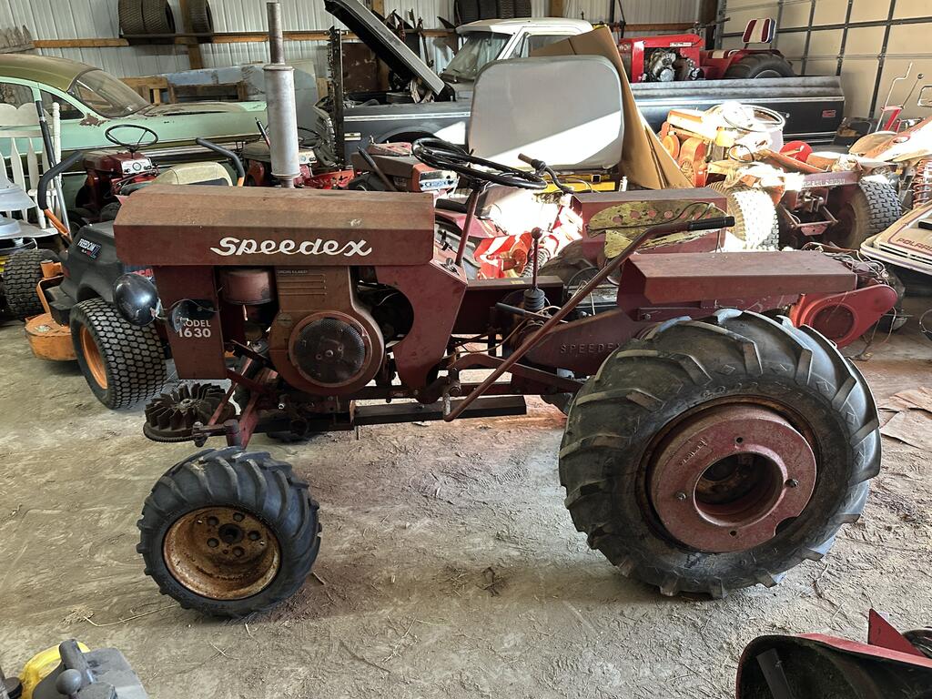

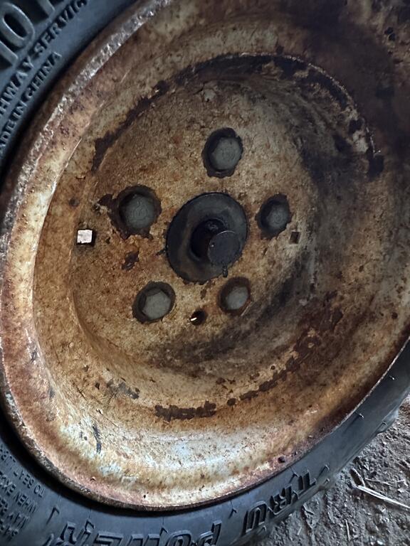

Pullstart 70,985 #59 Posted November 4, 2025 Commando 800 10” rear wheels and matching 1” hubs fit pretty alright! I’ll need to add a grease zerk and proper shims for the cotter pin but it rolls nice in the barn at least! Share this post Link to post Share on other sites

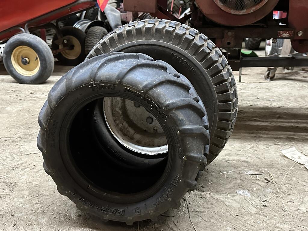

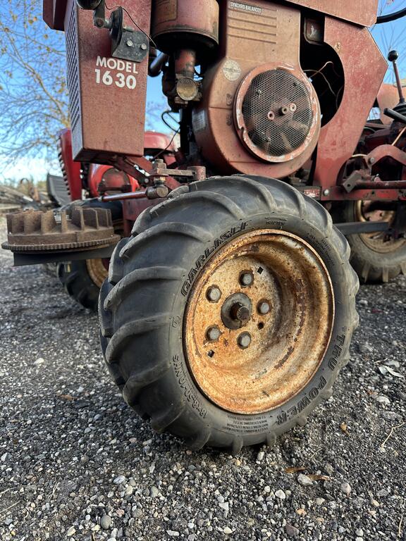

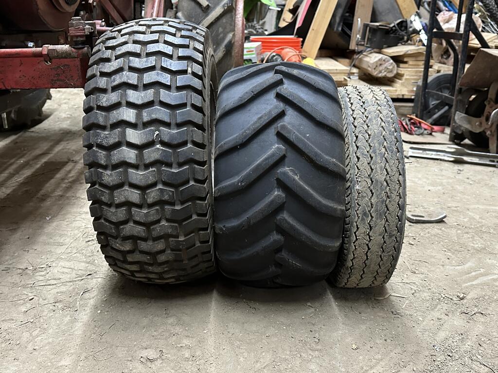

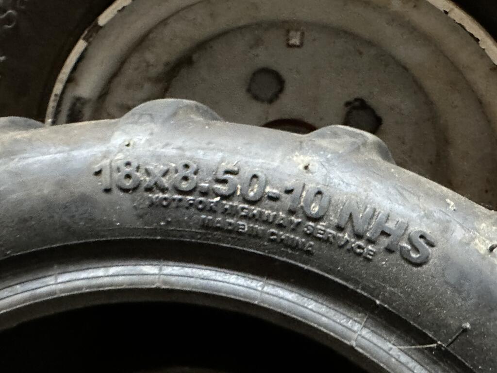

Pullstart 70,985 #60 Posted November 4, 2025 I have these Carlisle 18” tires for a 10” wheel. They should work well mounted backwards! 1 Share this post Link to post Share on other sites

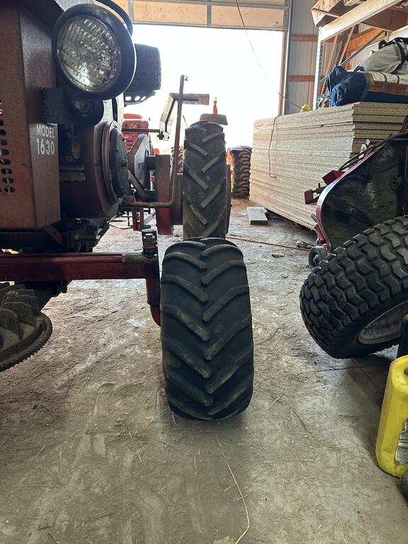

Pullstart 70,985 #61 Posted November 4, 2025 Honestly, I might not even need to flip the axle, this would give the tractor a bit of caster to help with steering as well. 1 Share this post Link to post Share on other sites

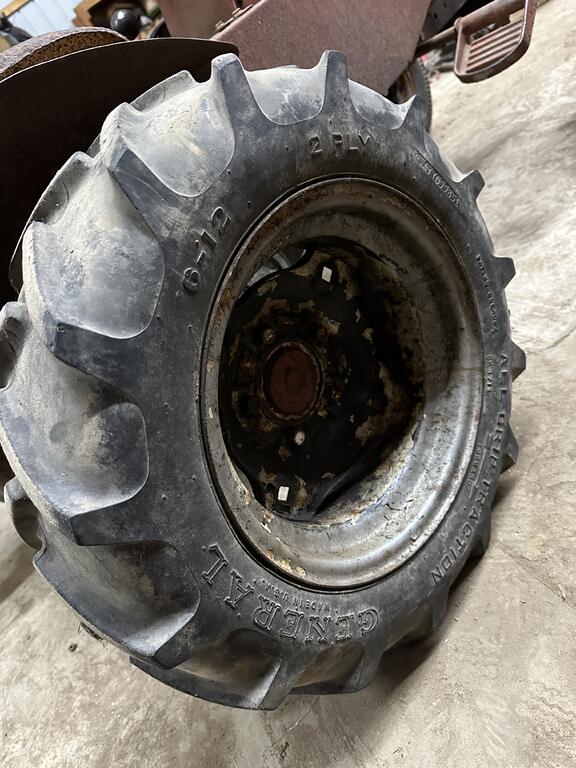

Pullstart 70,985 #62 Posted November 4, 2025 If I want even more tire height, I can run a 6-12 and flip the axle like we discussed previously. 1 Share this post Link to post Share on other sites

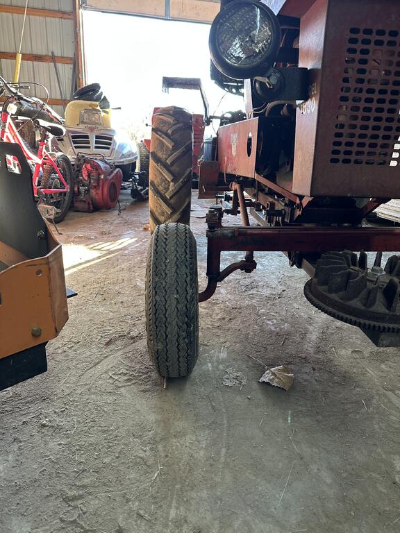

Streetrodchev 1,165 #63 Posted November 4, 2025 (edited) I think it would look great with a set of 4.00/12 3 ribs on the front, to go with the tall & skinny rears. Edited November 4, 2025 by Streetrodchev 1 Share this post Link to post Share on other sites
Razorback 1,370 #64 Posted November 4, 2025 (edited) I looked at the info I had in my notepad for my Speedex 1631 and see that the front tires on mine are 4.00x12 F2 tri-ribs..... good call, @Streetrodchev Edited November 4, 2025 by Razorback 2 Share this post Link to post Share on other sites
Pullstart 70,985 #65 Posted November 4, 2025 3 hours ago, Streetrodchev said: I think it would look great with a set of 4.00/12 3 ribs on the front, to go with the tall & skinny rears. you know me, always using what I have in stock 3 Share this post Link to post Share on other sites

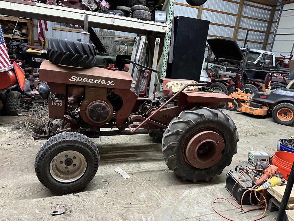

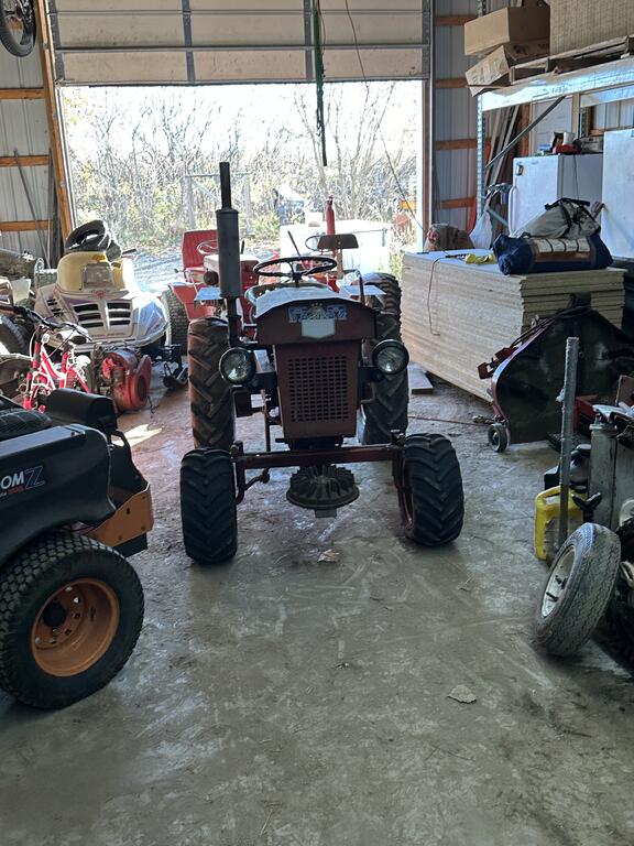

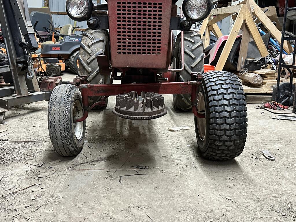

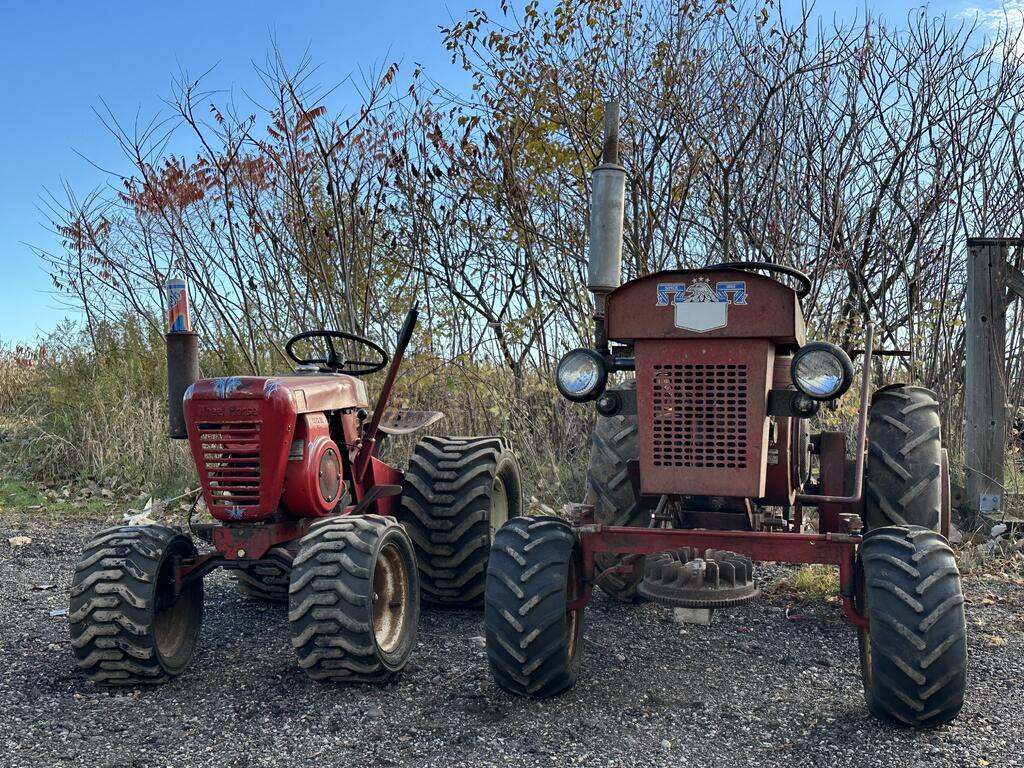

Pullstart 70,985 #66 Posted November 4, 2025 I don’t mind the track width. Looks four wheel drive now! Maybe three wheel for now… 1 Share this post Link to post Share on other sites
Pullstart 70,985 #67 Posted November 4, 2025 Right or wrong, I kind of love it! 1 1 Share this post Link to post Share on other sites
Pullstart 70,985 #68 Posted November 4, 2025 They look way better than the 4-8’s if you ask me! 1 Share this post Link to post Share on other sites
Pullstart 70,985 #69 Posted November 5, 2025 I must say, I love the way this looks as a faux 4x4! I’ll probably end up turning the tires backwards as indicated in this video. They always seem to steer better in my experience. Share this post Link to post Share on other sites

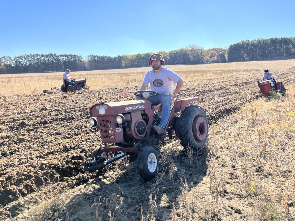

Pullstart 70,985 #72 Posted March 2 (edited) A photo memory on my phone came up from the 2021 Portage show. I was eyeing a 16 horse Speedex long before I realized it! Edited March 2 by Pullstart 2 Share this post Link to post Share on other sites

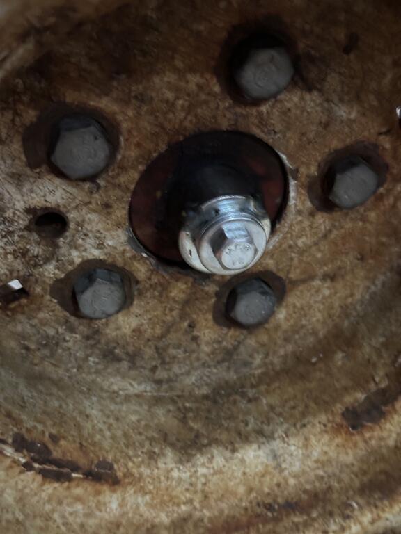

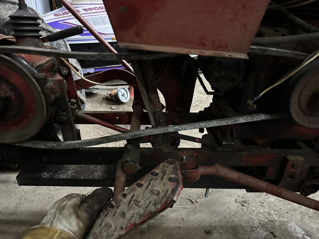

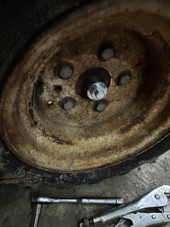

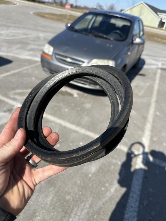

Pullstart 70,985 #73 Posted March 3 The drive belt on this is 5/8”x63”, or what’s left of it. The local farm stores didn’t have anything between 60” and 65”, so the jungle site will deliver me one tomorrow. I also cut some retainer cups today, and drilled and tapped the front axles to bolt the front hubs together. Previously, the front hubs were held on by cotter pins. 2 1 Share this post Link to post Share on other sites
Pullstart 70,985 #74 Posted March 4 My hub retainer cups: 1 Share this post Link to post Share on other sites

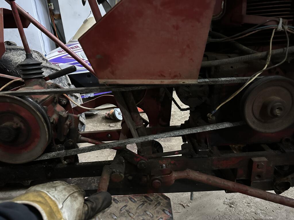

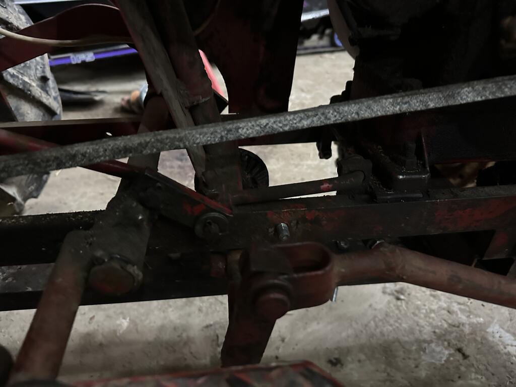

Pullstart 70,985 #75 Posted March 4 My belt came from the jungle today. The engine slides forward and backward on the frame for clutch action, and the clutch brake pad stops the transmission as well. I need to fire it up for test, but I believe it’s tensioned well. 1 Share this post Link to post Share on other sites
