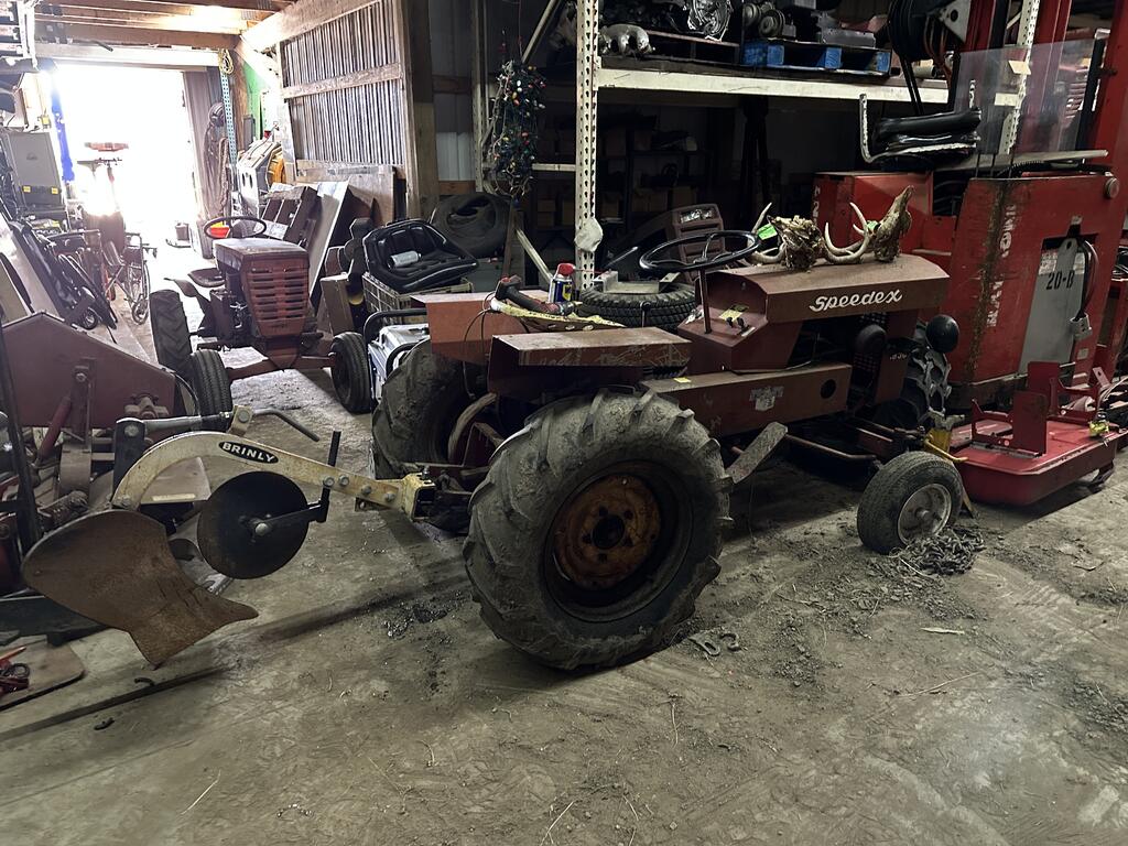

Pullstart 71,235 #38 Posted October 5, 2025 I might just have to bring Speedy to Uncle Jim’s plow day this year. @WHX?? @Achto what do you guys think? 1 Share this post Link to post Share on other sites
Achto 32,693 #39 Posted October 5, 2025 19 minutes ago, Pullstart said: I might just have to bring Speedy to Uncle Jim’s plow day this year. I think it would be a great idea ! 1 Share this post Link to post Share on other sites
SylvanLakeWH 32,504 #40 Posted October 6, 2025 Leave room for my 8" Brinley on the way home... 2 Share this post Link to post Share on other sites

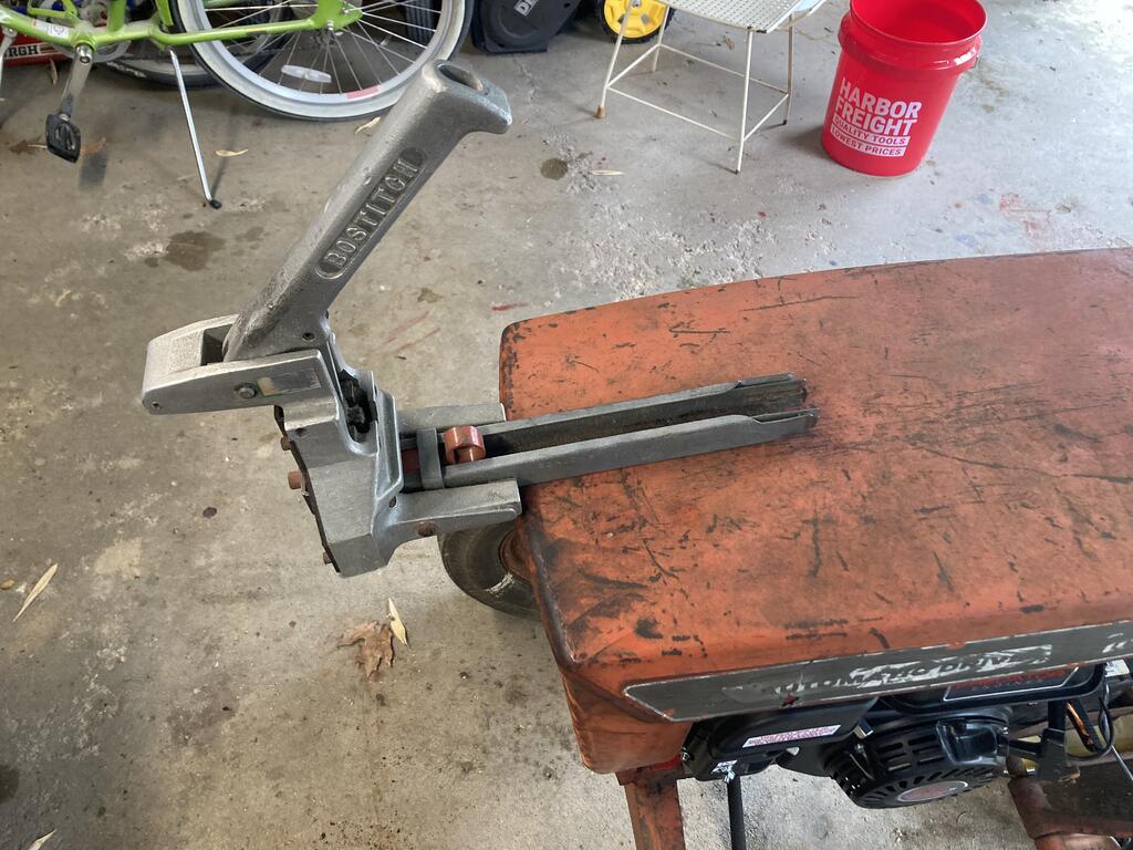

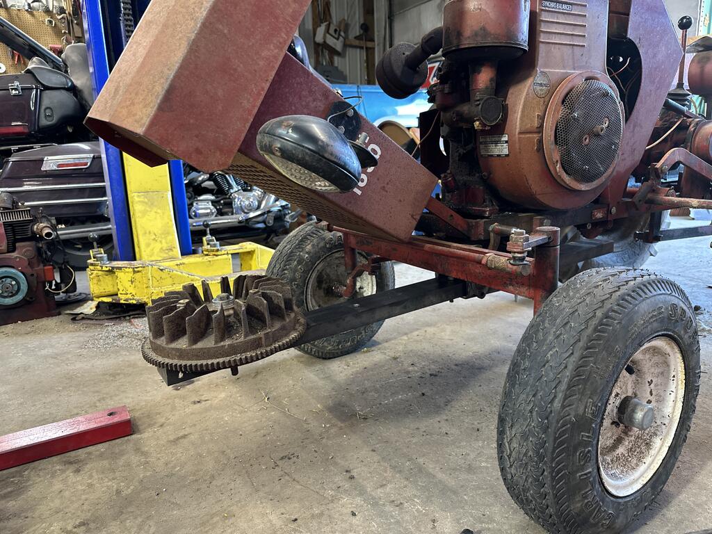

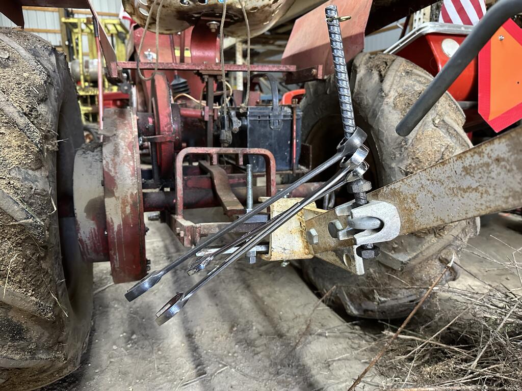

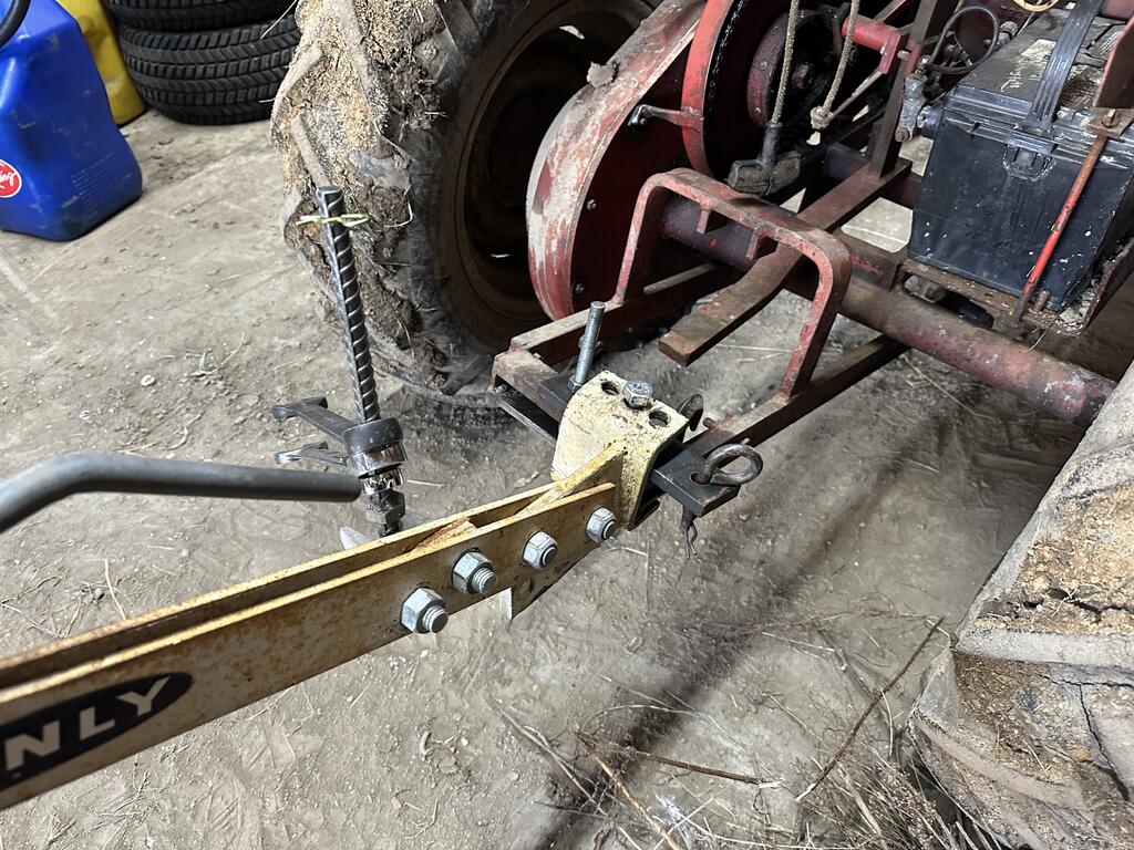

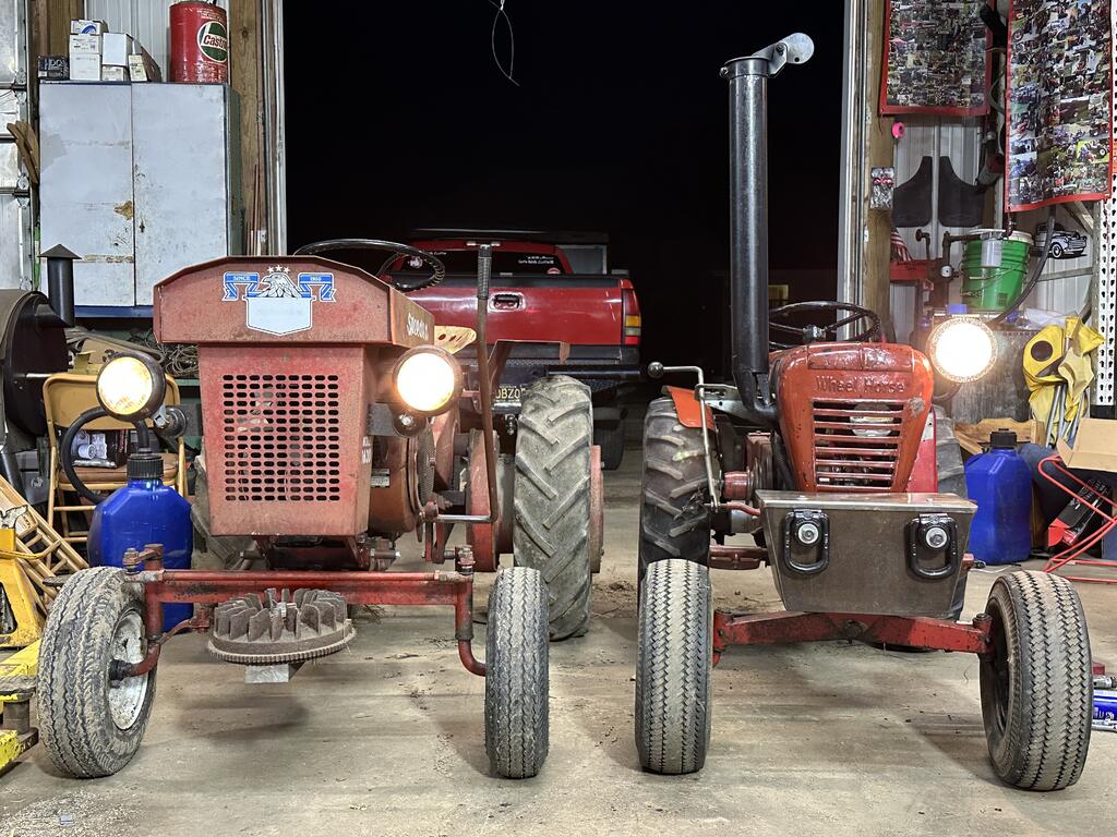

Pullstart 71,235 #41 Posted October 9, 2025 (edited) I finally dubbed this one “Speedy.” Speedy is getting some plow day upgrades! I did some test and tuning with a new 10” plow that I’ve never had in the ground, and it’ looking like it’ll work out pretty alright. I’ve removed the coulter wheel and added a tool rod with pin to hold some wrenches in place. I gave the drawbar a plate that has a pin to slide a trailer tongue over, a spot for a trailer to pin to, or the plow to attach. Next, I used some scrap metal and leftovers to build a sliding front hanging weight. It tucks in nearly to the front of the hood when not extended, and runs out a little ways when in use. The long bar is solid 1.25”x3” steel. It’s heavy on it’s own, let alone the flywheel bolted to the end. Edited October 9, 2025 by Pullstart 4 Share this post Link to post Share on other sites
Pullstart 71,235 #42 Posted October 12, 2025 I think I’m ready for plow day! 2 1 Share this post Link to post Share on other sites

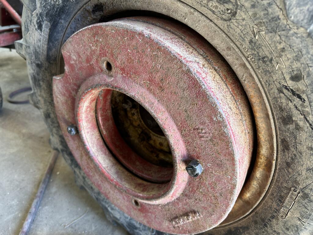

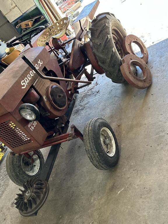

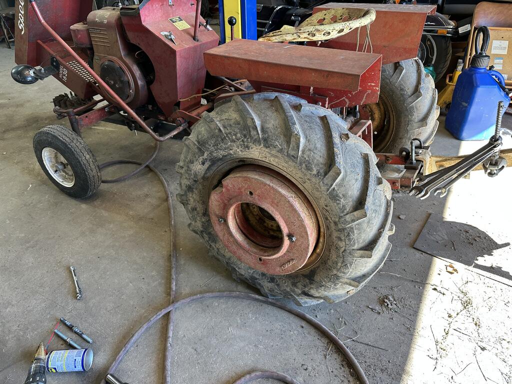

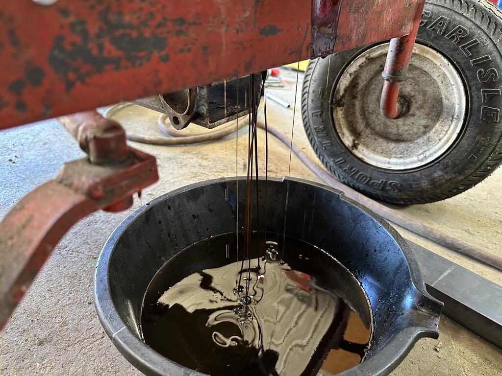

Pullstart 71,235 #43 Posted October 12, 2025 I picked up these wheel weights from @JoeM a few years back, and they have been collecting dust. They didn’t quite line up with the holes in the wheels, so I used a step bit to open the wheels up a smidge, used a 13/16” drill bit to open up the holes in the weights, and made up for the 1” difference with bolts at a little angle. Good enough! Oil change is complete and I’m ready to go. 4 1 Share this post Link to post Share on other sites
WHX?? 58,125 #45 Posted October 12, 2025 You probably won't need weights in this dirt but it looks cool... 1 Share this post Link to post Share on other sites

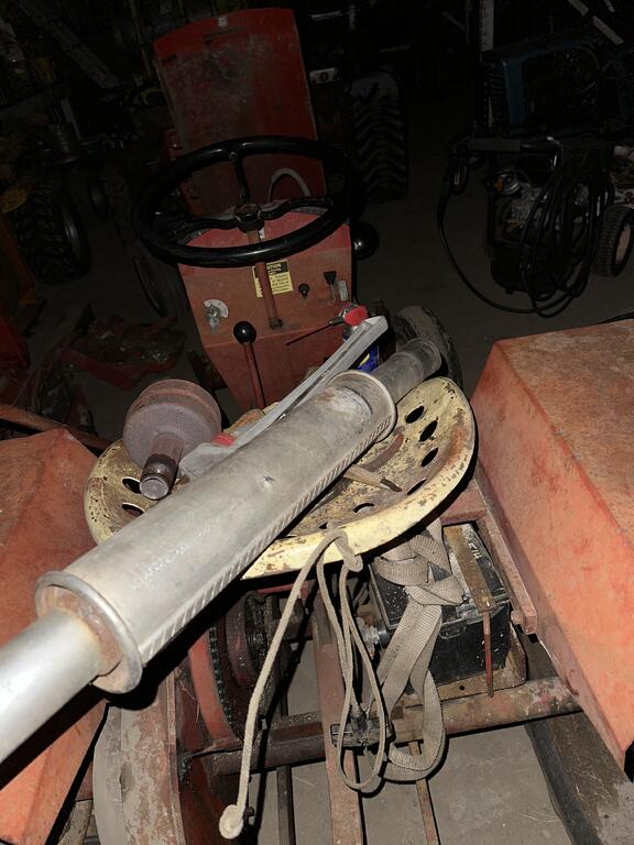

Pullstart 71,235 #46 Posted October 22, 2025 @wallfish would agree, pepper pot mufflers are a little bit too much bang, especially running a 16 horse one lunger all day. Share this post Link to post Share on other sites

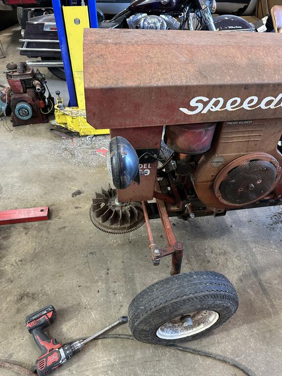

702854boy 1,149 #47 Posted October 22, 2025 (edited) On 10/12/2025 at 8:35 AM, Pullstart said: I saw that you posted in the Plow Day section that you were thinking about putting bigger front tire on the Speed X. Would flipping the spindles and steering stuff work to put a taller tire like a 6-12 on it? Edited October 22, 2025 by 702854boy 2 Share this post Link to post Share on other sites
Pullstart 71,235 #48 Posted October 22, 2025 20 minutes ago, 702854boy said: I saw that you posted in the Plow Day section that you were thinking about putting bigger front tire on the Speed X. Would flipping the spindles and steering stuff work to put a taller tire like a 6-12 on it? I think I see what you mean. The axle looks like it has no built in camber. Flip the axle, lose ground clearance, add tall tires, gain it back. Great idea!! In theory… Share this post Link to post Share on other sites
702854boy 1,149 #49 Posted October 22, 2025 Just now, Pullstart said: Great idea!! In theory… I guess the next step would be to eventually see if it works in practice 1 Share this post Link to post Share on other sites
Pullstart 71,235 #50 Posted October 22, 2025 2 hours ago, 702854boy said: I guess the next step would be to eventually see if it works in practice I checked it out briefly. It looks quite promising! Great idea! 1 Share this post Link to post Share on other sites
