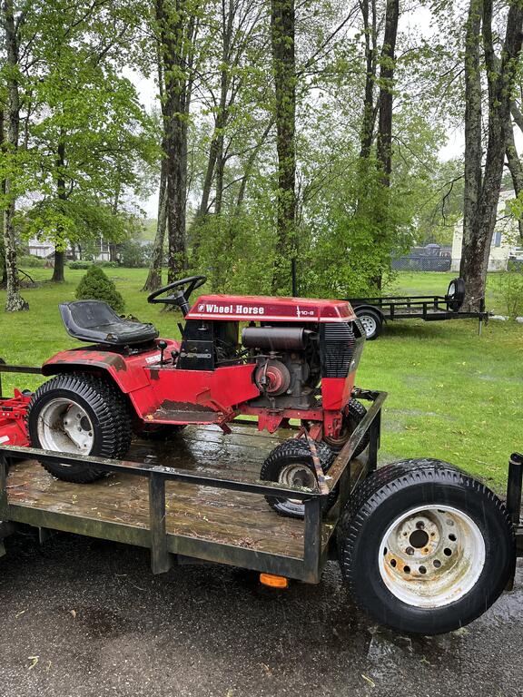

Hello Folks!
I just picked this 310 up with the hopes of getting it in good shape for my mother’s yard.
The model/serial number tag is not legible.
Any suggestions on how to identify the approximate model year?
Thanks in advance….

Nice rig!  That's a great model.  Based on the decal color it's 85-89 I think.  If it's a K series engine it's either an 85-86, if it's the Magnum Kohler it's 87-89 I believe.  Very capable model though that should be a great worker.

Post the engine spec number and it may identify the model year.

M10s engine.
spec. 461521
pfrederi
WH used same spec number engine for several years   1988-1991  If the serial number is readable on the engine might narrow it a bit.  Very little in changes during the 88-91period so not really an issue when you need parts.
