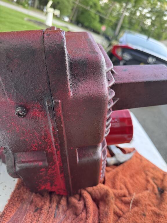

Jerzey76 1 #7 Posted May 13, 2025 First, I want to say thank you for your suggestions. I am a novice when it comes to this and flying by the seat of my pants. The leak was forming by the hitch pin and then underneath the box was leaking as well. I will show pictures when I get the chance. Thanks again Share this post Link to post Share on other sites

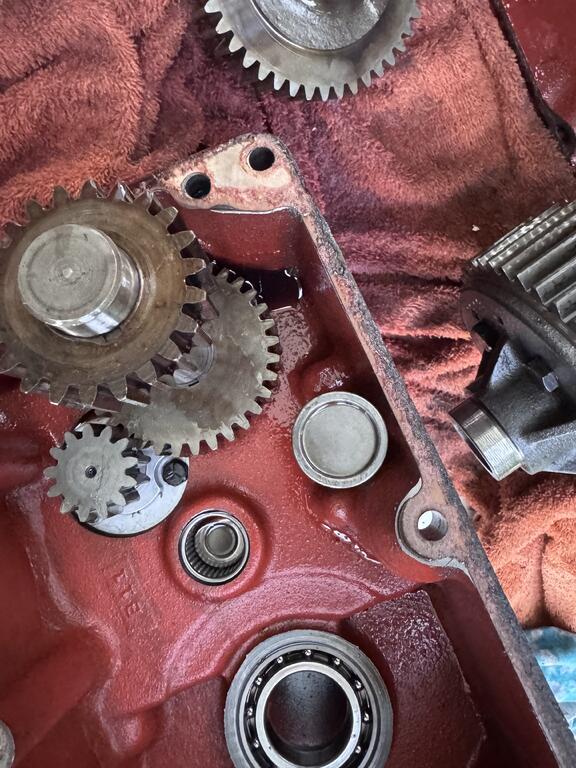

Jerzey76 1 #8 Posted May 18, 2025 I was able to get the housing apart. This is where it was leaking and it does look like the gasket failed. 1 Share this post Link to post Share on other sites
