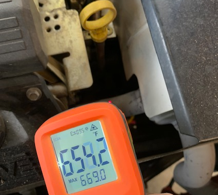

John2189 561 #1 Posted May 10, 2025 Is 325 degrees normal temperature at the exhaust pipe coming out of the head? Share this post Link to post Share on other sites
JoeM 9,390 #2 Posted May 10, 2025 (edited) the exhaust pipe coming out of the muffler, that is a good reading. The pipe coming out of the head, 600, 700 and ran hard close to 900. There should be a shroud over the muffler that directs air over the muffler and out the front to remove the heat. I have seen people remove that shroud thinking it is a guard for your hand and unnecessary, but it's main function is to remove the heat from the muffler. Edited May 10, 2025 by JoeM 1 Share this post Link to post Share on other sites
John2189 561 #3 Posted May 11, 2025 Ok thanks the temperature is oh Share this post Link to post Share on other sites
