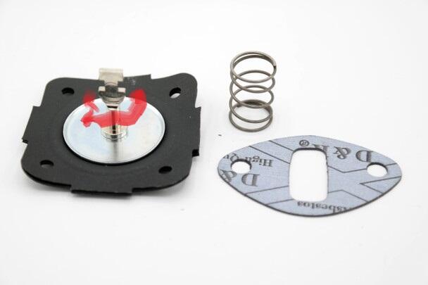

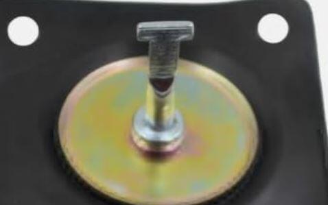

Lagersolut 781 #1 Posted May 10, 2025 Yesterday I rebuilt the fuel pump on the 416 K341 - wondering if anyone else has run into this . Seems there are 2 style stems for the diaphragm but I'm not finding different part numbers - straight stem T or one with shoulders - took me on off and apart a few times not pumping until I figured it out ....comparing new to what came out - the kit with shoulders works fine - after gently grinding and filing the shoulders off . Just wondering , seems the sellers are offering one kit or the other don't know what style you have until the pumps apart . 3 Share this post Link to post Share on other sites
ri702bill 10,962 #2 Posted May 10, 2025 Yes, there are 2 different styles. Look at the ThenandNowAuto website - it explains both. Bonus - if you order from them as I did, they verify with you first as to which style you have, They also include the check valves and springs. Be SURE to fine sand the cover for flatness (like you do with an aluminum cylinder head) prior to reassembly.... 3 3 Share this post Link to post Share on other sites
Achto 30,440 #3 Posted May 10, 2025 9 hours ago, Lagersolut said: offering one kit or the other don't know what style you have until the pumps apart Unfortunately taking the pump apart is the only way that you know for sure which one you have. 4 Share this post Link to post Share on other sites
953 nut 63,547 #4 Posted May 10, 2025 10 hours ago, Lagersolut said: I rebuilt the fuel pump You didn't rebuild the pump if what is pictured is what was used, just replaced the diaphragm. The two check valves should be replaced also. Old check valves will fail and the new diaphragm will just slosh gas around. There are five fuel pump rebuild kits offered by Then and Now https://www.then-now-auto.com/product-category/fuel-pump-kits/kohler-fuel-pump-kits/ 1 Share this post Link to post Share on other sites
Lagersolut 781 #5 Posted May 11, 2025 1 hour ago, 953 nut said: You didn't rebuild the pump if what is pictured is what was used, just replaced the diaphragm. The two check valves should be replaced also. Old check valves will fail and the new diaphragm will just slosh gas around. There are five fuel pump rebuild kits offered by Then and Now https://www.then-now-auto.com/product-category/fuel-pump-kits/kohler-fuel-pump-kits/ Thanks - the 416 is my main worker didn’t want it down for a week or two waiting for parts so I took a chance - probably do it again to cover my bases or at least have this kit in my smalls box . 1 Share this post Link to post Share on other sites
