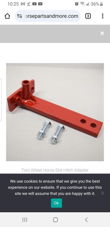

gt14rider 1,045 #1 Posted May 6, 2025 Hi everyone, I have a question about a sleeve hitch, I have a picture of an brinly hitch adapter. Would like to know if this adapter and a sleeve hitch will support the weight of a york rake . It weighs 180 pounds. The hitch is on a 856. Thanks Share this post Link to post Share on other sites
1968Commando 171 #2 Posted May 6, 2025 It would work but it’s gona be pretty light in the front end I would think 1 Share this post Link to post Share on other sites
Achto 30,861 #3 Posted May 6, 2025 Chiming in to hear others opinions. I would believe it would do just fine providing that the rake is as close to the tractor as possible. The farther behind the tractor, the more stress there will be on the hitch. 1 1 Share this post Link to post Share on other sites
ebinmaine 77,082 #4 Posted May 6, 2025 35 minutes ago, Achto said: Chiming in to hear others opinions. Same 36 minutes ago, 1968Commando said: It would work but it’s gona be pretty light in the front end I would think Might need a front weight. 35 minutes ago, Achto said: providing that the rake is as close to the tractor as possible Excellent point 1 Share this post Link to post Share on other sites

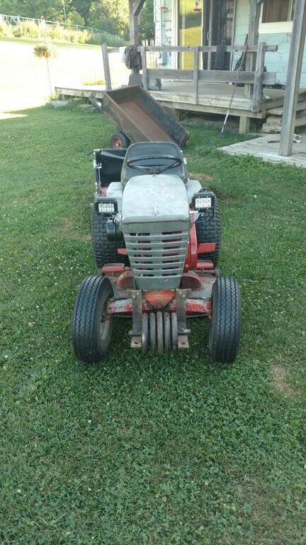

gt14rider 1,045 #5 Posted May 6, 2025 Got that covered . 1 1 Share this post Link to post Share on other sites
Wayne0 1,476 #7 Posted May 6, 2025 (edited) 1 hour ago, ebinmaine said: Might need a front weight. Like a chipper? Edited May 6, 2025 by Wayne0 2 Share this post Link to post Share on other sites
ebinmaine 77,082 #8 Posted May 6, 2025 Just now, Wayne0 said: Like a chipper? Dude......... That's a LOT of front weight. 1 Share this post Link to post Share on other sites
gt14rider 1,045 #9 Posted May 6, 2025 That tractors name is Christen. She tried to hert me , did a wheelie up a hill and rolled over on me, 3weeks in the hospital. Week later tried to buck the mrs, did a wheelie though the garden, mowed a row green beans. So I added some weight, can add or remove the weights 2 Share this post Link to post Share on other sites
gt14rider 1,045 #10 Posted May 6, 2025 Thanks for the reply, have to check the scrap pile, make a short bar adapter and check the cable is good. Cleaning up the york rake and I think Christen will have a new job. 1 Share this post Link to post Share on other sites
